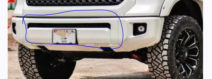

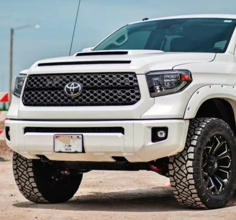

    1st timer post, happy to be a part of the Tundra community! (2014 White Tundra 1794) I want to mimic this front end look of this picture (from grill to bumper) yet I can't seem to locate the parts. Greatly appreciate the help!

    1)TRD Pro Hood. 2)2018-2021 honeycomb grill 3)TRD Pro LED headlamps 4)TRD Pro white bumper 5)Toyota OEM "bushwacker" style pocket fender flares.. That is going to be a very expensive conversion. Good luck.

    I was able to purchase the parts from others peoples take offs
    Doing the installs your self helps.
    1- $500 for led head lights and fog lights
    2-$350 for TRD grill
    3- $325 for full TRD Pro bumper complete assembly.
    Took awhile to get them all but they to show up for sale now and then and it’s a bonus when it’s within your area.

    I greatly appreciate all the help. :bowdown: Definitely expensive but I plan to do all the work to save some $. Here is what I'm finding:
    1. Honeycomb grill looks to be the Platinum version not the TRD - see here - being that I own a 2014 - I'm reading (thread) that I will likely have to change the emblem as well?
    2. Hood bulge - see here
    3. I'm having trouble finding full bumper assembly, still need some help here.
    I don't plan on doing the hood, flares or lights, but could be talked into new fog lights if there are any recommendations.

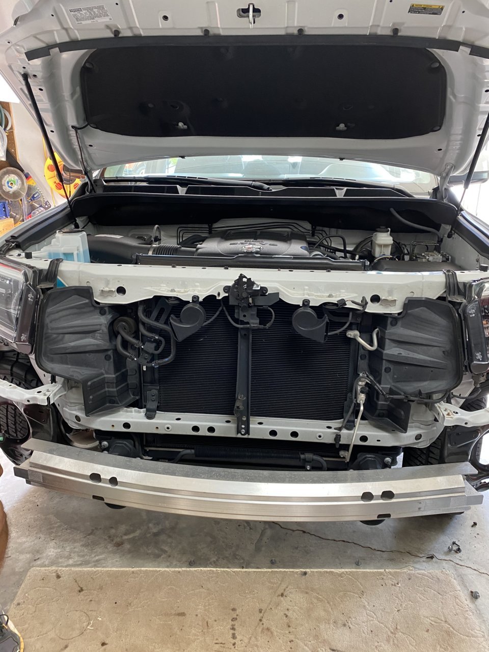

    After:
    F6FB28C4-7896-4D67-996C-52E8262E5605.jpg 3CD4EF0C-05A7-4F64-A4BD-FBF431C8C2EF.jpg

    I did not have to change out the emblem...my end caps are color matched and just install over the chrome ends. Again, the only trouble you will have is that color matched center valance. I will definitely keep an eye out for you my friend and welcome!
