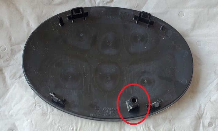

    Toyota is changing how the front emblem mounts to all 2018+ Tundra grilles. The grilles and emblems are changing. If you need a new grille because you nicked yours up a bit, and you have the old style grille/emblem, you'll have to replace the emblem as well which is about $287 at the time of this write up. The best way to find out which type you have is to pull the grille on your truck and find out. I have looked up the parts using VINs and my parts system still gets it wrong, so pull the grille and find out to be safe. In the following image are the two different front emblems. The newer one is on top, and the older one is on the bottom. Notice in the 5 o'clock position on the new emblem is a bolt hole, while at the 3 and 9 o'clock on the old style are two round pegs. This is the main difference of how the emblem is secured to the grille. The new style is bolted in, where the old style has speed nut style washers on the pegs.
    If you are wanting to replace your grille with a Platinum or TRD Sport grille, and you have the old style emblem at the bottom, you will need a new emblem. Toyota is almost out of the old style grilles, and once they're gone, that's it. The grille and emblem will supercede to the new one, and you will have to replace both parts. Some 2018+ models already have the new style emblem, but again, the VIN information may be wrong and you need to look to see which one you have.
    The Land Cruiser emblem we have been using for 2014-17 Tundra owners will not work on the new style grille any longer with the new changes. To my knowledge, there is no other emblem that will fit this grille.

    Can anyone identify which bolt/screw is required for the back of the new-style emblem and where to get? Happy to just run to Lowes if you have the thread and length needed.
    I'm in the processes of replacing my 2020 grille thanks to a turkey and ended up finding out that I have the old style emblem that doesn't fit the new grille that I now have.
    I've got the new emblem on order, but couldn't ID the bolt needed.
