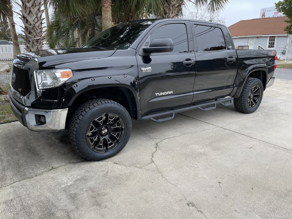

    Does anyone know where I can find a set of aluminum hub centric rings for the 20inch KMC XD Boneyard wheels to fit a 2017 Tundra… I can’t find any that will work anywhere.
    Wheels are in picture

    Are those wheels what you are looking to purchase? I would get the correct fitment before using hubcentric rings.

    no that’s for my current wheels … I was going to try the rings and see if it improved ride quality before buying new wheels but I can’t find any for these which is maybe why I never got any

    Just a guess but if there is room to install rings, then it sounds like those are the wrong wheels to begin with. Do you have anything that says what the bore size is?

    well these are lug centric wheels not hub centric from what I’ve read… it seems the Bore size is 128mm which would make since if it’s going on 110MM I suppose but have also seen some that said in 70s which couldn’t work on my truck anyway .. I’ve been unable to find a ring that would work with 110mm and 128mm… they are XD Boneyard 20 inch wheels
