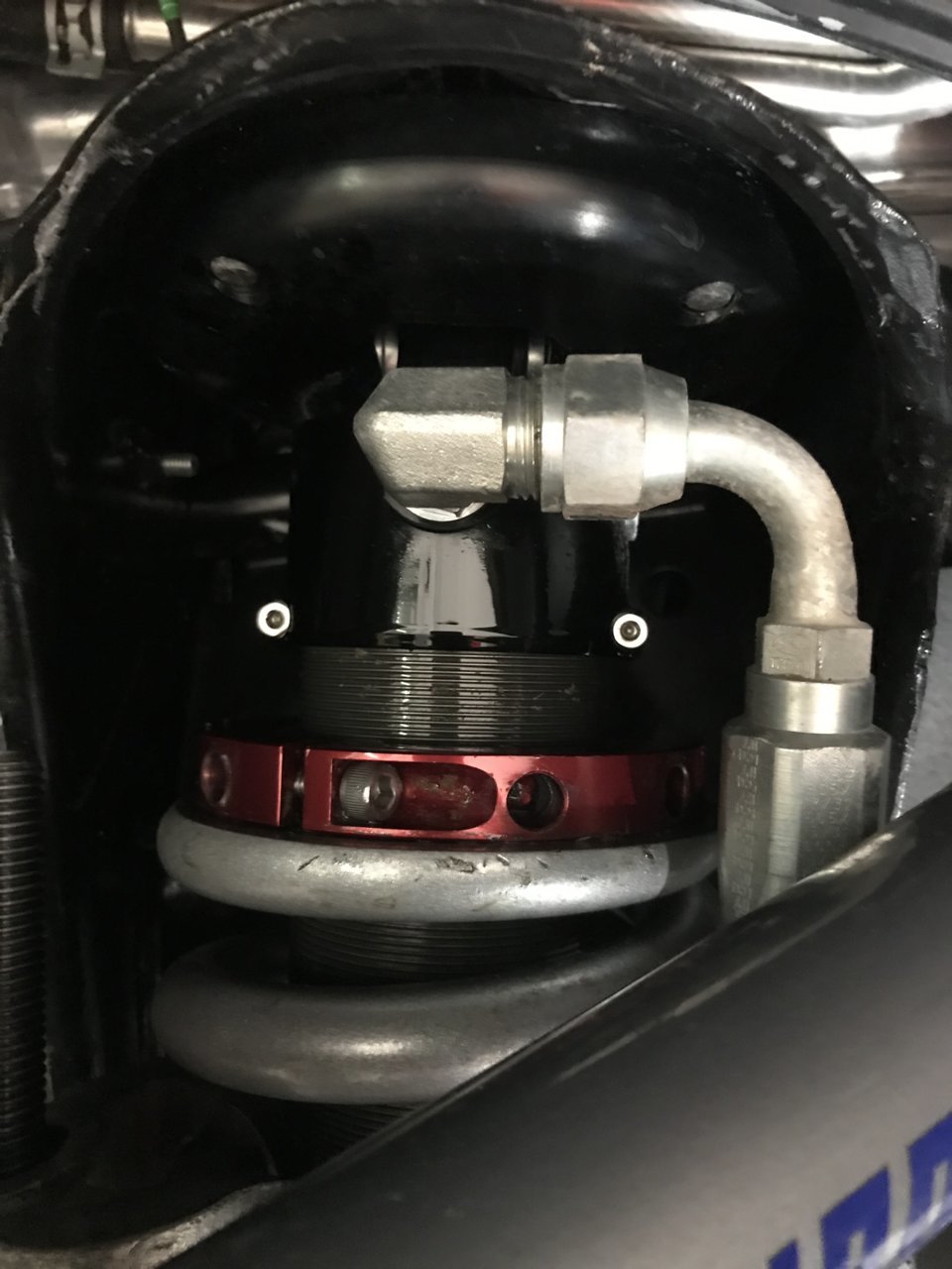

    I have new Elka Coilovers trying to adjust the ride height, loosened the Allen screw on the top no set screw. And wow it is tight made one turn but it’s tight don’t want to wobble out the holes for the punch to go in. Any advice? upload_2019-1-19_21-45-12.jpg

    I’m assuming the wheels are off the ground right?

    Do you have the proper tool or just a punch?
    They should be rather easy to adjust.

    I only have the punch that was sent with the suspension. Don’t have the wrench didn’t think they would be hard to move. Maybe I just need to order the wrench?

    If it’s the tool sent with the shocks, it should be fine.
    This shouldn’t be very diffucult. Maybe spray some WD-40 on the threads.
    I even went to Elka’s website to check if there was something I misssd.
    http://www.elkaservicecenter.com/preload.html

    Your photo shows mud is there any on the threads? Maybe hose them down first.

    Wiped it down pretty well sprayed with Wd-40 I’ll try and hose it off tomorrow just don’t think it’s the dirt doesn’t feel right super hard to move. Thanks for all the input I really appreciate it!

    Your compressing alot of force it's going to be hard, the proper spanner wrench would make things soo much easier and wouldn't gawl the holes.

    I moved it a little yesterday a inch or 2 noticed the collar where it splits is scratching the spring pulling up the metal. Going to call toytec see if they have a idea of what to do

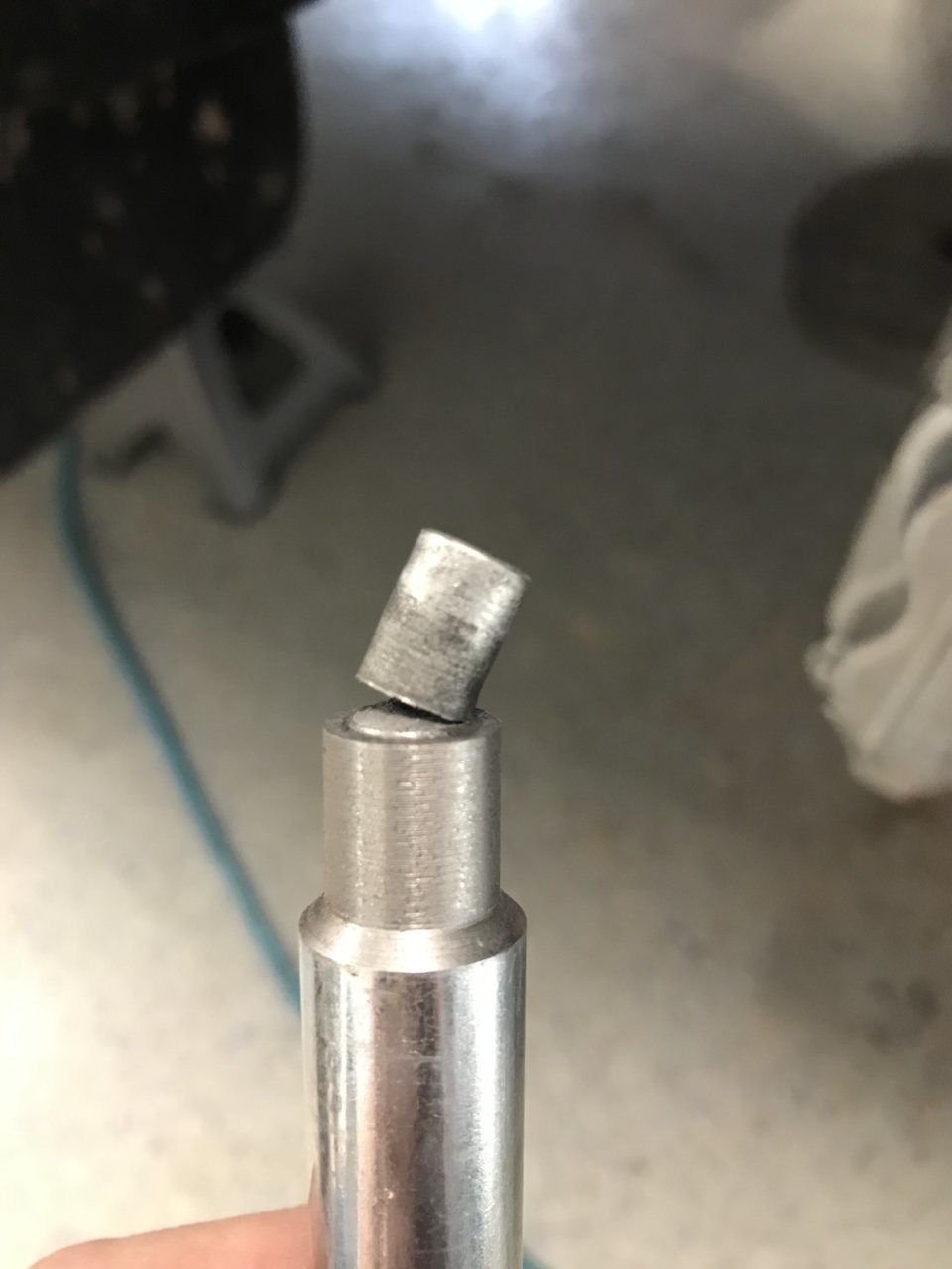

    So this has has been such a pain in the ass!!! The suspension front and back was fairly easy project to install. If I had known how hard it would be to adjust these shocks would have never bought them. Broke the tool trying to adjust them. someone tell me kings, icon, Fox aren’t this hard to adjust!! A803E9F0-3391-4B42-9FE7-36B67577AE87.jpgA51D50B7-2BC2-487E-A5F7-42988938BAD7.jpg

  15. Jan 23, 2019 at 6:04 PM
    csuviper
    Jan 6, 2014
    #38
    15,727
    Brian
    Broomfield, CO
    2019 TRD Sport CM 5.7L 4X4
    Dang man, shouldn’t be that hard to adjust.

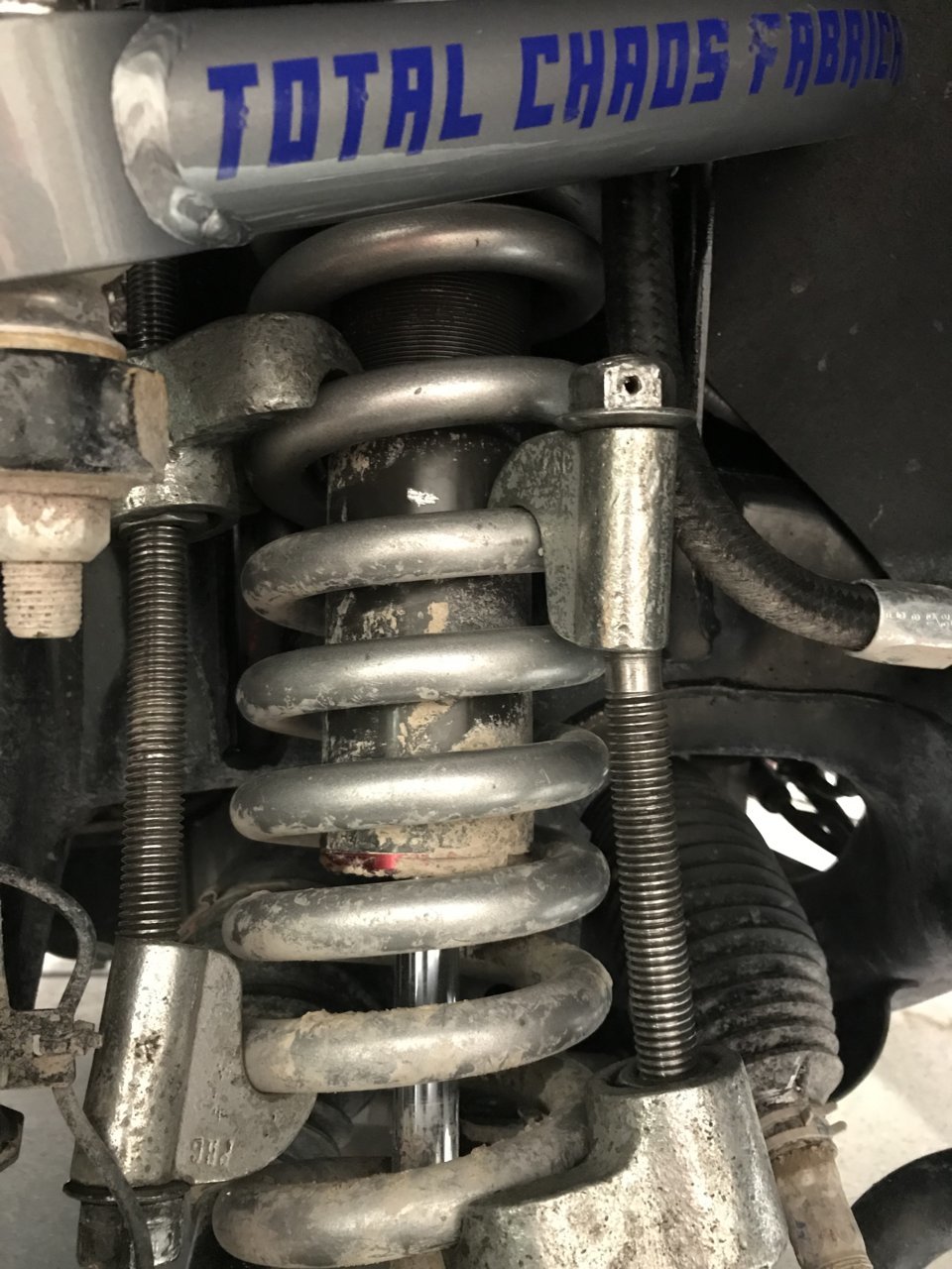

    Yikes, stop. You have the right idea with the coil compressors, but in case you didn’t, install them with the full weight of the truck on them(tires on the ground), crank them down a little, then jack it up so the wheel is off the ground. Fox and King require removal to adjust, but I have no problem adjusting both this way.

    So do u need to remove the shock completely to adjust them?

    Did you install the coil spring compressors with the truck on the ground?

    I used a jack under the bottom control arm jacked it up to put some compression on the spring then installed the spring compressors

    Good luck fitting that into the shock tower on the vehicle. He has the proper tool. I have never needed anything more than the tool that broke.

    So did you use a spring compressor? Before I bought the shocks watched the you tube video that icon put out. Looked super simple so I was like yeah I can do that . Nervous as hell using those spring compressors!

    Put it on with the full weight on the ground and crank them, jack truck up. I would bet that I’m the only person in this thread that has adjusted single collar Tundra coilovers on the truck... It will still be difficult, and you may need to make a few different bites to get where you want. Spanner wrench is useless our trucks. This is what I made to adjust.:thumbsup:

    So this is a total shit show.
    You probably galled up the coil adjustment nut bad with how dirty your shock is. Hopefully you just messed up the coil adjustment nut, and not the shock cylinder.
    This is what I would do:
    Pull shock, and I mean just that. It sucks, I know. If you try this shit on the truck, damage to the shock or your fingers are likely.
    - Clean the shock off properly. You can’t have dirt in all the threads if you expect any kind of adjustment. From the looks of how dirty the shock is, find a nut and bolt. Lube up the bolt with anti-seize, put bolt in the dirt and sand, then try and install the nut. Wouldn’t work out well now would it?
    - pull out the coil adjustment pinch bolt all together.
    - place shock in bench vice, clamp the top cap. Use a rag to minimize scratches.
    - With a new coil adjustment nut tool or spaner wrench so you can put time torque on it. Now before attempting to loosen the nut, try and spread the CAN a little, and I mean a little bit. Then shoot some Kroil or some kind of lube all over the top of the CAN. Try and back off the CAN. It will be difficult since there’s sand and dirt inside the threads. Keep spraying lube.
    Watch the top cap and shock cylinder to make sure your not unscrewing the top cap. You are under N2 pressure.
    If the top cap does start to unthread, just stop. Send the shock back for a service. They might be able to save the shock with a new CAN, a shock N2 charge, and shipping.
    If you lived closer, I would have you order a new CAN, pull shock, buy some buffalo trace bourbon, and save our souls together in my garage.
