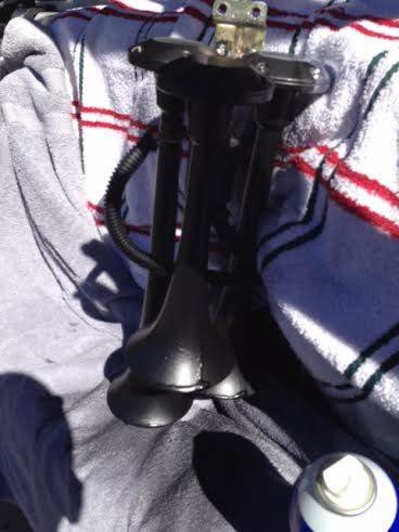

    Checked all fuses this morning then took it to Stevinson. The wife wants it fixed now because we r going on a road trip on Thursday. So far they have only said I need an ac condenser and the train horn caused that problem? Interesting. Still waiting on more info.

    The train horn? How big is it? WOOOOOOOoooooOOOOOOooooOOOOOOooooooOOOOOOoooOOOOOO

    2012 Tundra 5.7
    Sean installed it when he owned the truck. Seems like a crazy thought that it could cause an issue with the ac condenser.

    How is that possible? Which Stevinson did you bring it to? How does an A/C condenser cause the symptoms you described?

    Did the horn rub a hole in the condenser from where it is located and bouncing around?
    I can see maybe a leak and problem with AC because of that but not all of the lights.

    Sean your old deleted build thread didn't have a pic of the location of the horns. Assume they were behind the grill.

    It sounds like there are 2 separate issues. Yes the horn rubbed a hole in the condenser. The say there is some wiring issues by the driver side fuse box. Only 6 of the 18 points of contact are working in the ecu. Stevinson east. They want to redo all the wiring. They r not sure if it's from the horn. Sean Is there some wiring from the hypertech?

    I took the tundra to Jace aka @LOTSOFTOYS and he was great. Amazing service and he helped figure out the issues with the tundra. First issue was that the train horn rubbed a hole in the ac condenser. He will install s new condenser. I will relocate the horns to either inside the bumper or possibly somewhere under the hood. Second the speedo healer from HYpertech had 2 broken wires which caused the speedometer to not work which brought down half the network. Glad I can sleep tonight.

    Bring the horns to the bumper, or if u can run more wire- under the truck, tucked up.
