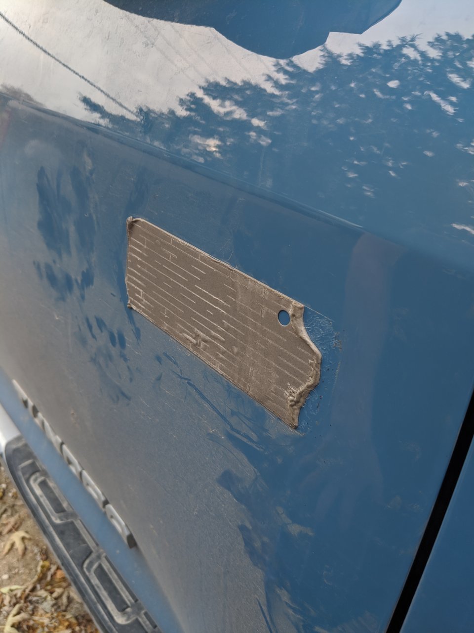

    FYI ...here's what's under those badges. Doesn't look good for the paint to me.

    That's the hardest part of the job. I just used the hair dryer and my fingers, heating and slowly moving the adhesive back from one side to the other. This is tedious and requires slow careful progress or you may mark the paint. After you get the main thick adhesive off there will still be residue left, that's where I used the Rapid Remover to complete the job.
    I have a black truck and that will show any and all imperfections, I can say with this process of removal it can be accomplished. There is no indication of my black truck ever having badges or decals, and it looks great.

    No biggie. You can usually scrape that stuff off pretty easy with a good flathead screw driver.

    By the way i am completely kidding. I would never touch a screwdriver on my paint.
    The easiest way to remove emblems is a hairdryer and fishing line to "saw" through the adhesive.
    Plastic trim pry tools can be used to scrape the remaining adhesive off with heat and Goo Gone.
    A plastic drywall repair putty knife is also a better option than a screwdriver.
