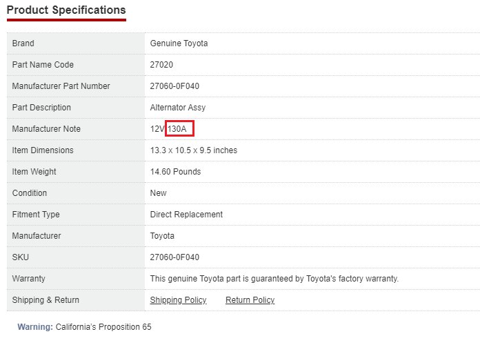

    Yeah that 210-1065 reman is what I have being shipped to Napa by Friday hopefully.
    Shoutout to @shifty` for the suggestion to ask them.
    I believe right around $310 including whatever core deposit/refund will be.
    Would've been cool to learn to rebuild mine for way less but didn't want to chance it with the quality/source uncertainty - so just learning to replace whole thing this weekend!
    Ya'll think this 130 could power an amp for three 10" subs in the future?
    Or is that a whole other discussion :D

    Save the old, rebuild it. Now you have a backup.
    Meanwhile, one 10 is plenty for the cabs of these trucks.

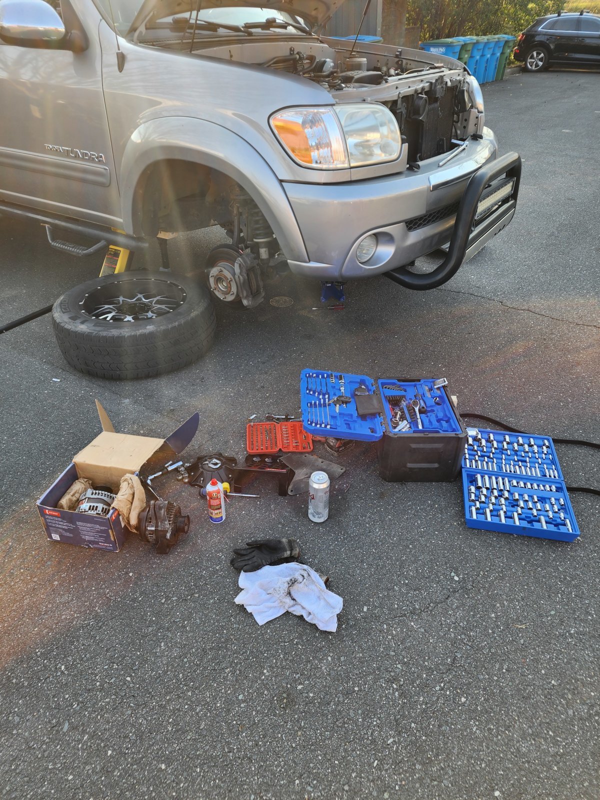

    Well it was a successful 4 hour learning experience!
    Alt swap is done with the help of YouTube University & I was nervous about the belt but was pretty easy thanks to the thread & diagram that @shifty` referred me too so thanks for that!
    I'm in the middle of the new alt break in process & to my dismay I'm still seeing the voltage guage fluctuate a little bit, though not as severe as before.
    But, before my battery & alternator took a shit my volt guage always stayed dead nuts right below center :confused::mad:

    Mine fluctuates also. I posted a picture/vid of it on here somewhere. I don't remmber that happening before my 1st alternator burned up, but maybe I'm nuts.
    Basically, my factory 130A caught fire in the low-mid 60k miles, within day/sweeks of me buying the truck. I had to travel for work the next day and didn't have time to deal with it so I dropped it off at a shop I trust and had them do it, told them to only use Denso parts, which they did, but they installed a 100A and it fluctuated pretty significantly after, which led to me chasing some random stuff down.
    It got significantly better when I went back to 130A. Still fluctuates periodically.
    I will tell you though, corrosion in the terminals will lend to that stuff also. https://www.tundras.com/threads/1st-gen-psa-clean-your-battery-terminals-you-lazy-sods.131635/
    I wouldn't be surprised if corrosion inside my cables helped lend to that alternator failure.
