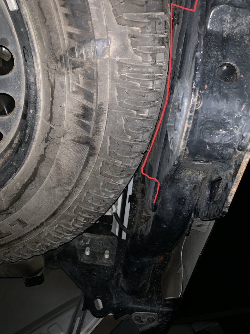

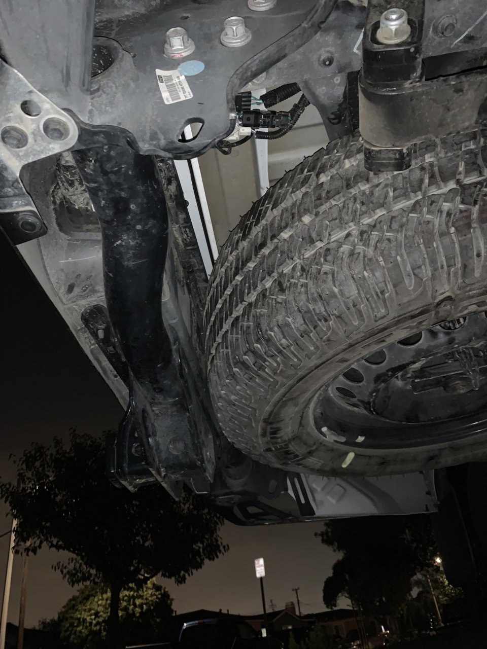

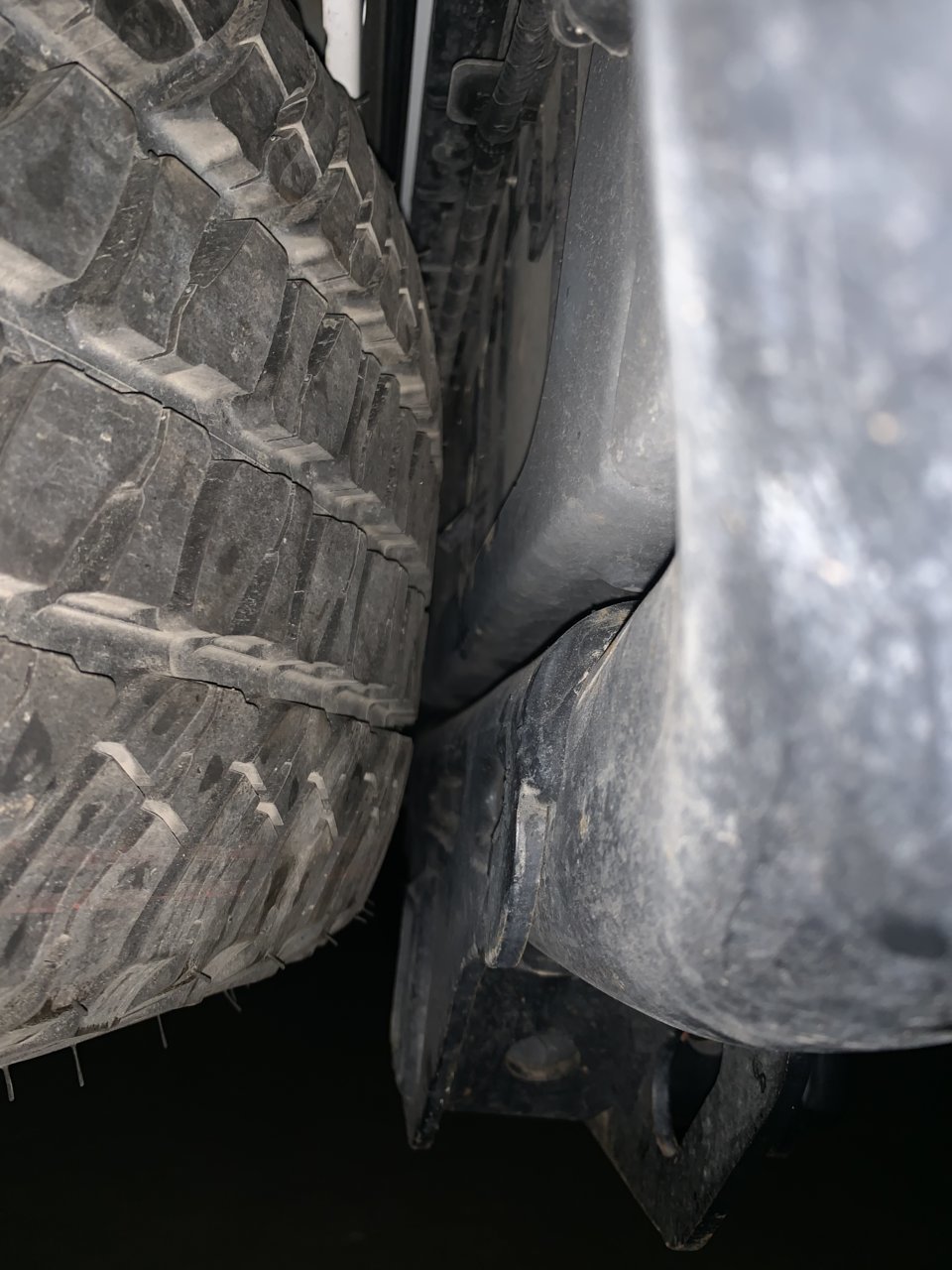

    I’ve got a little fab shop down the street from my house. I’m thinking I could have him fab me up something simple.
    Maybe a shim right behind the trailer hitch to keep it pushed forward maybe about an inch and a half. Maybe even some flat stock bent in a bit of a M shape to keep it centered.

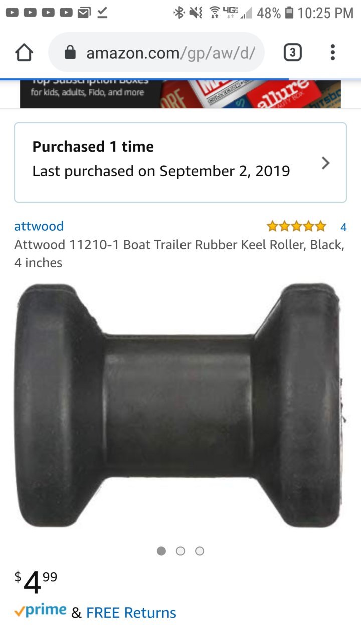

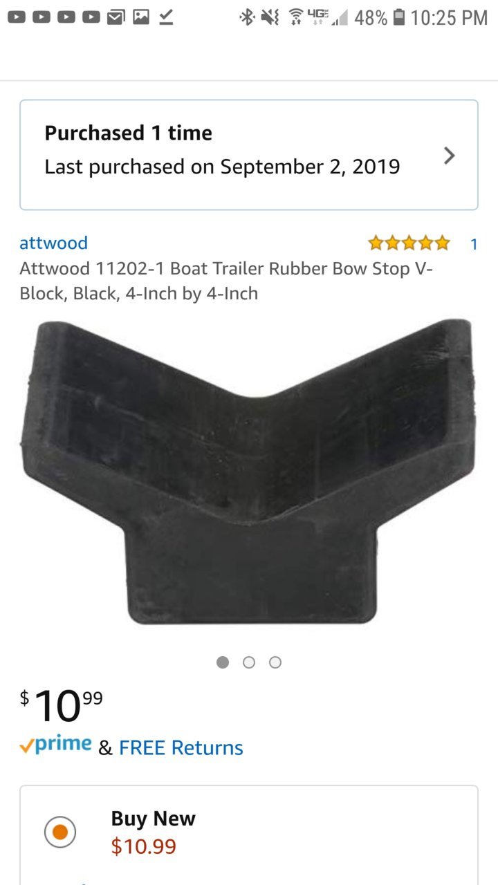

    So at least I'm not the only one so this is common I'm looking right now at some 2 to 4 inch rubber spacers to push the tire forward
    15whtrd[QUOTED] likes this.
  17. Sep 2, 2019 at 10:24 PM
    #47
    Rica25
    Rica25 [OP] Got Bam? IG ......@TNDRA08
    Dec 6, 2017
    #11380
    5,554
    Ricardo
    Tulare
    Just ordered 2 different styles and see if it works

    See if the push it far enough

    So what are you thinking, just wedge it in there as you tighten it up to keep it forward? Interested to see your results. I like a simple fix.

    Planning on drilling a hole on the center of the V shaped on and test or the other one already has a hole has make a hole somewhere on the back part of the frame and bolt it to it......or maybe even some liquid nails see if it sticks

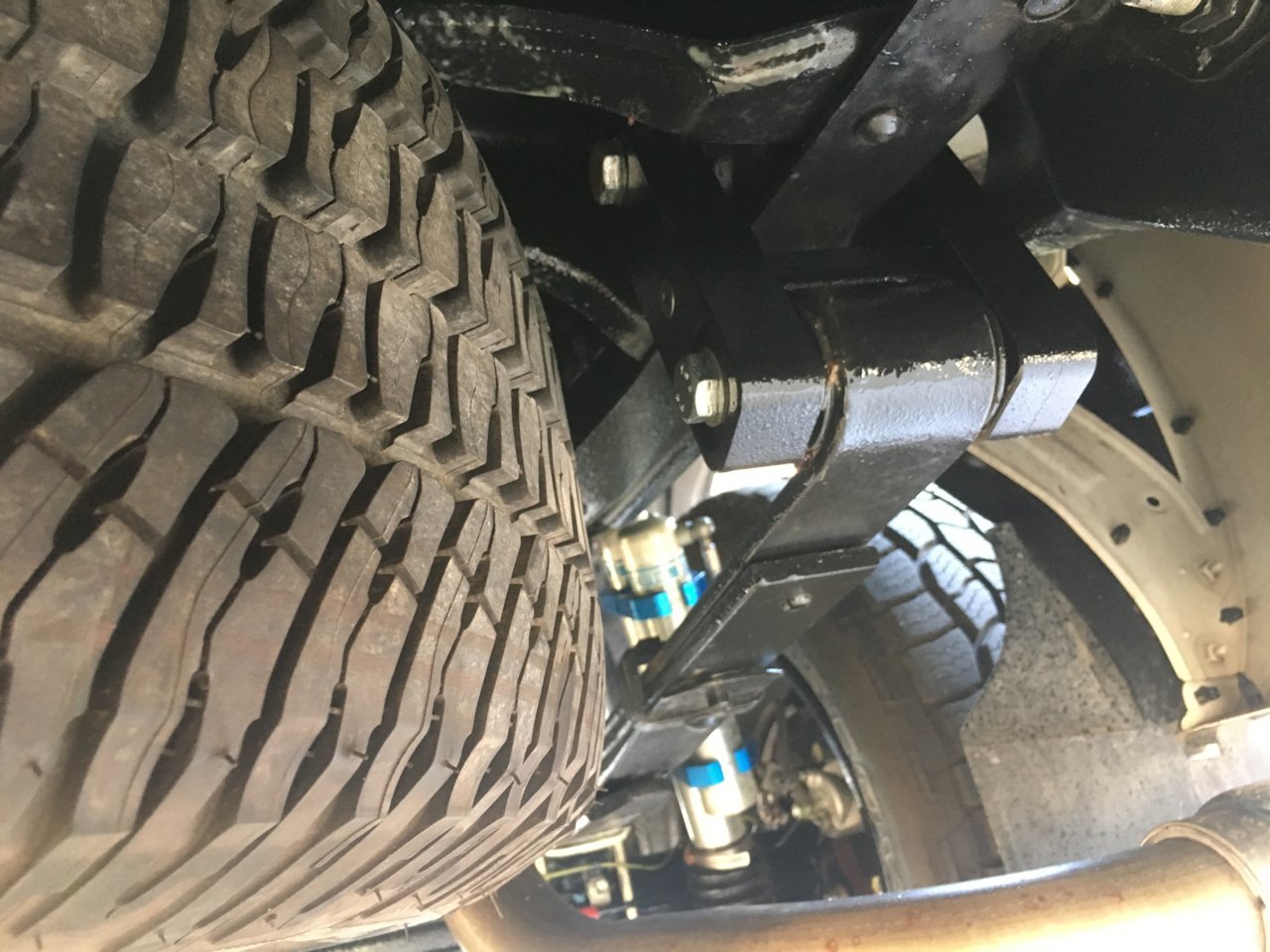

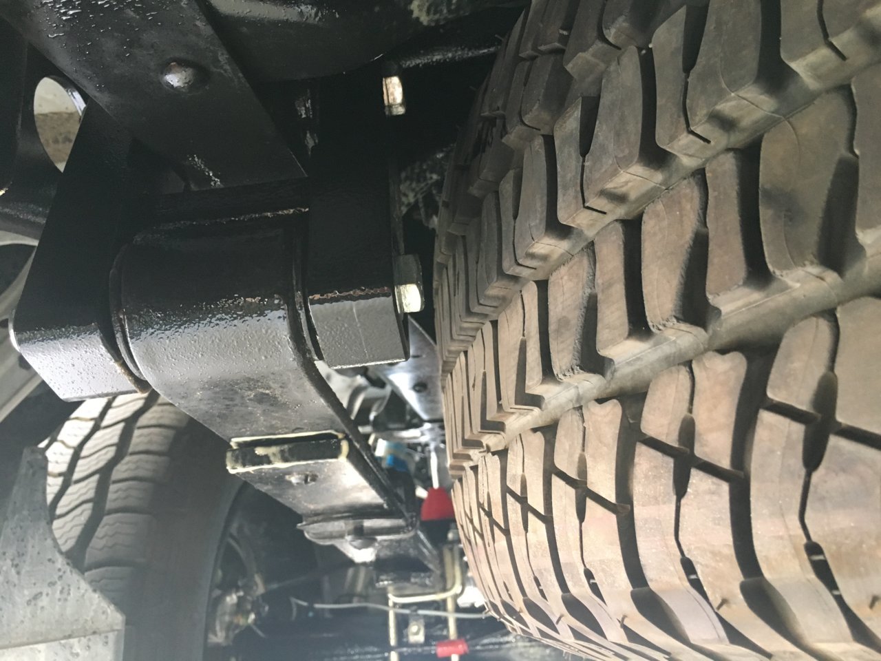

    So I did the fluid film undercoating this afternoon. I plan on going from az to va soon so dry to rust. I put my stock 18” spare back up, I have +1 coach builder shackles. Here’s what I 3D7B3FFA-5536-45D7-907B-06679E555C56.jpg 73B40D9A-20C9-4E2C-A7E3-888F5AF23265.jpg
