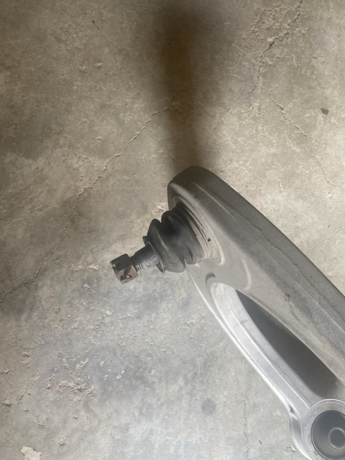

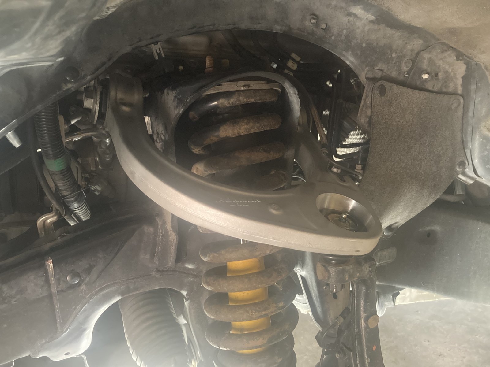

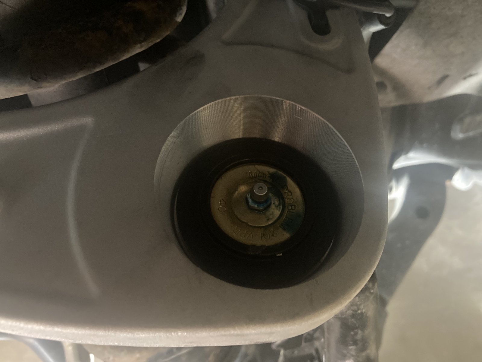

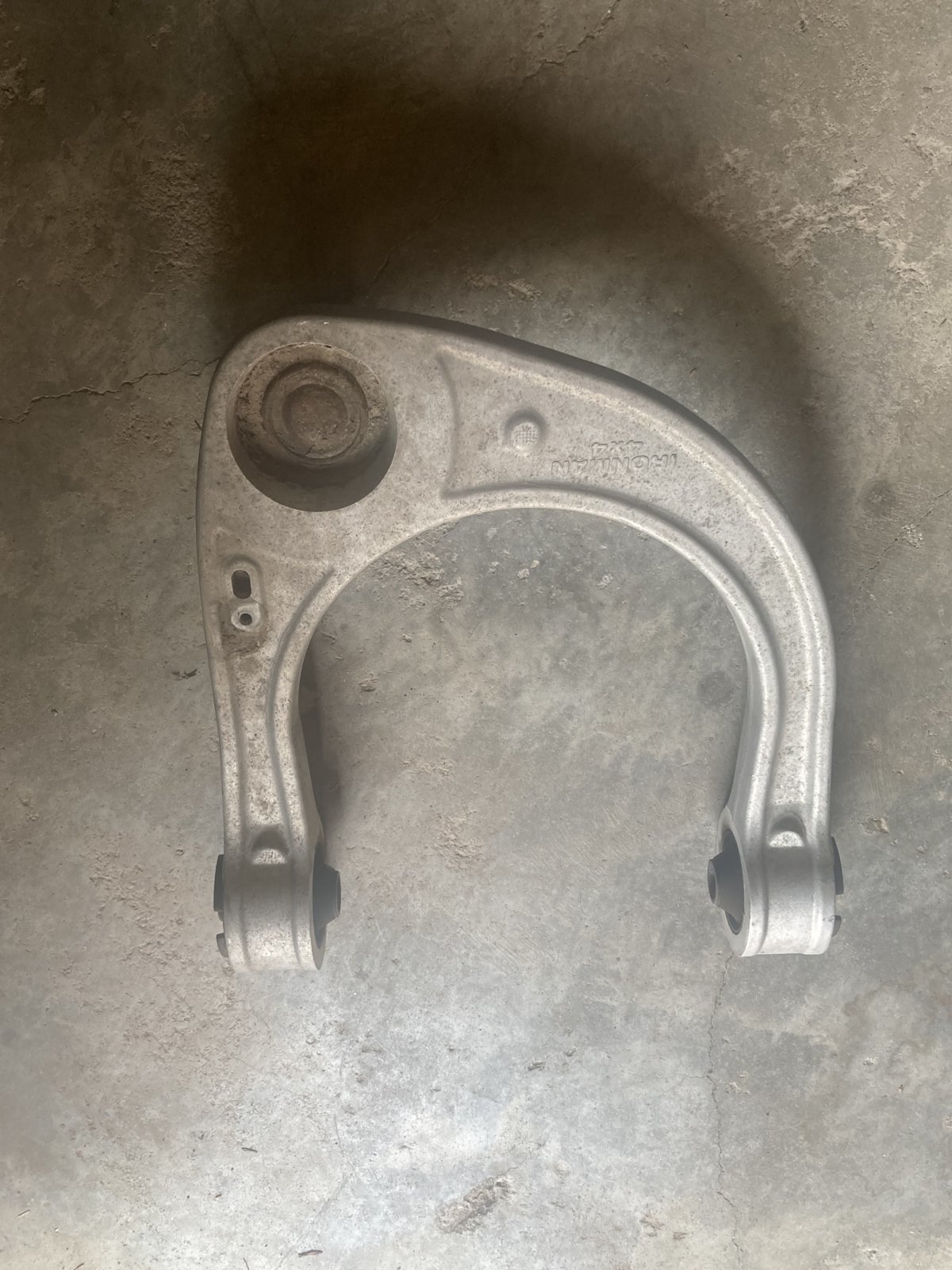

    Haven’t posted in a bit, finally swapped out the Ironman UCA’s today with the replacements they sent for the recall due to bad balljoints. The new ones have Moog balljoints with zerk fittings, we’ll see how these hold up. The balljoints in the first set of UCA's were shot.

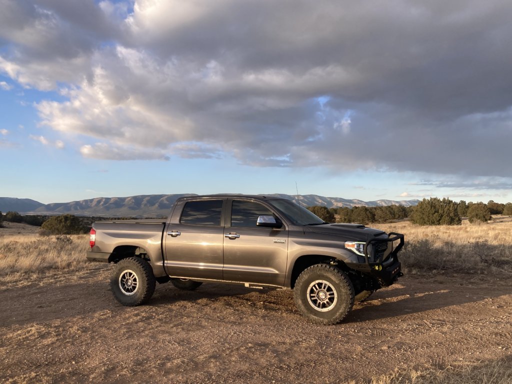

    All shined up...

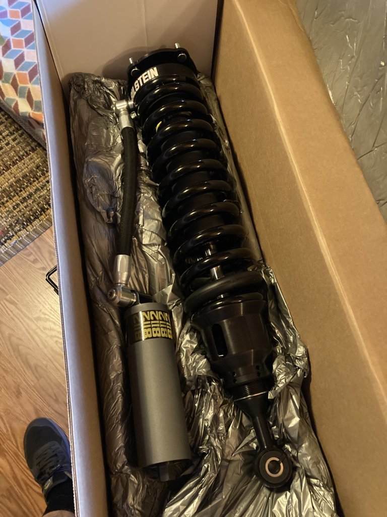

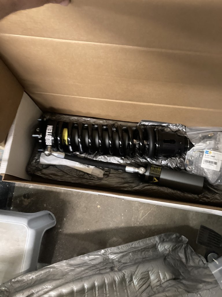

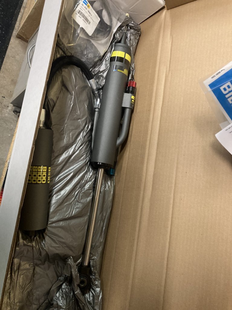

    Bits and pieces arriving for a much needed suspension refresh more to come. OME setup has served its purpose but I can’t wait to be on new suspension. Thanks to @memario1214 and Hotshot Offroad, one of my favorite vendors.

    The brown truck swung by today and dropped off some more goods, stacking parts still waiting on UCA's and need to order a new set of leafs and shackles.

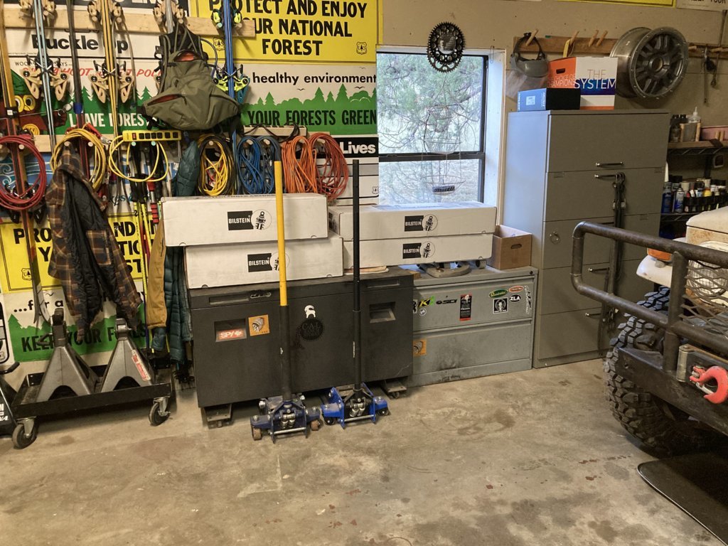

    Didn't mean for this thread to be a cliffhanger, suspension is still sitting on the bench Deaver U748's are on the floor. I plan to go to work on the suspension in the next couple weeks, work has been busy and I've been spending my spare time riding dirt bikes.

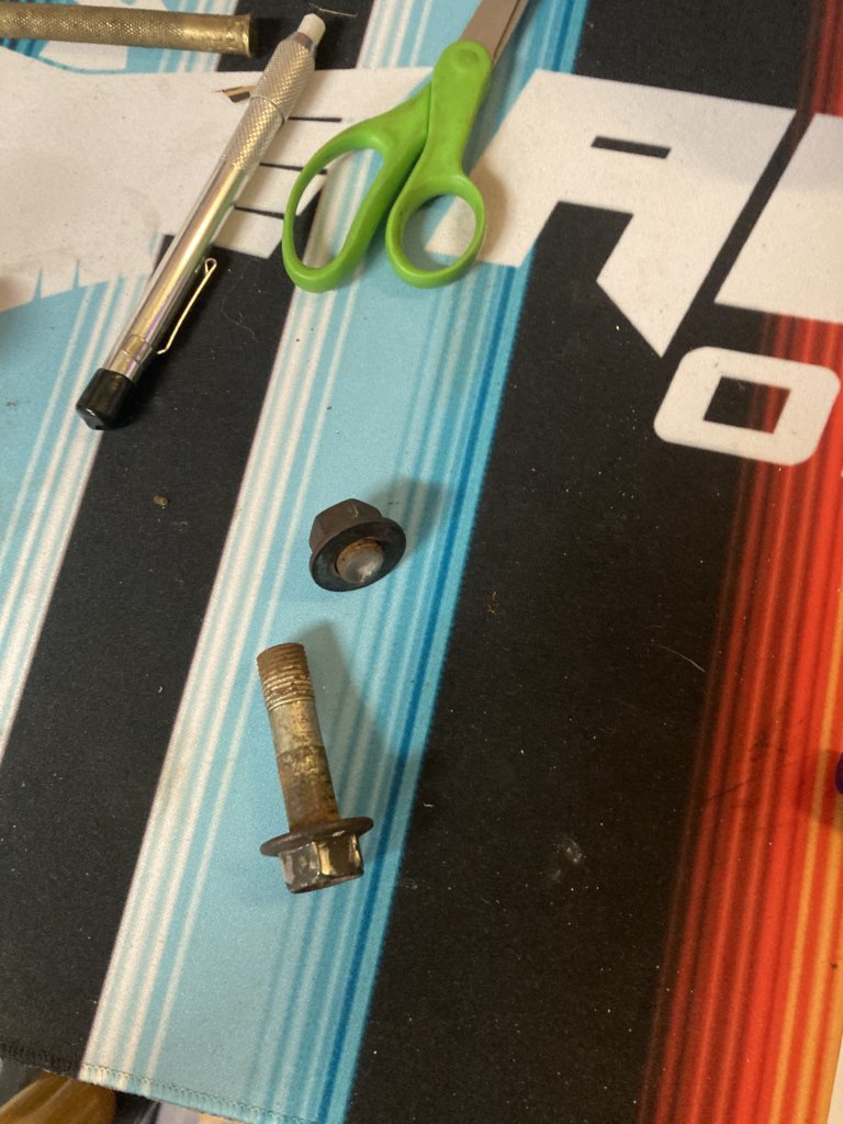

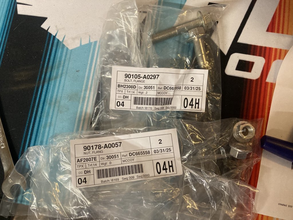

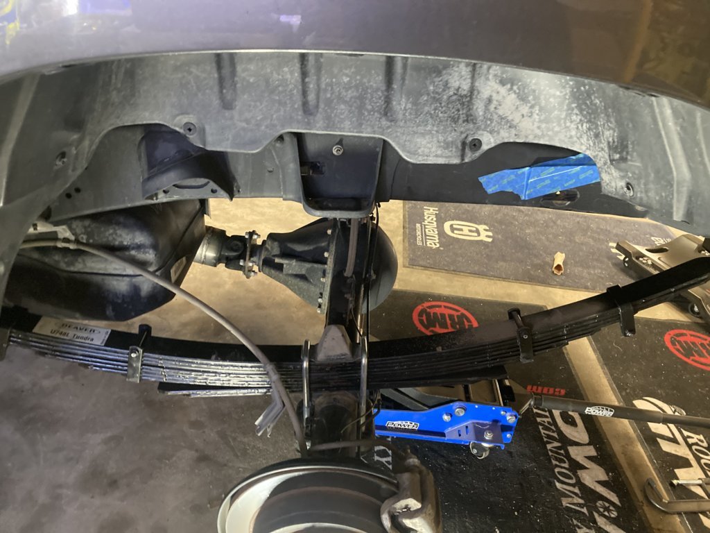

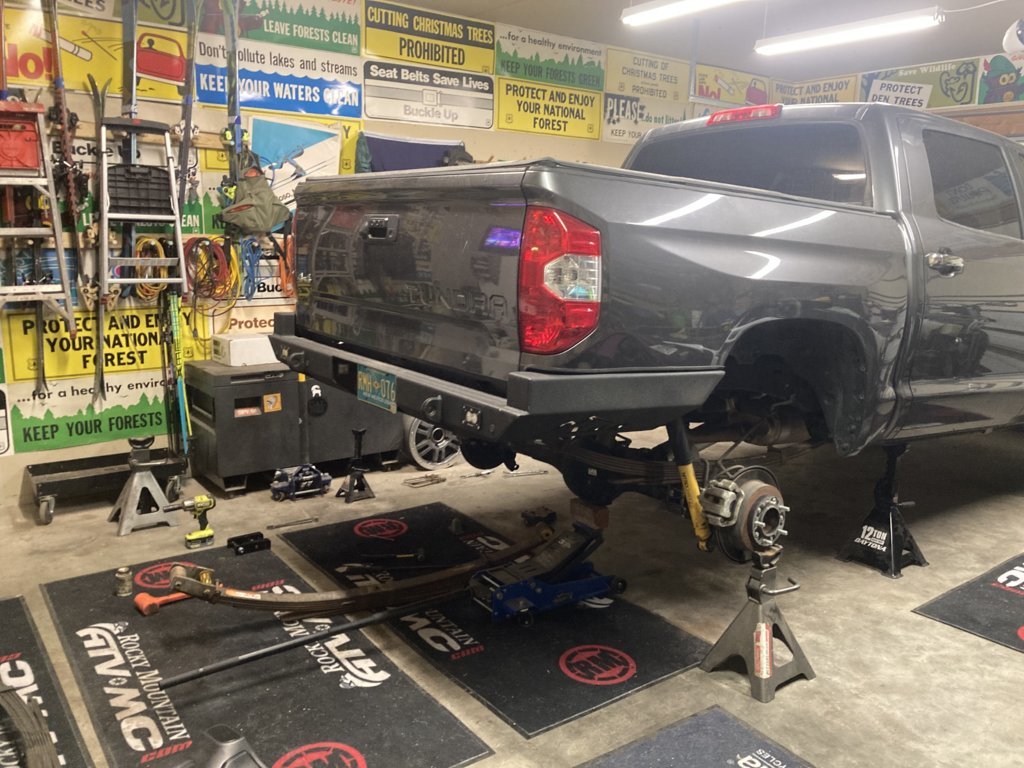

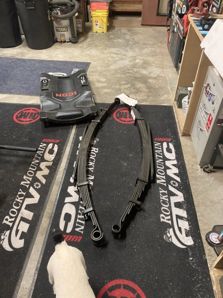

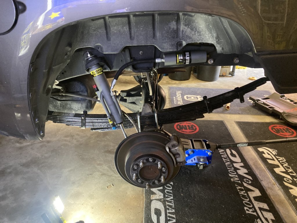

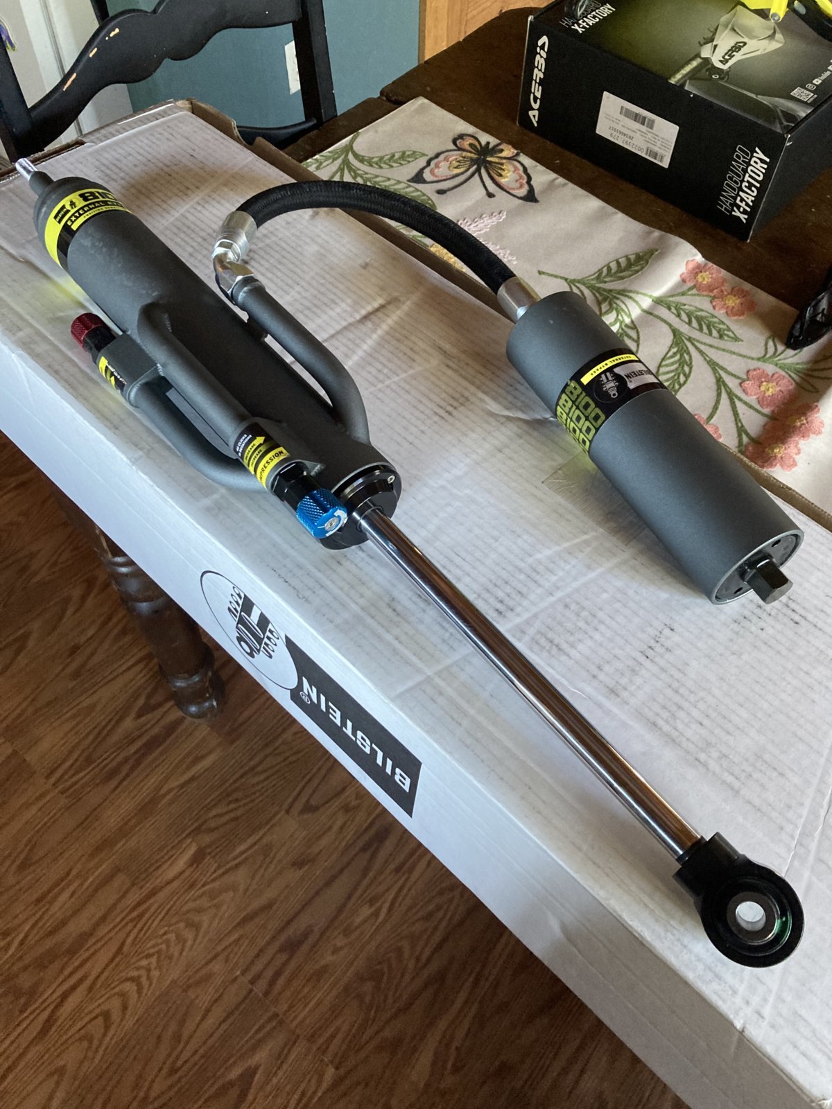

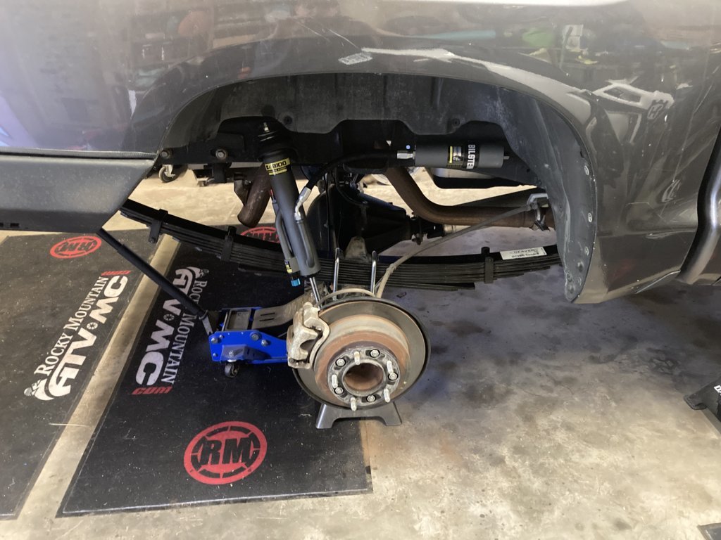

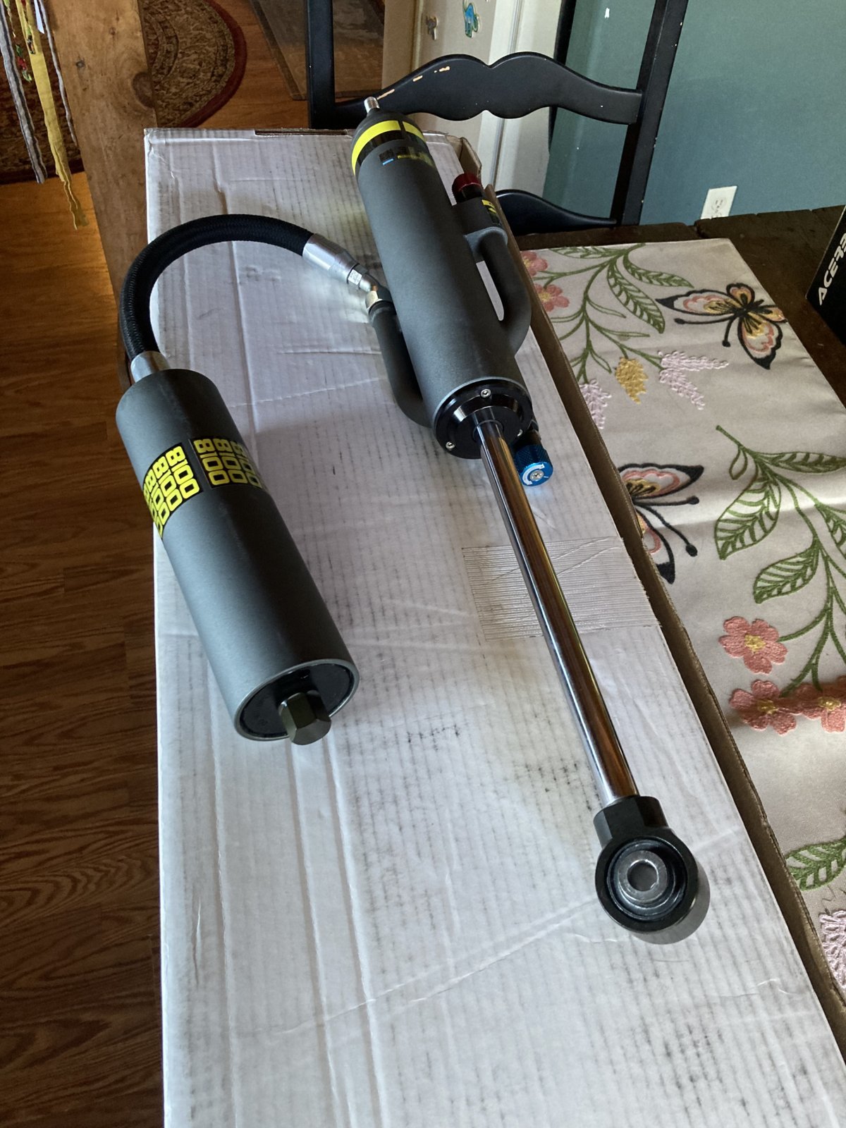

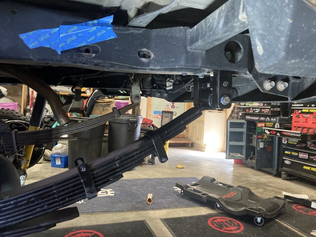

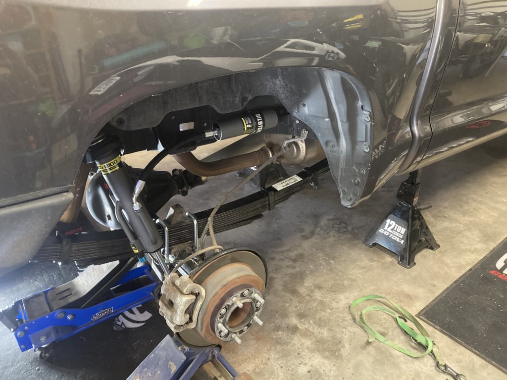

    Went to work on the rear suspension this weekend, ran into a couple issues so I'll be waiting on a few parts to come in before I can finish it up. Installing a set of Coachbuilder +1 Shackles is where the first issue came up, I forgot that the OME frame shackle bushings have a different inner diameter than OEM frame bushings. Unfortunately you can't get the frame bushings by themselves you have to order the entire factory shackle to get the OEM frame bushing, ended up ordering a complete set of Energy bushings that has the correct frame bushings. It's mocked up with a spare set of bushings and sleeves that are the correct diameters but the widths are off.
    Penton hanging out, supervising and checking out the goods.
    Deaver U748's
    Had to nip the corner on the rear bumper for the reservoir mount.
    The passenger side rear lower shock bolt was seized and broke when pulling the old shock off, I'll pick a few up from the Toyota dealer tomorrow currently mocked up with grade 5 bolt that was handy.
    Plan is to finish up the rear this week in the evenings after work, and start on the front next weekend.

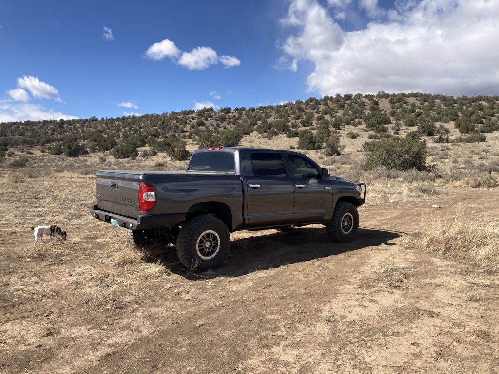

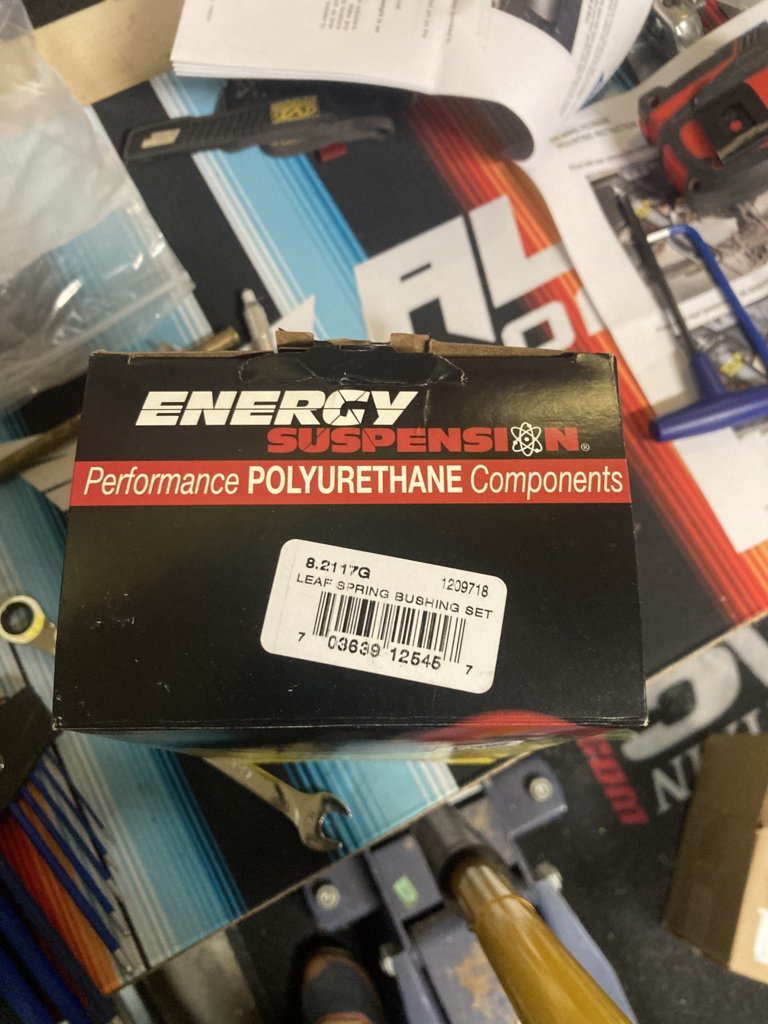

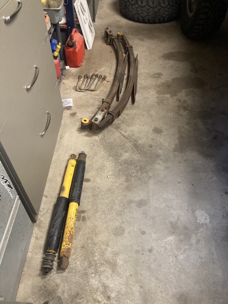

    I was able to finish up the rear suspension this evening, Energy bushings showed up today and picked up the lower shock bolts on Weds.
    I have some Old Man Emu looking for a new home, a couple of folks are interested locally otherwise it will go on Craigslist or the classifieds.
    After taking it for a quick spin, it's back in the garage so I can work on the front suspension this weekend.
    It feels good but I need to finish the front before giving a full review.
    J&ATundra, Vizsla, Mater and 3 others like this.

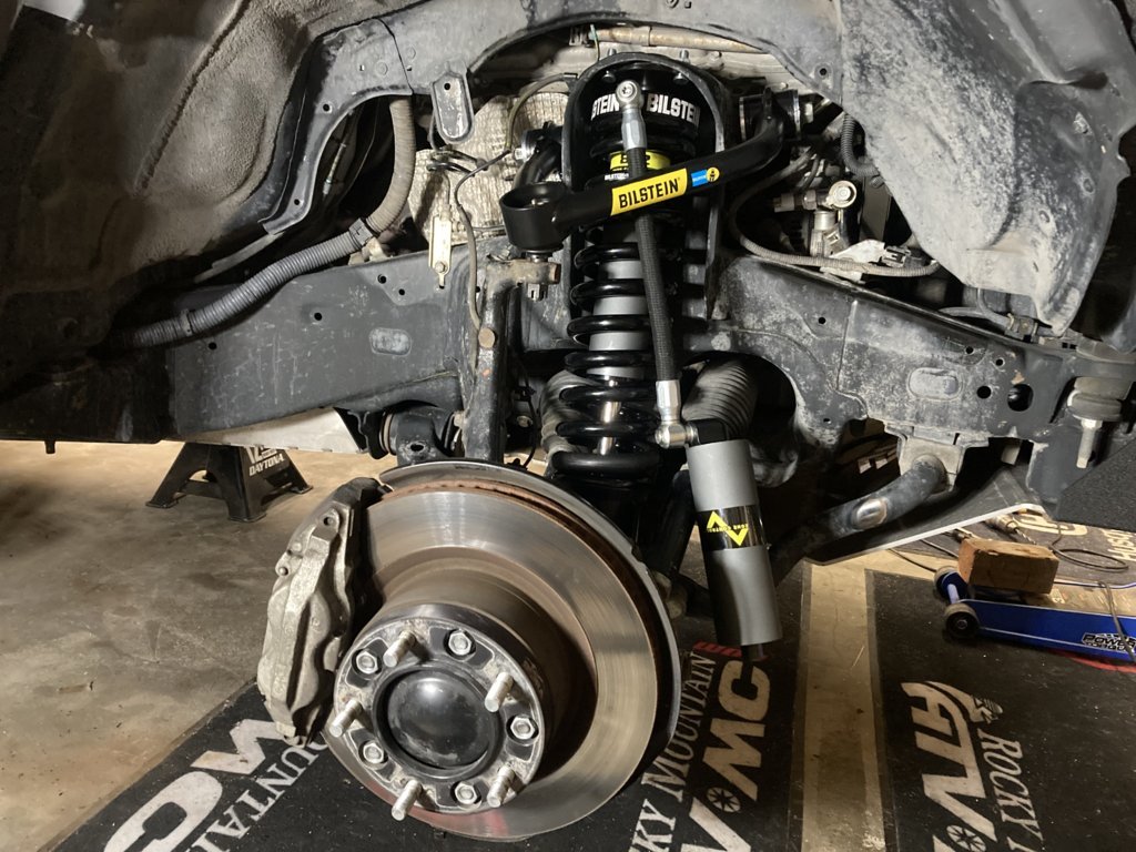

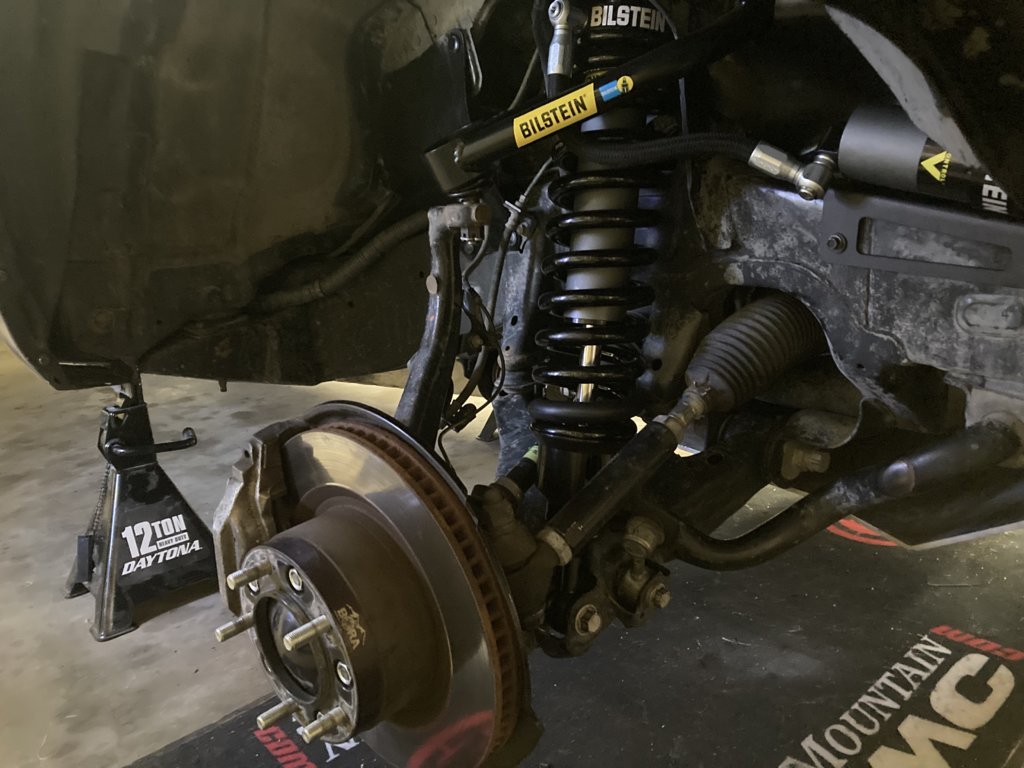

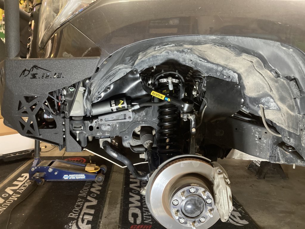

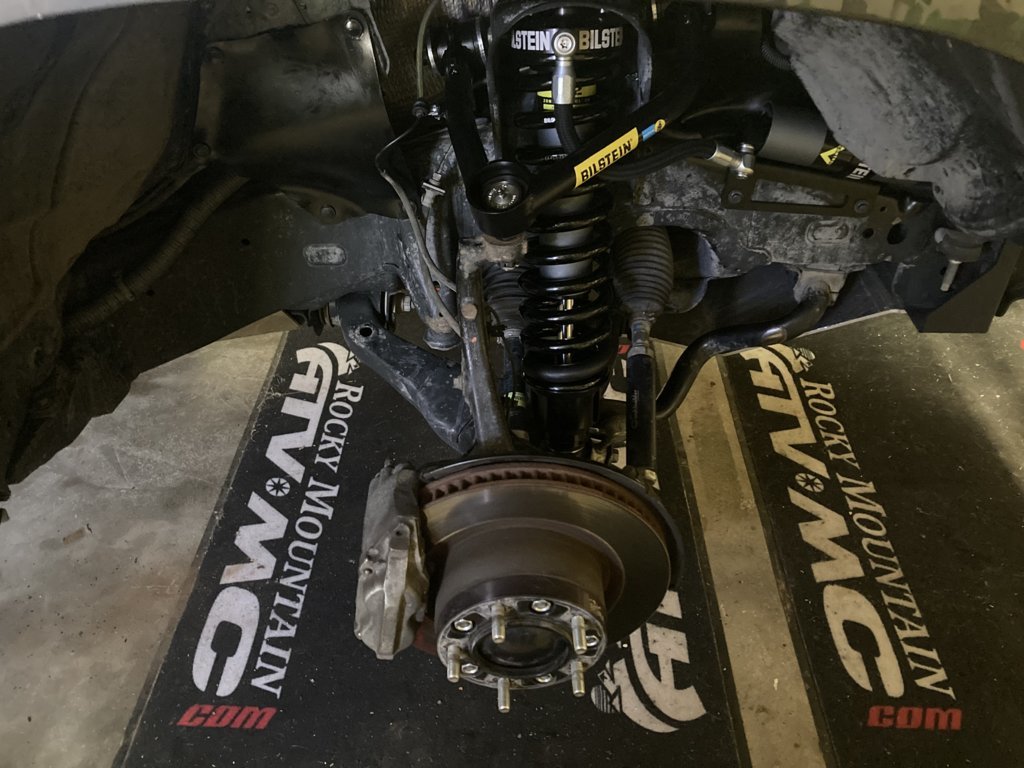

    I was able to finish the drivers front this evening, and finished it off with a set of RAD rubber design splash guards.
    I made it a good way through the passenger front, I'll finish it up tomorrow.

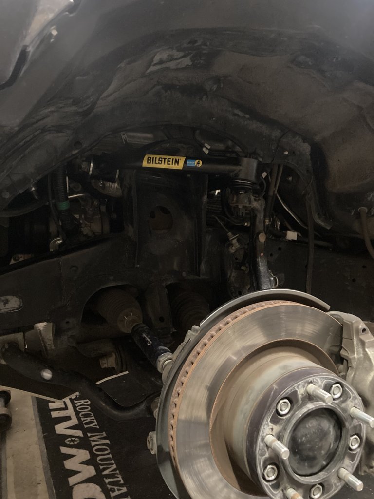

    Alright, finished up the passenger side got everything torqued and took it out for a test spin.
    It's night and day from the old suspension, I need to adjust the front to around 3" they were set at 2.75" from the factory. Next up will be taking it in for an alignment and putting a new set of 37x12.50R17 Cooper AT3 XLT's on it that I picked up last summer when I found a deal on them that was to good to pass up.

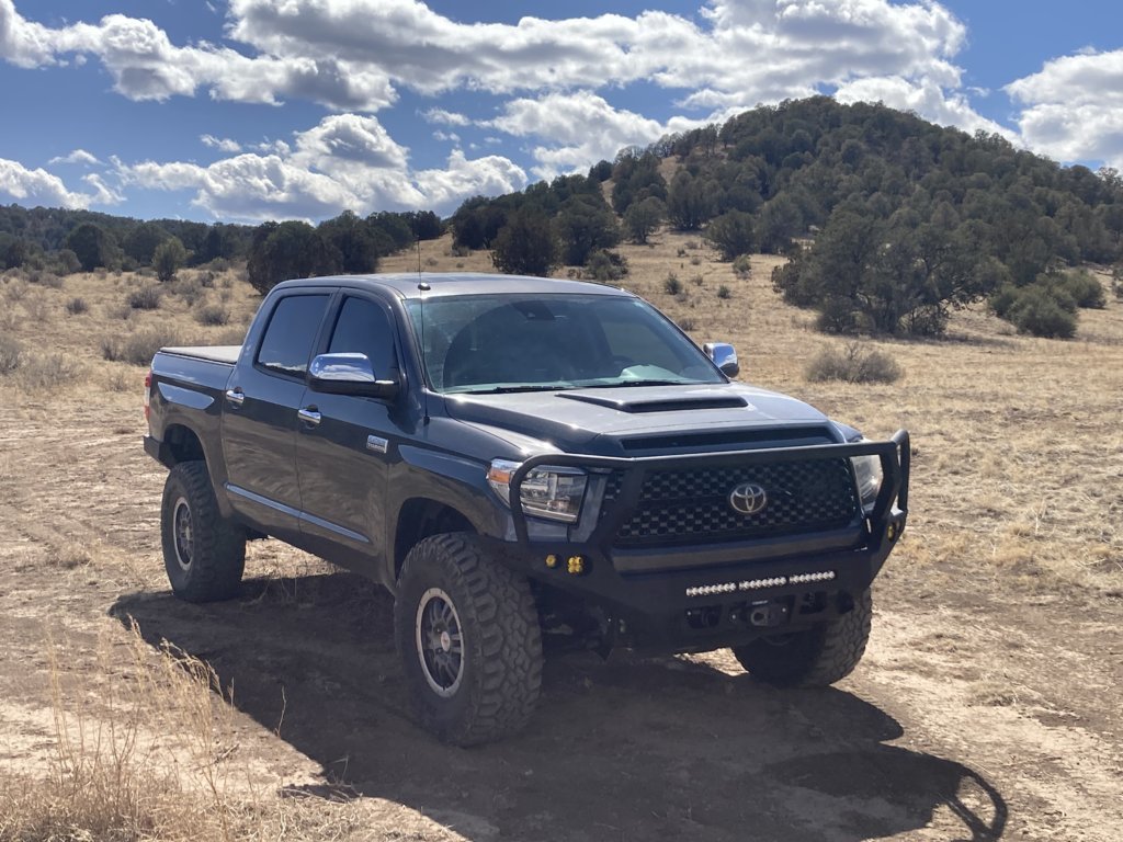

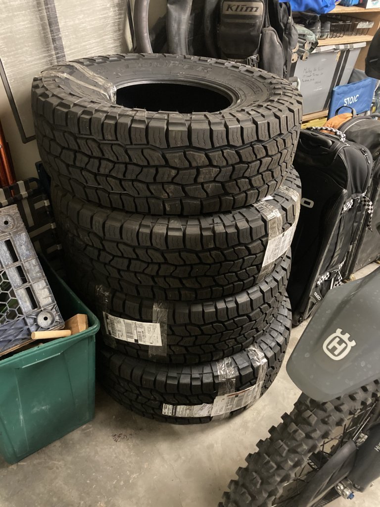

    I cranked the 8112's up .25" to bring the front to 3" of lift, it had a little too much rake for my liking. They were pretty easy to adjust on the truck, if the rear settles more I'll drop the front back down.
    Cooper AT3 XLT's 37x12.50R17LT Load Range D, plan to mount these up once I get an alignment and will run 10 Oz of Checkered Flag ceramic balance beads.
    Took it out again after adjusting the suspension and rallied some BLM roads out by the house, super supple and planted overall really impressed with the Bilsteins and Deavers.

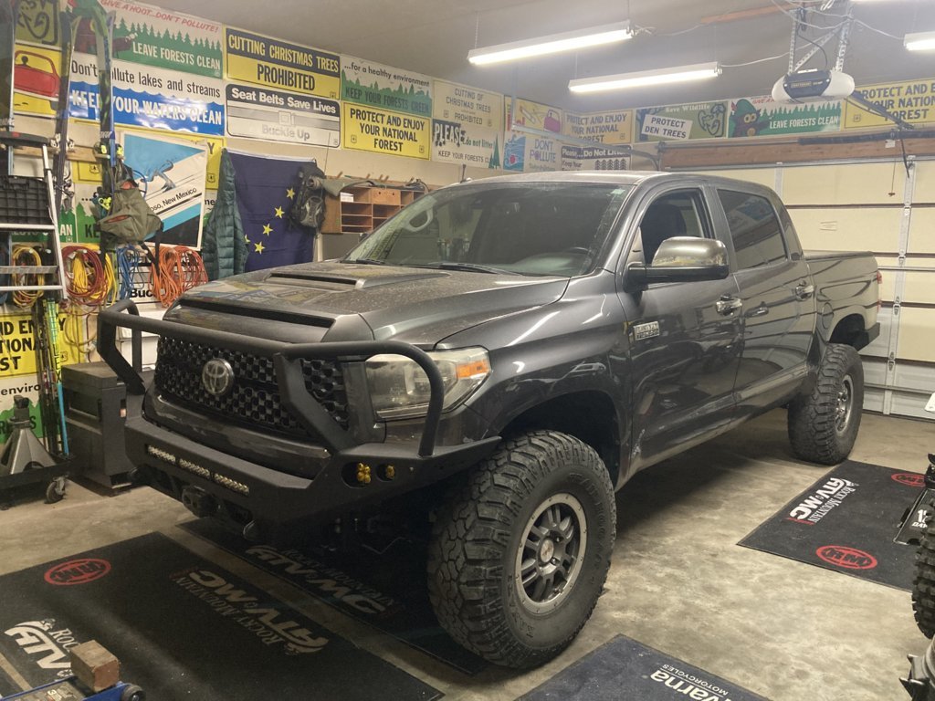

    I did a few things this weekend and have an appointment tomorrow to get the truck aligned and new tires mounted.
    Installed a set of Durobumps, and re-torqued everything just to make sure things are right after a couple hundred miles and some shakedown runs.
    Going with a matching spare so I can do 5 tire rotations.
    Swapped out the OEM RW center caps for a set of 3D printed ones from Sierra3dprints.
    I'll post some pics of the new shoes once they're on.
