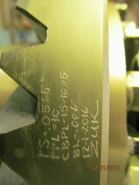

    Zuk started on the rear diff this afternoon, I'm fascinated with all the information and photos he shares and spend a lot of time studying them. The statements in quotation marks is what he sent with the photos.
    "Checking the factory pattern, which was fine. I can tell by the bias that it is a two cut pattern which is very common in the auto industry"
    "145 ft lb with generous amounts of red loctite on clean threads on all 12 bolts"
    "The pinion flange is in excellent condition....barely a little groove and finish sanded with 2000 grit wet and dry as insurance"
    "The 10.5 comes from the factory with a short solid collar which is nice that they do that.... The pinion bearings look perfectly fine"
    He was surprised when I told him there is 102K on the truck with the condition of everything he thought it would be less miles. I'll keep updating as the photos and info roll in and I have time to post.
