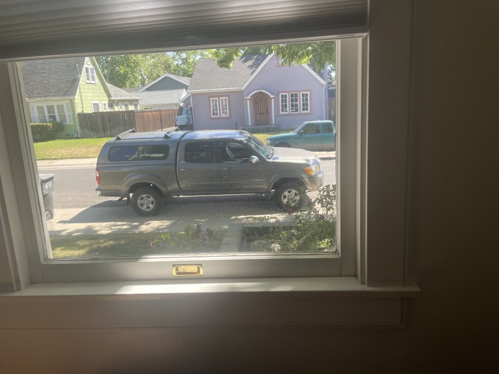

    I've got myself a mystery "bang" on my 2006 DC 4x4 Tundra. If I drive the car (can be as short 2 mile drive), and then turn the car off, I get a bang sound a minute or so after the truck is off. Sounds much louder than "cooling tings". Happens every time. Haven't modified anything recently. It's so loud when it happens I can hear it in my house while the truck is parked outside (see photo).For clarification, the truck is off and no CEL when on.
