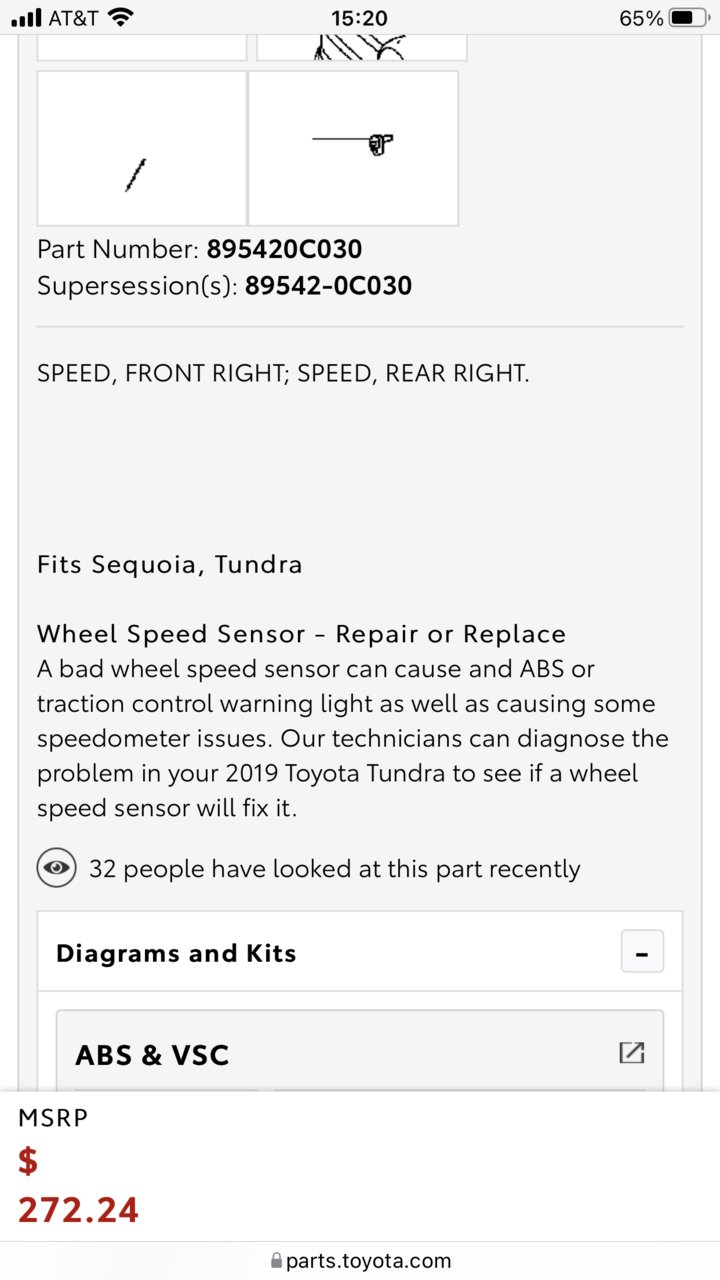

    I would replace the abs/speed sensor before the rear hub assembly. As others have said it can cause havoc to the dash. From parts.toyota.com

    Yeah, wheel bearing goes bad, tone ring rubs on sensor tip or just don't read correctly anymore. Mechanical wear is gonna happen when moving parts are involved. This is not a terrible DIY job.
