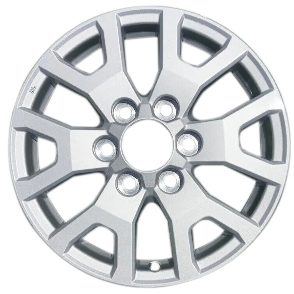

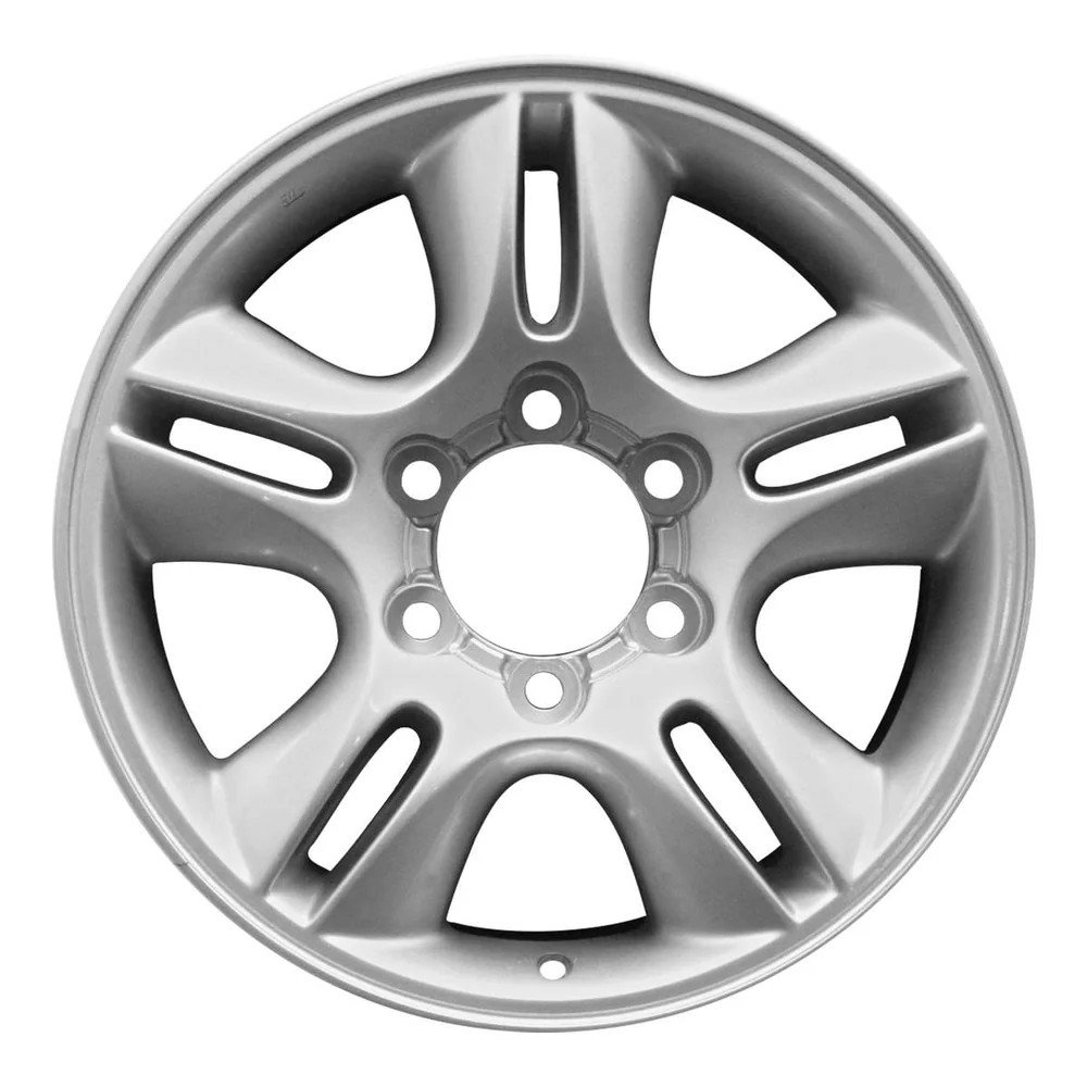

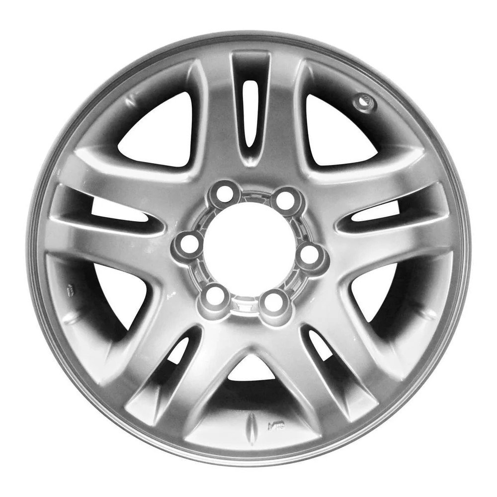

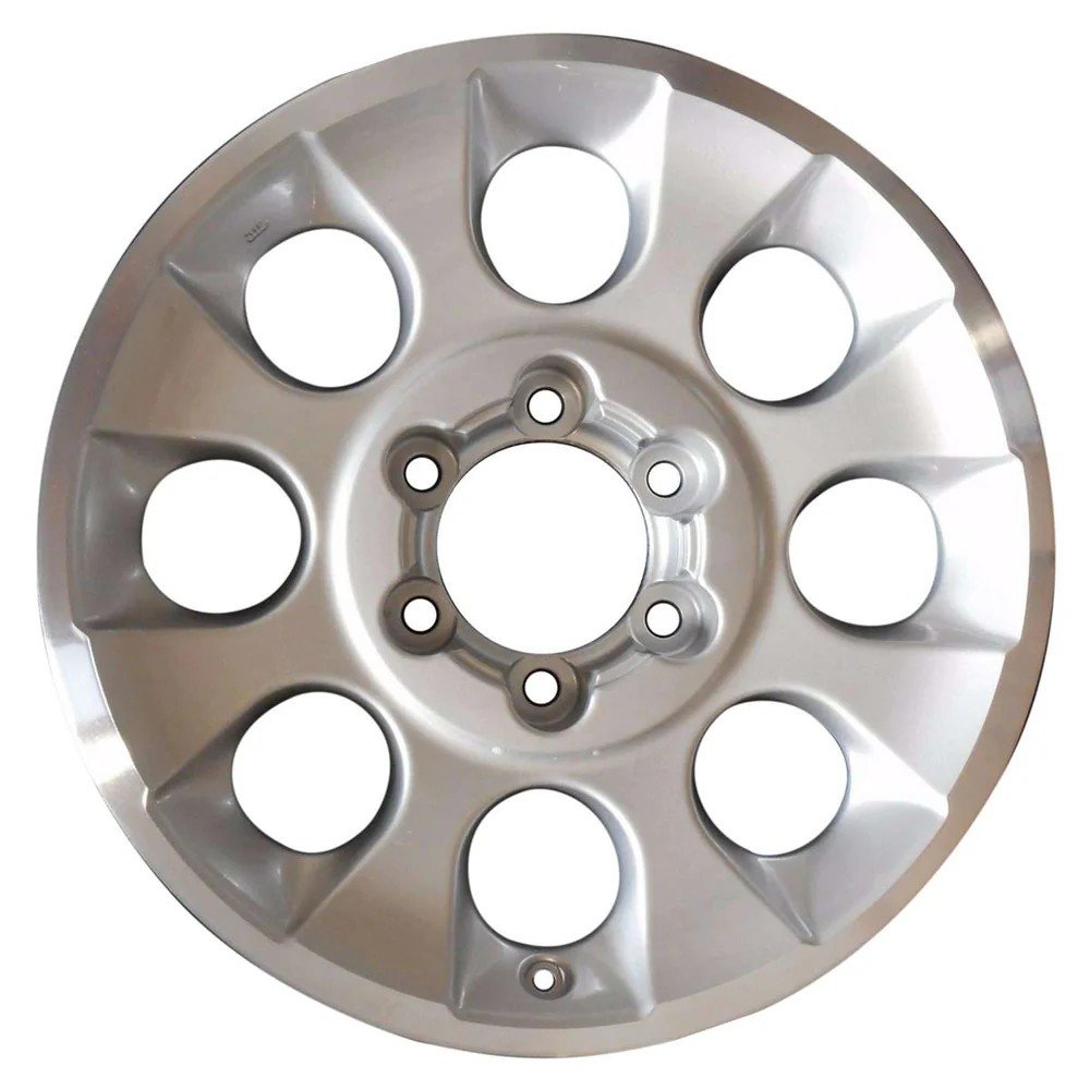

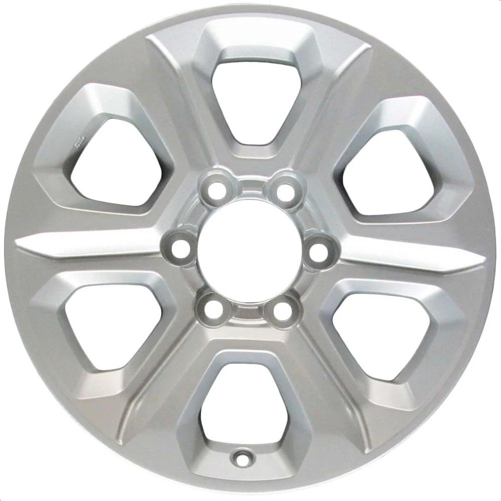

    Do they look like any of these Toyota 17s?

    Dude! I appreciate the interest ya'll are taking in this. LOL
    Top wheels in that pic look famililar.....I'll get the wife to get that pic tomorrow.

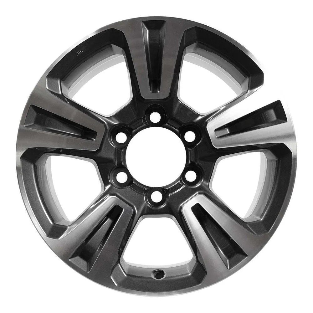

    or do they look more like this?

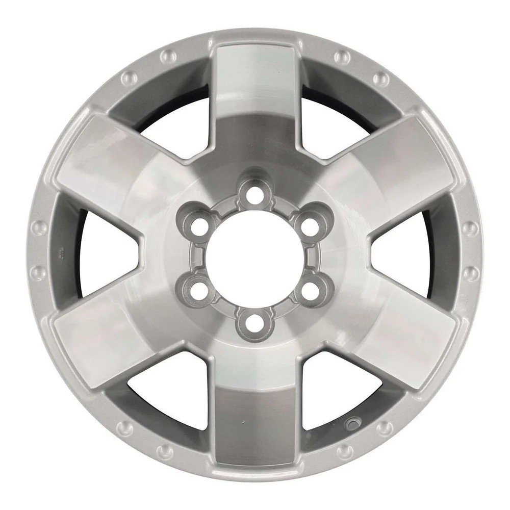

    Its what a 17" wheel measures from lip to lip..............

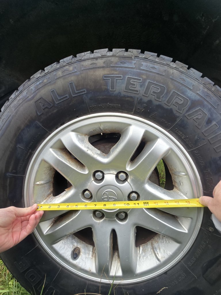

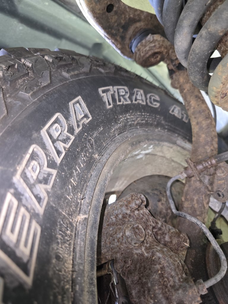

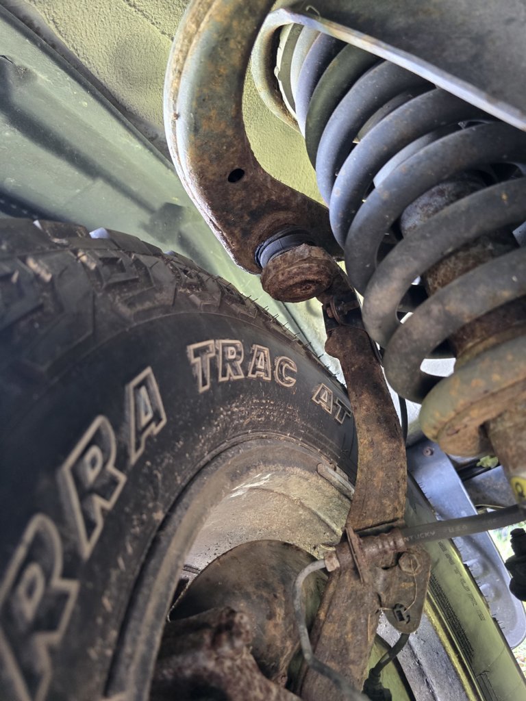

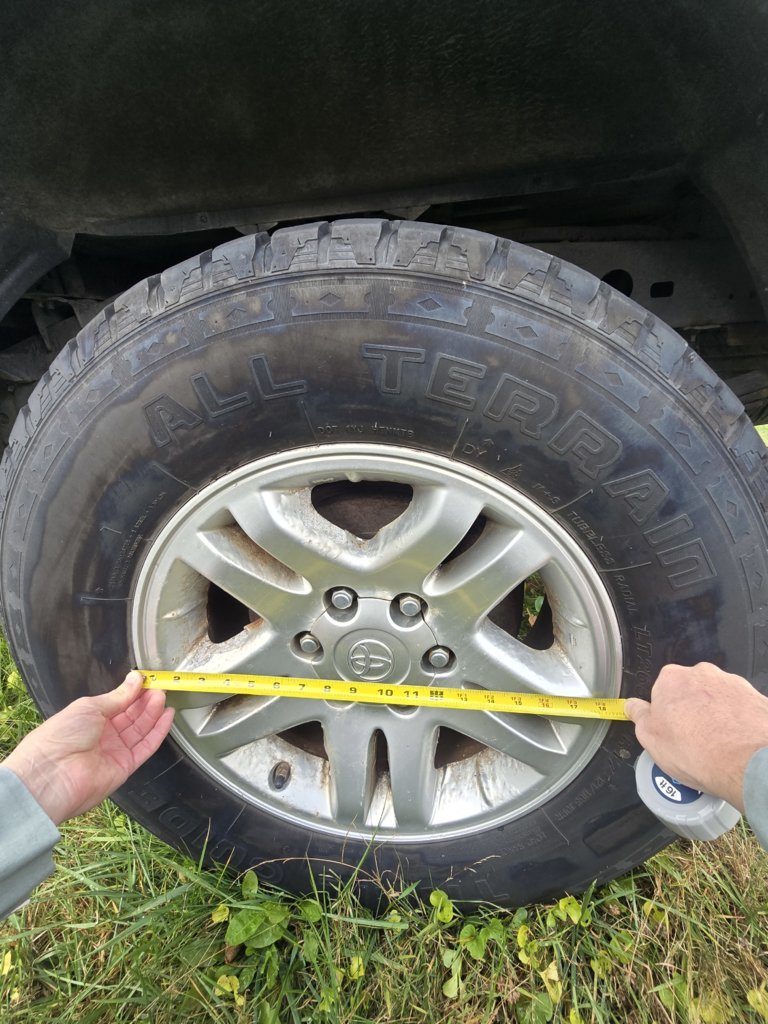

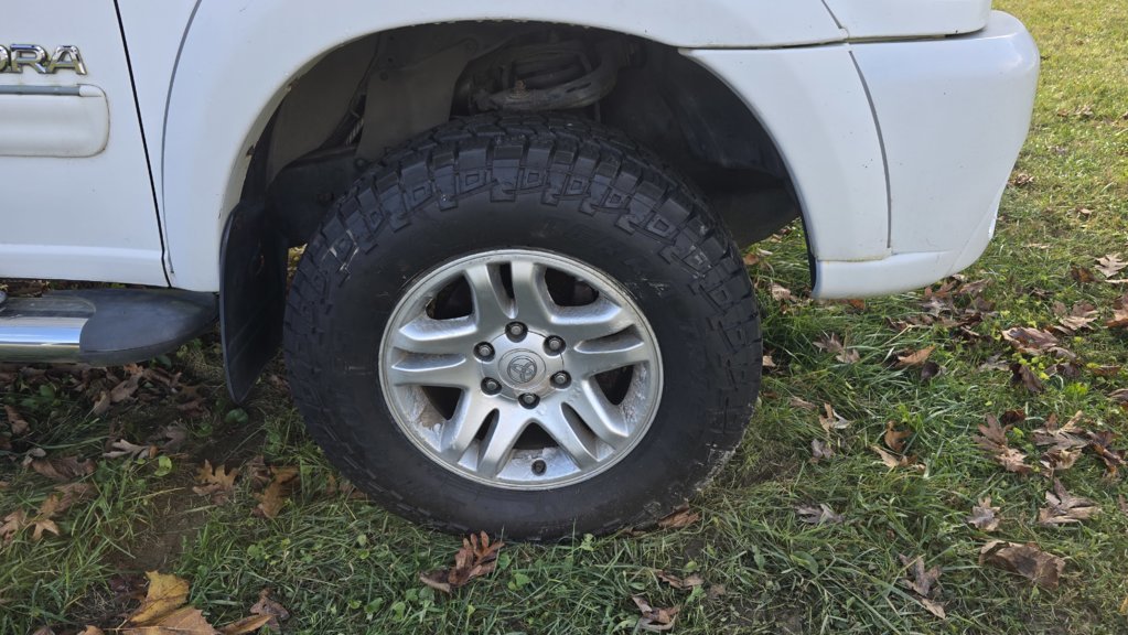

    Weather broke for a bit today and we got some pics.
    Here those are.....wife took pics so not sure how well one can see the tape measure.
    Also got under her for a pic of the clearance issue. Didn't appear to be near as close as when I had the truck jacked up.

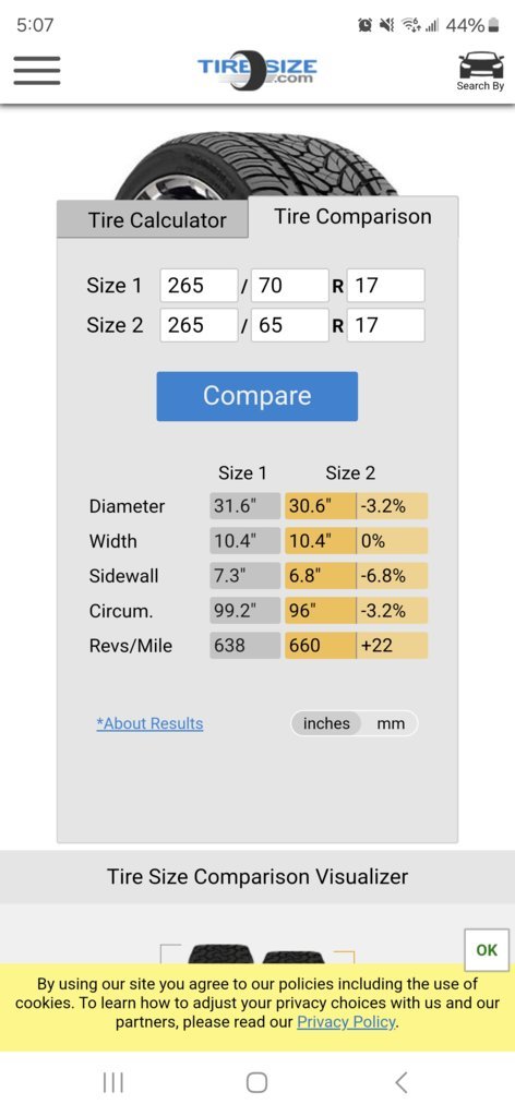

    Those are stock wheels with one size bigger in diameter tires.
    Shown below is stock size 265/65r17 vs your tires 265/70r17 which is just one extra inch of height.
    The clearance between the tire and the control arm aren't anything concerning I don't think. You can leave it be or spend the money on new smaller tires if you see that as a benefit to your situation, hate to throw out near new tires.
    You do seem to have some rust on some components so I hope you are keeping an eye on all that.
    I'm not familiar with any of your other posts anywhere but make sure your lower ball joints and timing belt are up to date.

    5” backspace on those OEM wheels (the best OEM choice) and 265/70r17 tire is no prob.

    I also just noticed these are LT tires, wouldn't that usually make them extra heavy for higher load range? I can't read the load range printed on the tires

    There's one stupid blade of grass obscuring the Load Range. They're either C or E.
    No need to measure with a ruler. Though the size has already been posted, the wheels will have the size stamped on the backside. Unless you know exactly how the measurements are supposed to be taken, your measurement don't mean much.
    The weight difference between P-rated and LT tires will be noticeable. The weight difference between LT C and LT E will also be noticeable. I think all our trucks, if 4wd and used off pavement even occasionally, should have LT tires. Only a rare few need LTE E. C is totally adequate for most of us. There's also major differences in weight between different tire brands with the same load rating.
    I'm living dangerously and don't have LT tires on my truck. Blowout waiting to happen, most likely. The difference in weight on the same brand, same model tire was 10lbs per tire when comparing my XL (extra load) tires to LT-E.

    They are also mis matched. Fronts appear to be newer / more aggressive than the rears.

    You're right, I thought it was a difference on inside and outside tread but yes they are different. Need to verify front and rear tires are same size.
    @Bought2Pull can you get a picture of all 4 tires that show the entire outside sidewall?

    Skimmed the thread a bit, and I don't recall anyone mentioning it, but the tire being close to the upper control arm is fine (unless you want to run chains).
    The distance of the tire's sidewall and the upper control arm/UBJ area won't change during normal operation (it will slightly at the upper control arm as the joint flexes, but a minimal amount).
