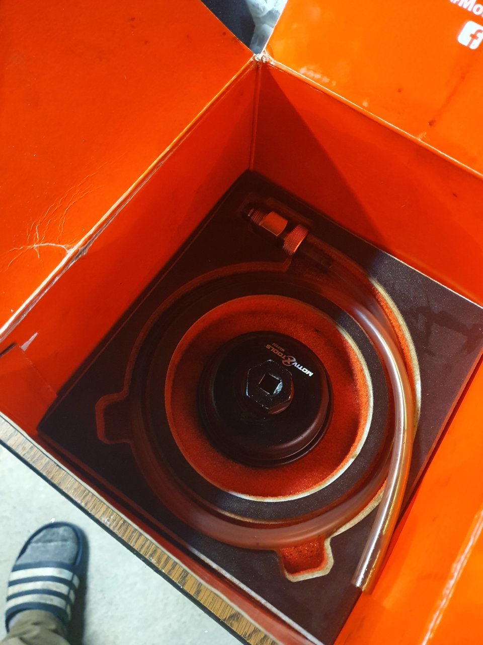

    Yes! The Motivx kit is awesome, looks like their wrench has changed since I purchased but I'm sure it works all the same. I have their whole kit that came with the funnel and filtered drain tube.

    Yeah the funnel is super convenient since it screws into the tube so you can pour the oil in very quickly but it's definitely the least needed part of the kit The wrench and the drain tool really help make the oil changes easier though.

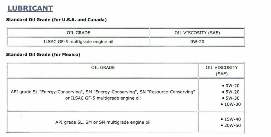

    Toyota does not have a spec for engine oil for the Tundra. You can put almost anything in it, no special OEM approval like some German manufacturers.

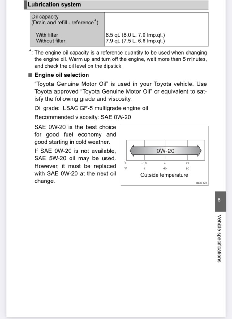

    Toyota does have a spec for their oil bled or else they wouldn’t have their own blend. They recommend toyota brand oil right in the owners manual. All oils are not equal even though Mobil 1 does meet the specifications of what toyota requires for their vehicles. The Toyota oil has additive packages not equaled by other oils hence the reason they recommend it. Sure you can put anything in it just like you can put any gas stations gas in it they are mostly all top tier certified but they are definitely not equal, some are noticeably better.

    Toyota does not say that your oil needs to meet a certain OEM specification like some vehicles, for example I own a motorcycle that needs a JASO certification, also had a VW diesel that needed a specific VW approved certification that is listed on the bottle. Our engines do not require any specific OEM certification. Maybe the Toyota Brand oil has a different additive package but Toyota in no way says that you need to use Toyota brand engine oil. It just says ILSAC GF-5, which is basically every oil on the the shelf. Now when you look at what Toyota says to use for the transfer case, you will see that they solely approve the Toyota brand transfer case fluid. You are wasting money buy Toyota brand engine oil but use what ever makes you feel good. I stick with OEM fluids for ATF, coolant, transfer case and power steering but definitely not engine oil since.

    You are correct, but I Never said Toyota requires it. I said toyota specs their oil one way and it’s not the same “OIL” as Mobil 1. You can use whatever brand you want. They just recommend toyota brand motor oil is all. I don’t think there is a disagreement here.
