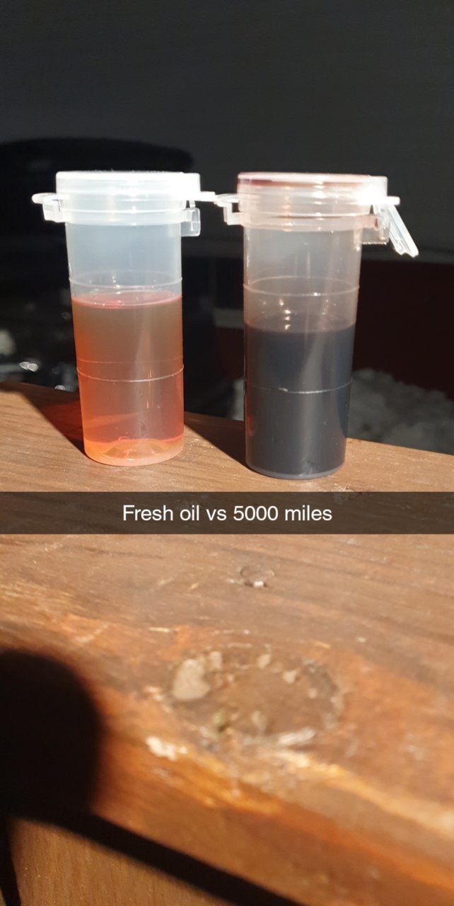

    I know color is not always a indicator but this is Mobil 1 5w30 after 5000 miles. Just change it yesterday. I can hear when its getting close to 5k because it starts to sound like it running on 0w20.
