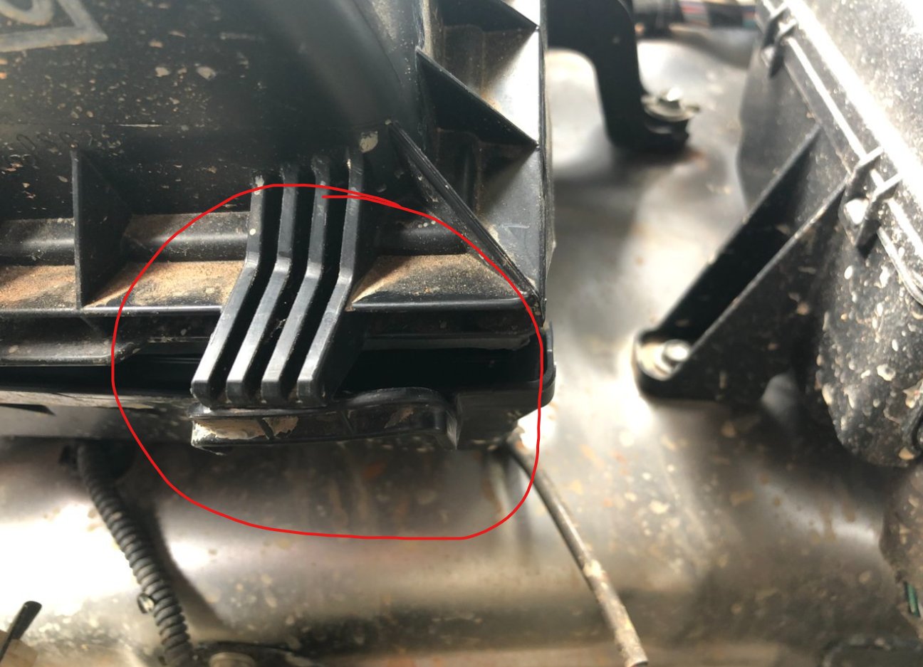

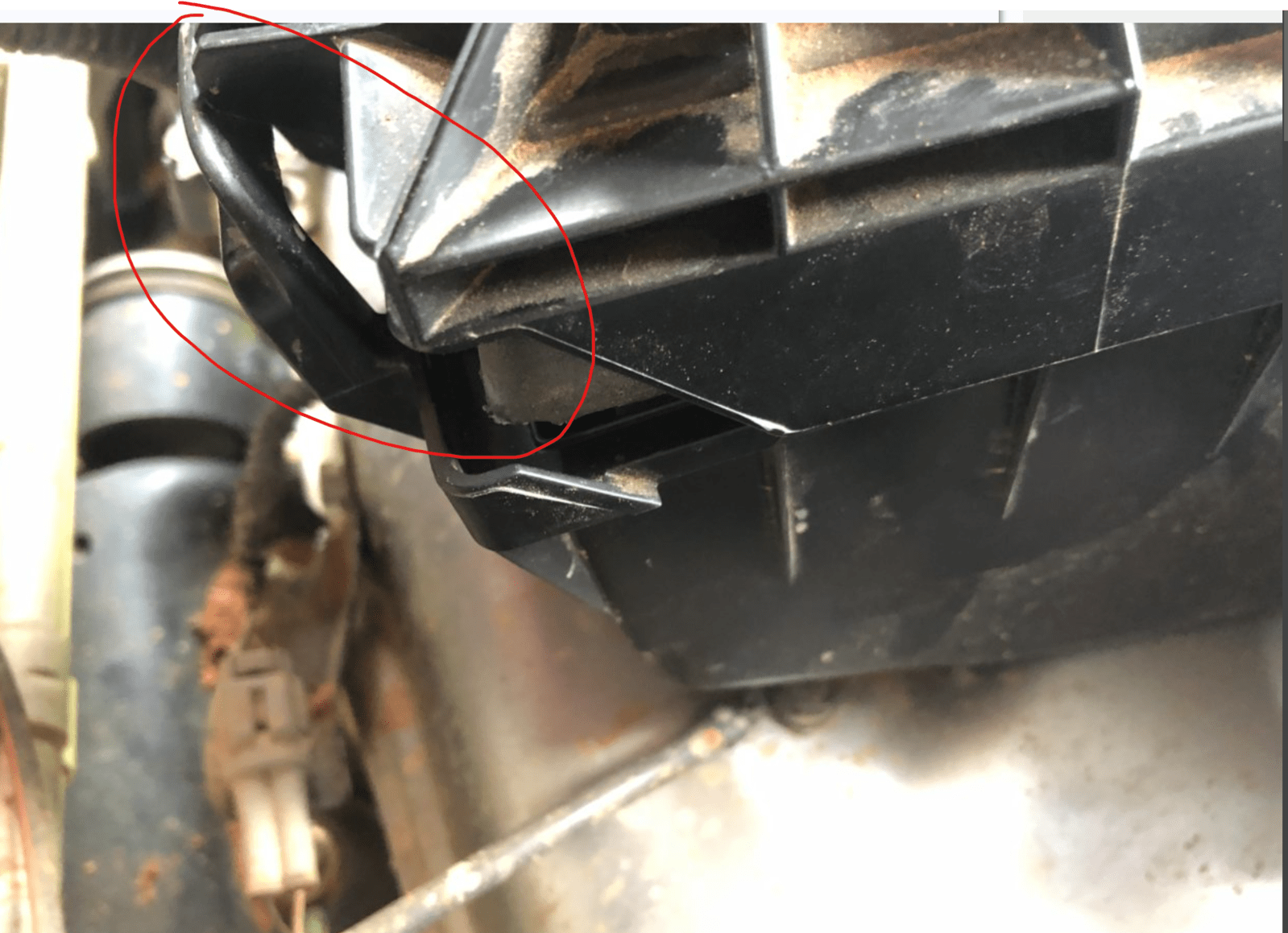

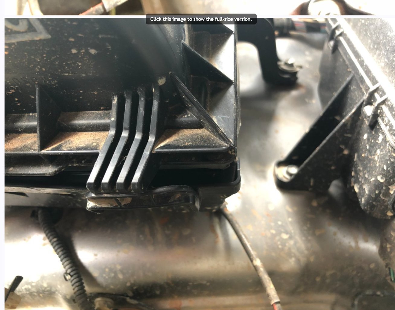

    Probably just over-worrying myself but I went to check my air filter this morning and noticed that the top portion of the air box (lid) was not fully seated. One of the prongs in the back was not through the female clip/hole. I noticed my air box was fairly dirty when I removed the air filter. I took metal ring off the corrugated rubber tube that goes directly into the engine and that area was spotless. I’m worried that excess dirt/dust entered my engine during the ~5kish miles that the air box lid was not seated/sealed right. I do off road with my truck so could that explain the dirtier than average air box if I was in very dusty or muddy terrain? All input appreciated, thanks.

    dont know if it matters any more but its not seated properly the tab is supposed to go in the opening.
