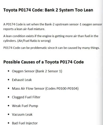

    @George6436 we still haven't heard what engine you've got either, the V6 or V8? I've been running on the assumption it's V8, and a couple hints above kinda confirm it, but we should probably ask you.
    If you're telling me it was popping a P0174 before the fuel pump replacement, that's interesting and therefore I'm not necessarily going to tell you I think it's the fuel pump, but failure to provide adequate pressure across both rails ould result in a lean condition on the passenger side, because it's the final rail to get fuel. But if you aren't sure the check engine light prior was in fact a P0174 code, then I'm almost always going to blame an aftermarket fuel pump in this case. More on that later.
    The smell thing is interesting also. I'd be curious to hear more about that. Is it inside the cab, outside the truck, above or under? Is it stronger in the engine bay, or at the exhaust end of the truck? If the smell was your cats being clogged, which smells sulfur-y, like a grille cleaner brick rubbed across a flat top grill, I'd expect other codes. But rodents are notorious for nesting up in our trucks and chewing on wires and plastics, chewing apart filters which can lead to mildew, paper touching hot stuff, etc. Or you may be smelling exhaust from running rich (smells like gas) or lean which can smell a bit eggy also, but almost like dusty eggs to me.
    From a logical perspective, there's a few more obvious things I think it could be, but without being there in person and being able to test things, I can't say for sure. Of those things:
    1. Bad upstream O2 sensor on the passenger side, the sensor between manifold and catalytic converter. This could be malfunctioning, and reporting bad info (i.e. "the engine is running too lean") back to the ECU. Running lean can also cause slow starts. Sometimes inspecting the spark plugs nearest the block, if they're light orangey-tan on the normally-white parts, can conrifm you're actually running lean. As much as dumbasses will try to convince you O2 sensors are some big brother gov't EPA conspiracy, the upstream sensors are pretty critical b/c they provide combustion data to your ECU which helps the engine run optimally without burning up your spark plugs and creating other wear and tear. IF YOU REPLACE your O2 sensors, I cannot stress three things enough, and those are (A) replace both the upstream and downstream on the impacted bank at the same time, (B) only use Denso brand parts from a reputable source (i.e. not scAmazon, not fleaBay) and (C) never cut/splice your O2 wires to install a sensor, you're going to create more problems later! and (D) look up your correct "exact fit" (not universal) part number at www.densoautoparts.com - if you need help to get the correct part numbers LMK. You can absolutely do this work yourself, it's not hard as long as you aren't in the rust belt.
    2. Fuel pump is failing to push fuel adequately. If your mech used an aftermarket fuel pump, one of the store-brand shit "lifetime warranty" pumps, they're lifetime for a reason - they're poorly remanufactured, built in sweat shops for cents on the dollar, only designed to last 2-5 years, but sometimes fail early due to bad QC. They're often not tested for basic functionality, because that would cost money. So on this forum alone, we've seen people have pumps DOA straight out of the box, and seen pumps fail within weeks.
    3. Fuel pressure regulator/damper has failed on the impacted rail. But IIRC, the V8/4.7L (2UZ-FE) on these trucks only has a single pressure regulator and single damper, so I doubt that's it.
    4. Fuel filter is jammed and reducing fuel pressure to the rail. We've seen it on here before with '00-'04 trucks ('05-06 don't have fuel filters), but so far, it's been super rare, and only with aftermarket fuel filters, where someone replaced the filter. It seems the OEM filters aren't very aggressive with filtering, which leads to less clogging. You can absolutely replace the fuel filter yourself, but it's a bit of a knuckle buster, you'll get a face full of gas in the process, and you should stick with an OEM filter unless you want to potentially be here again in a couple years.
    5. There are various other things that could lead to lean condition related to air/vacuum. Like (A) intake manifold gasket is blown on the impacted side, and allowing extra air in, which would foul the air/fuel ratio with more air, which would lead to lean running, or you've got a vacuum hose cracked/loose/off somewhere, or (C) a bad gasket somewhere along the intake/exhaust chain between the intake manifold and the upstream O2 sensor. There are symptoms of an intake manifold gasket leak would be hissing noises, and I'd expect to see misfire codes.
    6. Incorrect or fouled spark plugs on the entire side of the engine with problems; if you've been running rich or lean for a while, you can foul the spark plugs on that side, which will just exacerbate the problem. I don't think it's bad plugs or bad coil packs, only because the chances of it being all four on a single bank, with no evidence on the other bank is like your chance of hitting the lottery this week.
    7. Rodents/shorts/gremlins. Rodents have chewed something up, or a line is shorting or rubbed out somewhere, which is causing problems with fuel delivery.
    Anyway, if it were me, and I just bought your truck, and I was chasing down this issue, the first thing I'd do would be:
    • Get a can of ether. Spray it into the throttle body before starting the truck. If it fires up immediately, your problem is probably fuel delivery related.
    • Inspect the O2 wiring on bank 2, i.e. the passenger's side exhaust bank. Make sure the O2 sensor harnesses have never been cut. I'd start the engine and get a kleenex/tissue and hold the end against every exhaust joint to check for leaks, or if you're a smoker, you could hold a cigarette around each exhaust joint to check for leaks. If the truck has more than 100-150k miles, I'd replace the upstream and downstream sensors with legitimate Denso brand exact-fit sensors on the side throwing the lean code, since I'd be super suspicious of the upstream sensor specifically. I'd remove the negative battery cable during the replacement work, and make sure it's off for at least 10 minutes to let the ECU reset and enter re-learn cycle after.
    • I'd take a minute to clean the MAF, specifically with CRC brand MAF cleaner. I'd do this when the engine is cold. Once I was done, I'd pop off the negative battery cable, then leave the MAF out to return to ambient temperature (it'll be cold af after spraying). There are videos online showing how to clean MAF, and CRC MAF cleaner is $10 or less at every chain auto parts store. I don't think the MAF is the issue, but if your throttle body was dirty as hell as you say, the MAF will have just as much shit built up on it. Both MAF and TB get dirty fast if you're using oiled filters and/or aftermarket air intakes like what K&N offer (which are basically shit in a box, sound and look cool, but don't actually do much other than adding a tiny torque bump in these trucks at the cost of dirtying up your engine, reducing long-term performance/longevity).
    • I'd really be interested in checking the fuel pressure at the rails, I don't think I could resist, but I'd probably do the above steps before then, and see where I landed.

    The truck long cranks when the engine is heat soaked. The reason is the fuel system is under pressure when truck is off and hot. The leaky injector is letting in raw fuel. This is flooding the engine. The engine has to long crank to clear out the raw gas before it will start.
    The reason this doesn't happen on cold starts is the gas has evaporated overnight.
    I believe you have 2 issues. A bad injector and a bad 02 sensor.
    The 02 sensor code may go away if you find and fix the injector(s).

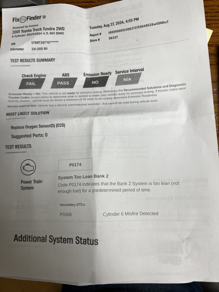

    Ah, you had two codes. P0306 also.
    That's an easy one, but taking the right action maybe a bit more complicated because a misfire on a bank with a lean condition could be related - you could be misfiring because of the lean condition (too much air in cylinder at combustion), OR the misfire could be because your spark plug is fouled/burnt up from running lean too long. But your coil pack may just be old and may need replacement. OEM (DENSO brand) typically last a good 10-15 years or more. Part stores brands are usually lasting 2-5 but they don't spark as hot, so can cause other issues.
    BUT it's something you can both easiy troubleshoot and diagnose at home, and repair if the coil pack is the problem.
    Your cylinders are laid out like this, where all the passenger side cylinders are even numbers. The computer is bitching that cylinder 6 is misfiring. At the top of each cylinder is a coil pack, it's a black flat square thing on top of a big long tube with one bolt holding it in. In case like this, we would typically get out our trusty 10mm socket (IIRC, maybe be 14, I forget), remove the bolt and put it somewhere safe, then unclip the harness, and swap the coil on 6 with the coil on cylinder 4. Then clear the codes. If the codes come back, we would check again. If the code changes to P0304, indicating the cylidner 4 coil pack is bad, you know you need to replace that coil pack with a new DENSO brand coil. But I would also pull the spark plug on cylinder 6 while I had the coil pack out to take a picture, inspect, and see if it's burnt up/fouled. We've had people who bought auto parts on here get counterfeit plugs from scAmazon and fleaBay, you just never know these days. If the P0306 comes back after swapping coils, it's probably the spark plug, the connector on that coil not being snug, or cracked manifold gasket on that cylinder (which could also trigger a P0174!) causing it.

    Okay well about two days ago I was checking my engine and I would un screw the coil/lift it and see if it made that clicking noise, turns out that the ignition 6 was not making it so I replaced it already. but I didn't replace the spark plug
