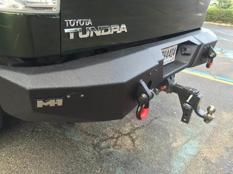

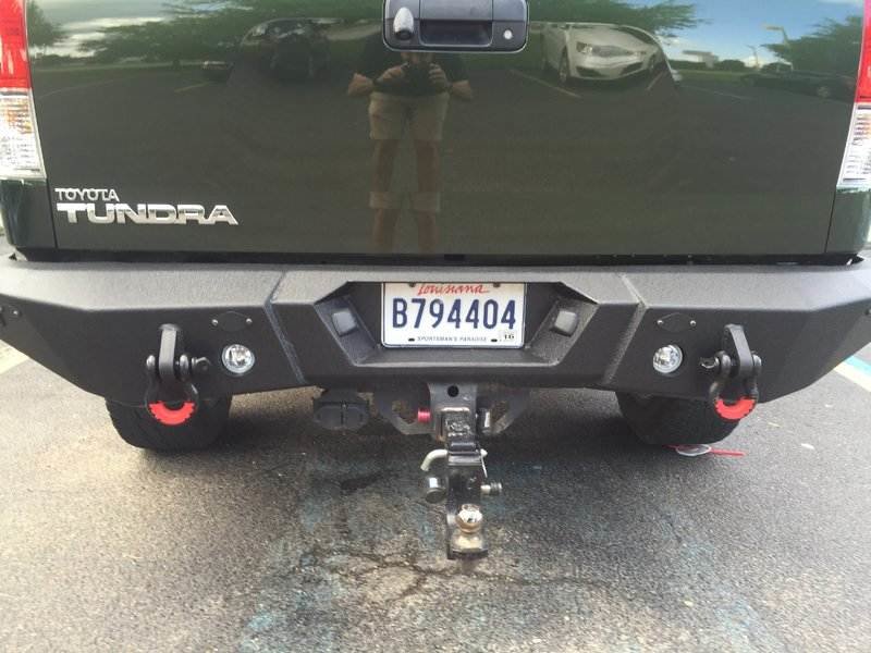

    I GOT HER BACK!

    i also used some of their panel bond to mount my gun holster inside the center console. hopefully that will hold.
  12. Jun 26, 2015 at 4:26 PM
    #102
    42,947
    Very tough looking bumper. Great choice.

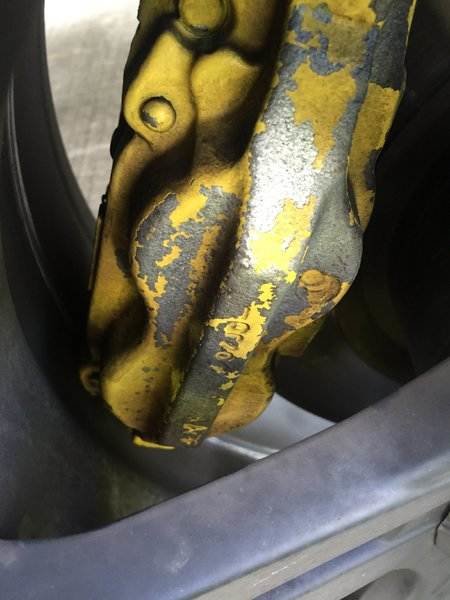

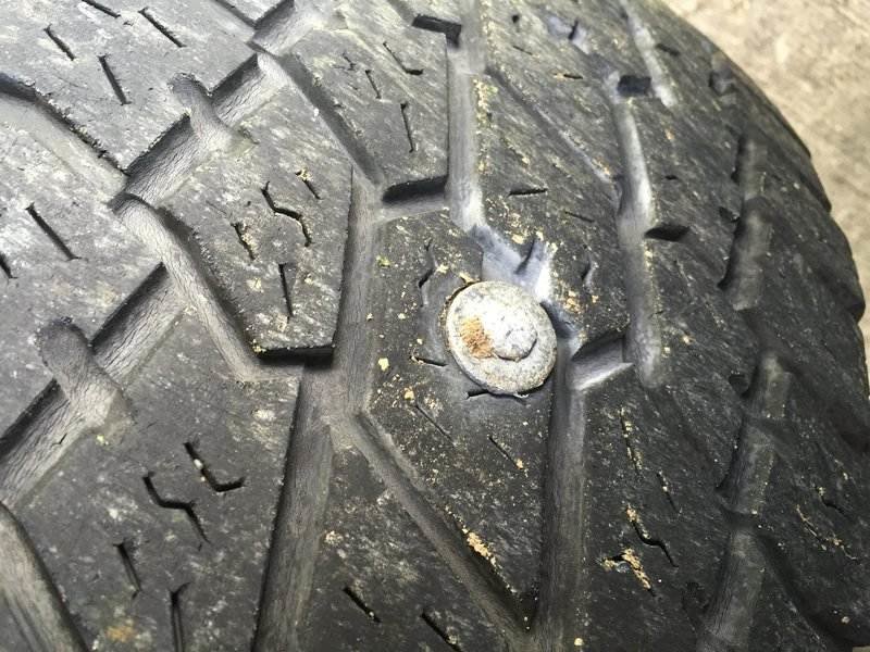

    now this happened.
    apparently the tire picked up a bolt from the shop. and some how the lower bolt on the caliper has come off. causing to rub against rim shake and go crazy when coming to a stop.

    Time to patch that tire.

    yea. im just worried about damage to rim, rotor, caliper....and of course what could have caused that to happen is there some kind of suspension issue or lower control arm or idk.

    No damage I bet. Put in the bolt tight to spec and see what happens. Go for a test drive.

    so we got it fixed up. rim wasnt damaged too bad. it was scratch all the way around but nothing too deep. the bolt looked monstrous from outside but in actuality wasnt that long and didnt puncture the tire. but we went ahead and patched just in case. the lower bolt from the caliper was completely gone. the top bolt was loose. and it was jammed against the wall of the rim. but it was super easy and everyhting fixed in 20 min becase we had the use of the shop lift and all air tools and nice stuff that made it super easy. crisis averted.
