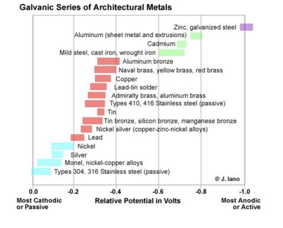

    I am a Mechanical Engineer by trade. I have experienced Aluminum to 304 Stainless galvanic corrosion in automotive and industrial applications.
    I am a seasoned shade tree mechanic who has dealt with his share of stuck, stripped and broken bolts. I live in Michigan :)
    Get those stainless steel bolts out of your transmission or you will be drilling and tapping every one of those holes! You may even end up drilling out every one of those bolts because they will not back out of the hole. It will happen faster than you think if you expose that mix to salt.
    Here is a handy chart. I very rarely use stainless hardware as a result. Not only is it a bad screw material from a strength standpoint but it reacts with nearly every application that would want to use it in. Steel is not much better than Aluminum. I learned this the hard way when I used stainless to attach the license plate to my wife's van. The holes in the plate got really bit and the screws/bolts corroded into the weld nuts on the van.
    Notice that 304 (most stainless hardware) is on the very bottom and aluminum and steel are on the very top. The bigger the voltage potential between the two metals the faster/more they react. The less passive metal (higher up on the chart) will be the sacrificial metal. Your transmission will rot out and the bolts will be just fine.....

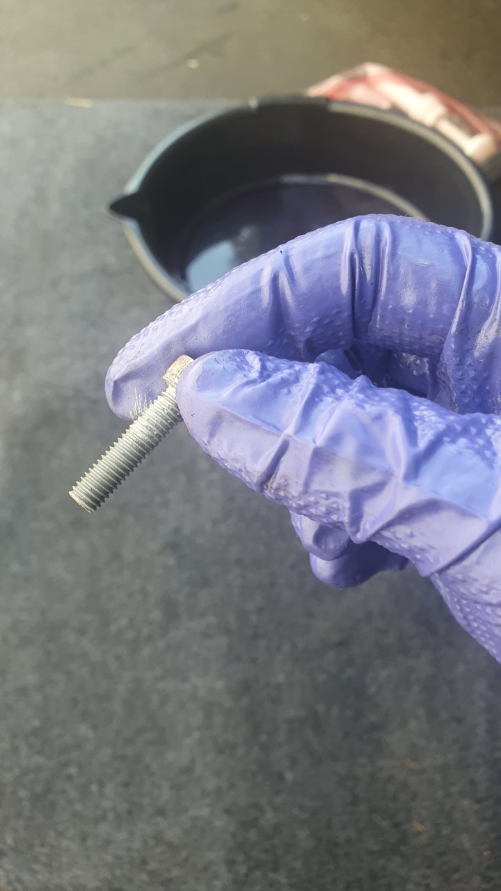

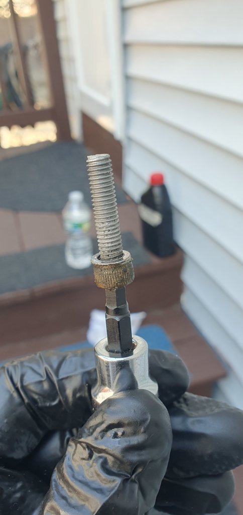

    I just thought I would update everyone on this since it was a lively debated issue. I replaced the bolts and coated them with anti-seize one year ago. Took all the bolts out today and no sign of corrosion.

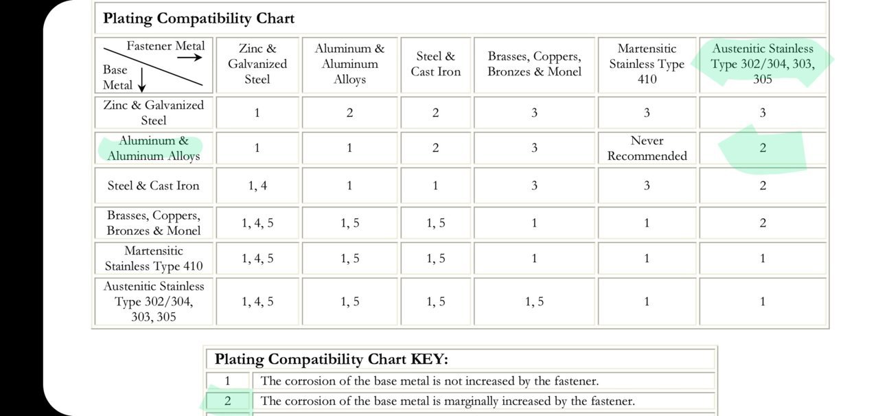

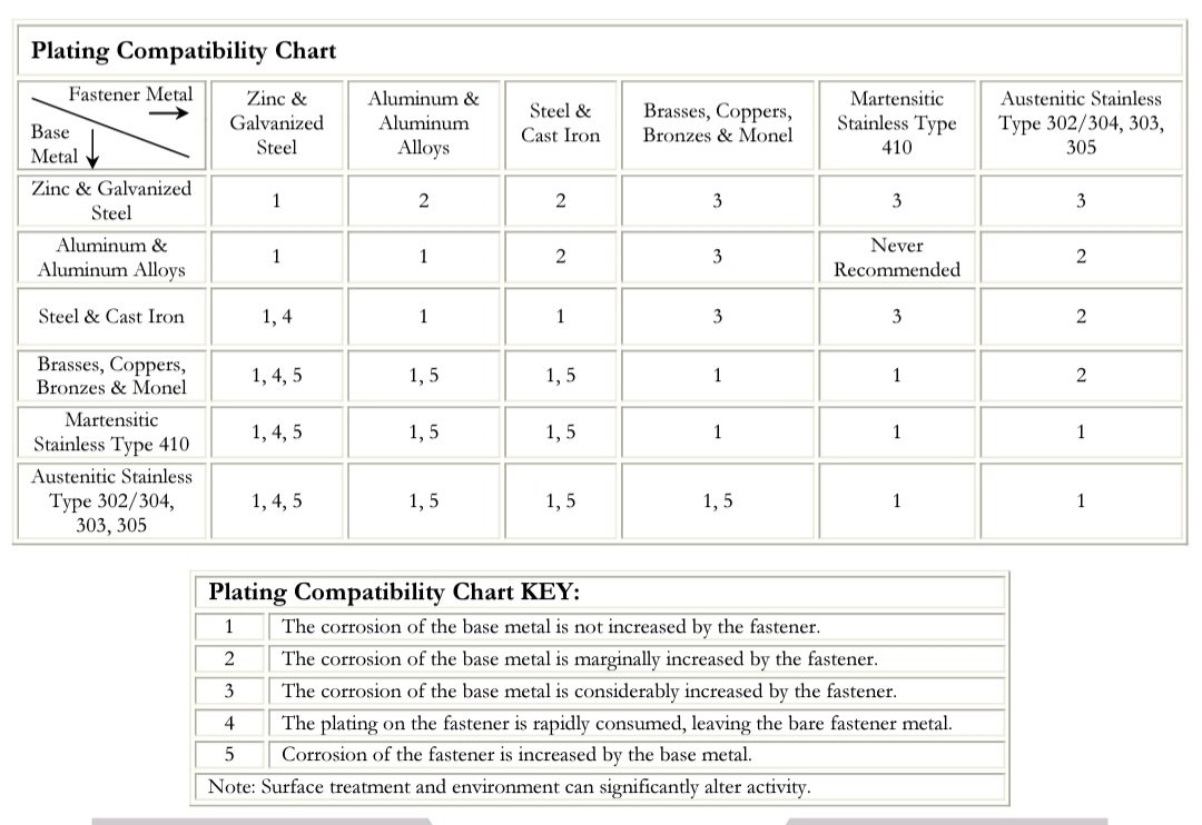

    Wow thanks! This is probably the most helpful thing posted in here. Looking at that chart I am at a 2 meaning "The corrosion of the base metal is marginally increased by the fastener." So I have marginally increased the chance of corrosion but also as stated in the article adding a coating like I did with anti-seize will help negate that. Considering the OEM bolts corrode away into the transmission like crazy I see 0 evidence besides anecdotal naysayers that this is going to be an issue.
    It would seem maybe people in this thread have mixed up what the issue is, if you look at the chart, if you use aluminum fasteners in a stainless base "Corrosion of the fastener is increased by the base metal." But when done in reverse its not really an issue especially when adding anti-seize that is made of aluminum like Permatex.

    This chart is talking about passivated SS. Your bolts are very likely not passivated. Especially if they are nice and shiny.
    Soak them in lemon juice overnight if you want them passivated. They will not look as nice but there will be a nice non conductive passivated layer to help you out.
    Yes, never-seize will help. But it would also have helped the original bolts. So you are not really comparing apples to apples here.
    SS bolt will always look good. That is not what you should be looking at. You need to be looking at the threads in your transmission. This is not an easy thing to do on a hole that small and deep. It will start with some minor pitting. As the corrosion grows you will see some white corrosion of the aluminum. At this point you have a big problem. Eventually you will not have threads left. The bolt will not get stuck, it will just spin in the hole.
    Do what you want.
    If it were mine I would buy a good zinc plated or better yet a zinc flake coated bolt and replace them when they start rusting. Let the small cheap part be the sacrificial member. They are cheap and easy to replace. The transmission is NOT. Yes, I would also use never-seize.
