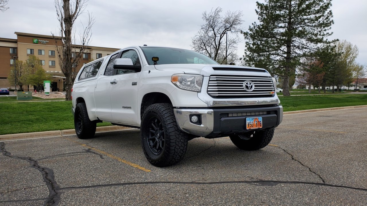

    325/60r20 falken at3w, 2.25 dobinsons ,20x9 +20 fuel torque wheels, leer xr100, bmc
    Still have a little plastic rub, but the bmc clears

    Did you clean up the BMC? Where’s it rubbing in the front?

    Havent cleaned it up yet, hope to do so this weekend. Its rubbing the front fender liner list in front of the tires. Got a fedex notification for my winch bumper so i only need to rock the oem bumper long enough to get it welded up.

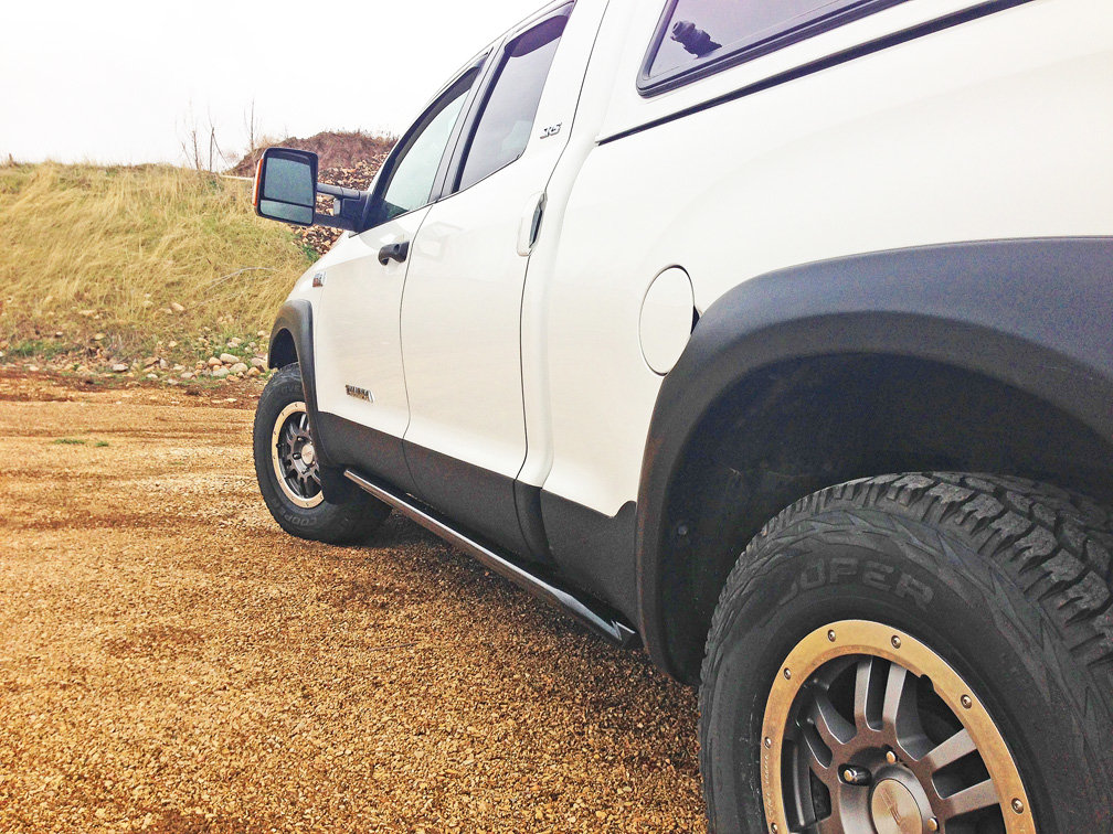

    I also opted for the grille hoop (pictured) and the 40w cree lights , so it could be had cheaper

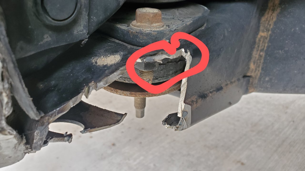

    20220427_121344~2.jpg Do we know if there are any aftermarket body mount bushings for our trucks?? I cant seem to find any , but noticed when doing my bmc mine are cracked and dried out pretty good.

    rruff New Member
    Oct 18, 2021
    #69521
    1,007
    2016 Tundra SR DC Long
    I like the big tires! :thumbsup:
    2" lift with stock UCAs it should be fine. Did you align it? If not, move the rear LCA pivot out all the way and adjust your front one until the camber is good. That's the most caster you can get. Then make sure your toe is zeroed... tires will wear out fast if that's off by much.
    UCAs will move the upper pivot back and in a little. That moves the wheel rearward in the well, also. The LCA cams move the wheel fore and aft also. Just saying, it'll change. I think SPCs are good because you can dial it in better.
    I'm surprised you had to work that hard to make clearance with +20 offset... but your tires are ~.8" bigger diameter than mine.
