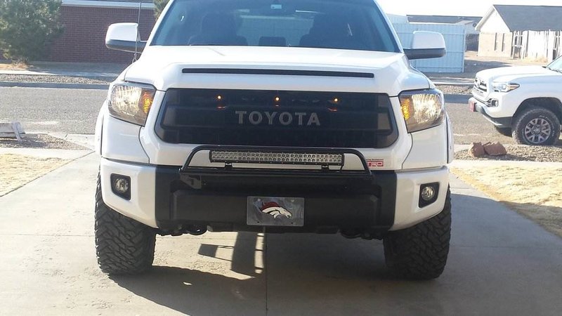

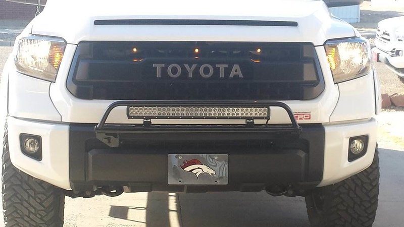

    Just added a light bar and 30" 20160119_155429.jpg 20160119_155410.jpg 20160119_155429.jpg led light

    Looks really good, can you send a pic under the hood of the light setup. Its a nice mod at a good price.

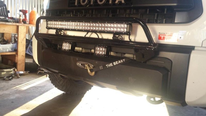

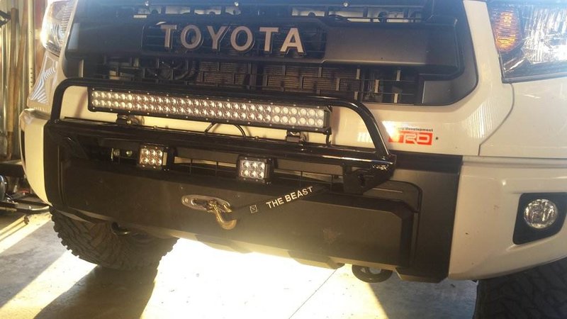

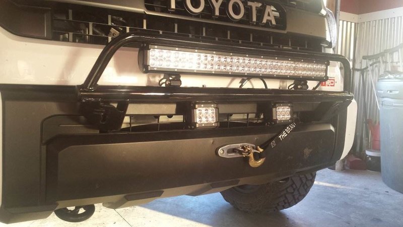

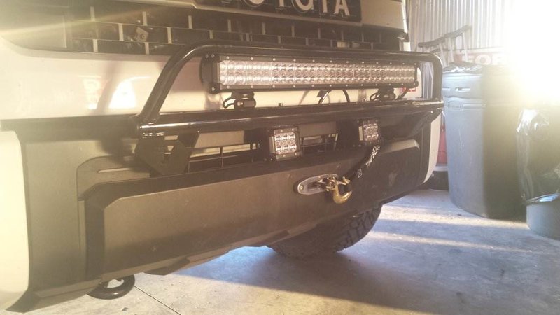

    Added a few lights and winch

    hammer,
    help me out here with some info please. I've been trying to find a fabricator of the hidden winch mount for over 8 months.
    1) who fabricated this for you? Price?
    2) what was the solution for the oil cooler located in the way? and bracing for the fog light corner trim?
    3) how do you access the winch clutch, or is this only activated with a wireless remote?
    Thanks, gosolo

    The winch is mounted upside down on a bracket that runs from side to side on the frame behind the transfer case. It's offset so I had to use a couple of pulleys to route the cable around and center it up in the front. It's not a huge winch....but I'm not planning on burying my truck anytime soon

    You use a little more cable this way you can have a winch without altering the front of the truck
