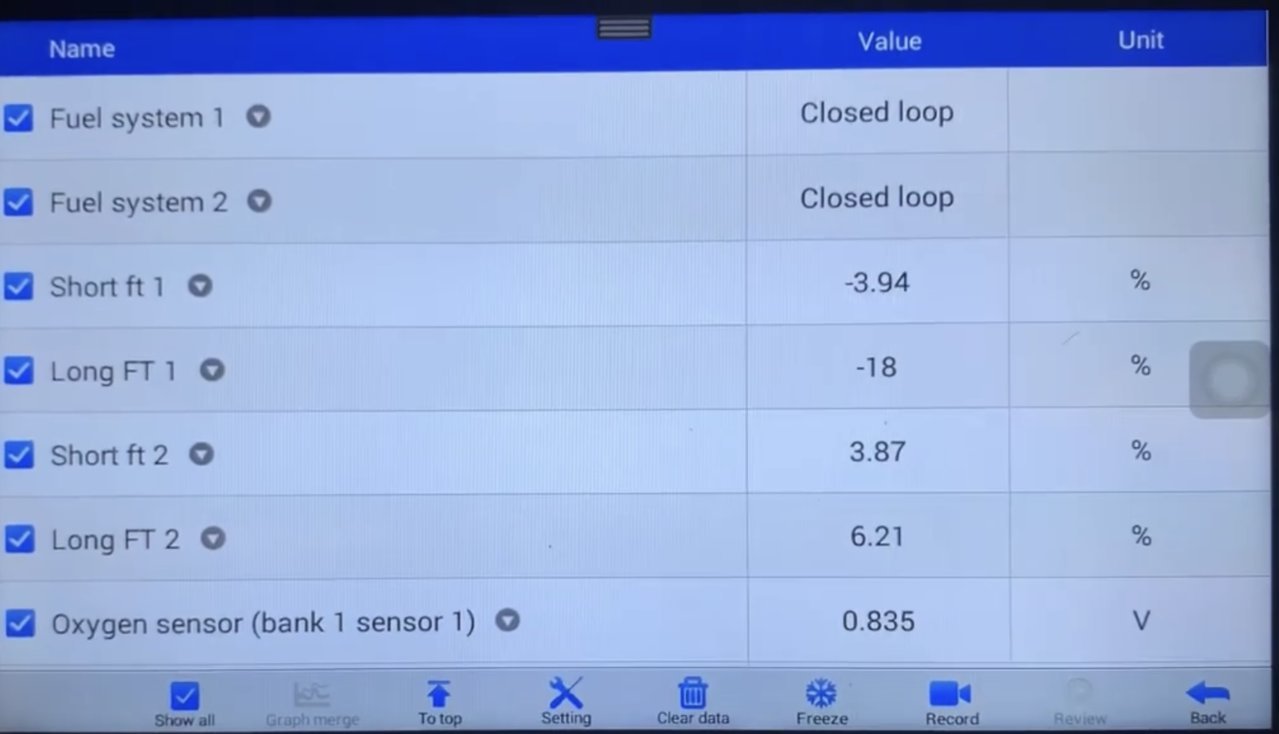

    This data is so confusing to me.
    How can the fuel rims be that far apart from one bank to the other?

    Well, here's my logical breakdown for running rich (and causing negative trim) in general.
    I got these when researching "running rich" causes a while back from the IH8MUD forum:
    Dirty/broken/damaged MAF (I know you're not supposed to touch them, like, ever while cleaning - only use spray pressure from the cleaner can
    Higher than normal fuel pressure
    Damaged fuel pressure regulator diaphragm
    Broken evap stuff
    Bad O2 sensor
    Coolant temp sensor (running rich if ECM things engine is still cold due to incorrect sensor reading)
    Exhaust leak (before the O2)
    Camshaft timing
    I know you beat the timing thing to death (and many of the other issues above too), but maybe worth looking at the offending cam's sensor interface?
    Maybe there's some schmoo in the hole where the cam pos. sensor goes in, causing issues?
    I can't remember if you've replaced that cam sensor. If it's hard broke the truck shouldn't start at all. But if there's a signaling issue, it could cause fuel problems in one bank.
    Check the signaling teeth on the crank pulley for dirt and stuff. I know if one tooth is bent even a little it can cause incorrect timing signals, and when the ECM sees a crank timing mismatch it will look to the cam sensors to identify the source, which could lead to one bank misfiring, because the ECM is trying to adjust timing for incorrect signals.
    Do we know that the fuel pressure regulator for that rail is good?

    This one I can answer. The bank 1 fuel trim is -18 because the O2 sensor on that side is sitting at around .835 volts.

    A reading of .835 is not in and of itself necessarily a bad reading. The picture above is simply a snap shot at that moment in time. Front O2 sensors or more correctly Air/Fuel Ratio sensor will go from approximately .8 vdc(rich) to .1 vdc(lean) and resembles a sign wave as was mentioned back in July. There function is to attempt to maintain an air to fuel ratio 0f 14.1:1(stoichiometric). It's best when troubleshooting those is to have a tester that will graph the sensor.
    One of the many videos Brynden has posted over time showing his front sensors are oscillating correctly at approx .8 to .1 vdc.....
