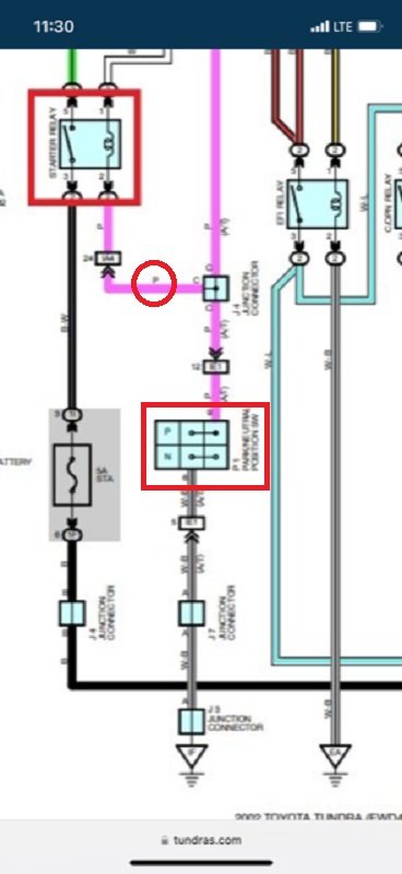

    In the pic below, notice pin 2purple wire, of relay coil goes thru Park/Neutral Pos Sw I mentioned earlier, it is pin 2’s path to gnd. Not saying it’s a Park/Neu Pos Sw problem but you mentioned ealier about no light imdicator for Park ? I’m out shopping, far as I can go.,..good luck

    Sorry, trouble uploading from phone. That's what I was trying to explain above. Relay Gnd path is via Park/Neu Pos Sw.

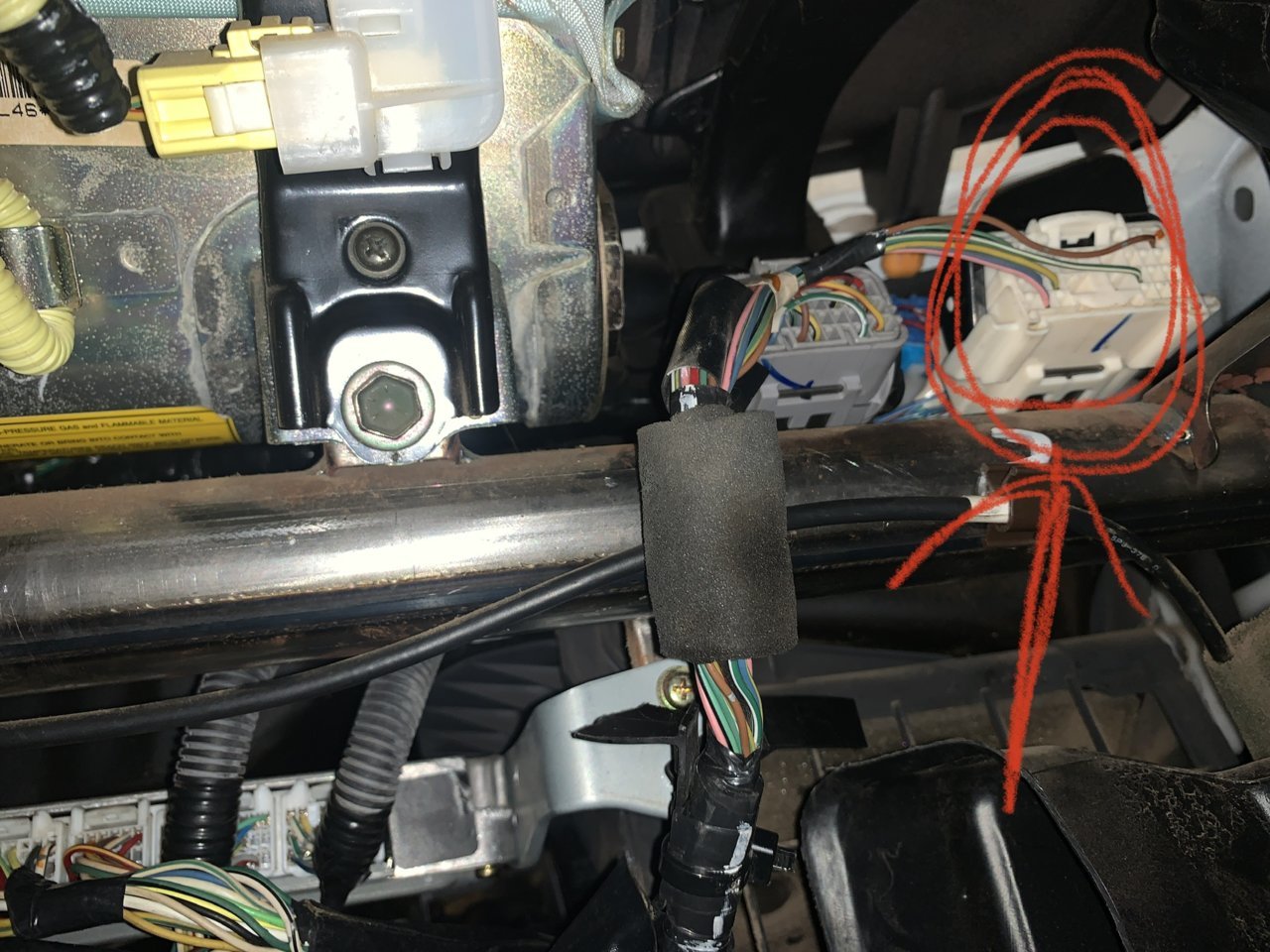

    Can someone with a similar year truck as mine check something for me? I noticed this morning that when I turn the key to the on position there is a whining noise from the throttle body. When I unplug the connector at the top of the throttle body the whine goes away. Is that normal? I might just be more sensitive to electrical noises right now.

    Just stepped out and checked mine, yes, its normal, or at least mine does it too.

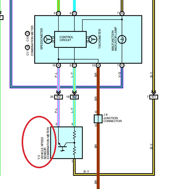

    Well, some good news. After researching the speedometer issue I found someone that mentioned one of the connectors by the ECU has a dual lock on it. I went and checked and sure enough, it was not connected all the way. I connected and my Speedo and odometer work and my AC works now too. Unfortunately I still have the misfires, but I will take the win.
    here it is in case anyone has the same issues:

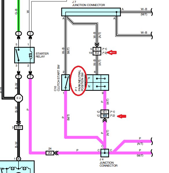

    I looked at the EWD and it looks like that is the IE2 connector. How do I find out what goes through that connector?

    That's the fun of the EWDs. Just hitting CTRL + F (or CMD + F on Mac) will let you search for "IE2" and it'll put you on each page containing it.
    The downsides are plenty:
    • EWD isn't color-coded - at least the'06 one isn't, it's aggravating - so you need to pay attention to the capital letter abbreviations to know the wire color (there's a key code somewhere in the EWD)
    • Some of the EWD actually have a weird space, so searching for "IE 2" may give different results from "IE2"
    • The different cab types are in different sections and have different wiring, both colors and quantities, so you really need to watch the page title carefully!
    • It's not remotely clear what the purpose of the wires are, whether they have voltage, etc. in many cases, you have to trace back to the origin
    • Relays, switches and other things aren't remotely labeled clearly IMO
    EWD are here if nobody linked already.

    Oh, and in looking at the '02 EWD, I understand now why that connector being loose affects P/N switch and the tach/speedo.
    You may just want to fully unseat then re-seat that connector and see if it subsides. Note the white boxes on the lines coming out of the top and/or bottom of the modules I circled showing "IE2". The number to the left or right of the white rectangle is the pin position inside the connector.

    From my searching it appears that the P/N switch actually runs through the IE1 connector (the grey one in my picture). That one appears to be double locked but I am going to reseat it to see what happens.

    It's also a connector that is part of the path for the gnd to pin 2 of starter relay that you've had problems with.
    As shifty alluded to, EWD's can be daunting and makes good points about watching the headings.....2UZ vs 5VZ.
    The upside is you only populate the IE2 connector with about a third of what it actually holds. Most that I checked deal with what you have had errors on.

    Yep. IE1 and IE2 appear to plug into each other. Look at the 2nd pic I posted with the purple wires. Note the arrow pointing to IE2. Note what IE2 is plugged into ... IE1.

    WAIT - nix that. I just noticed there's an asterisk next to one of them. That usually is an indicator you need to look on that diagram page to see their footnote. It may be there's two diff't configs depending on model/engine/cab/whatever.
