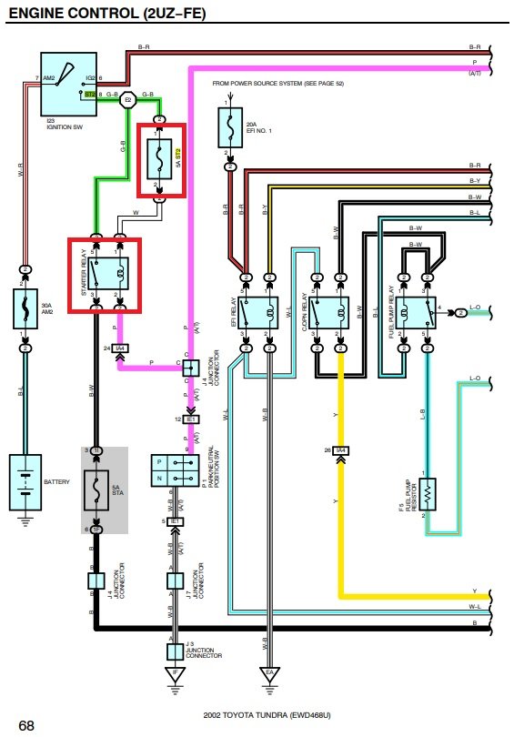

    There should be a 5 amp fuse in Engine Bay labeled ST2 that protects the starter relay according to 02 EWD.

    With ignition on and the engine off, the 5 amp fuse has no power to it. As well, the relay has no power to it. Should it have power?

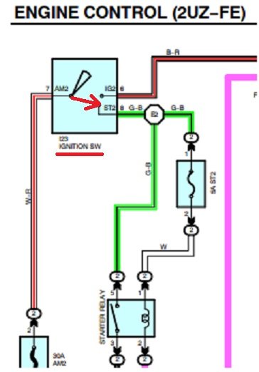

    You will not have 12vdc to fuse nor the starter relay until you turn the Ign Sw to the Start Pos, labeled ST2 on the drawing with red arrow. You'll have to position your meter as you sit in truck to check voltages while turning key to start position. With ignition on/engine off, the pointer would be at the IG2 position as seen on drawing.
    KNABORES, Brynden29[OP] and shifty` like this.

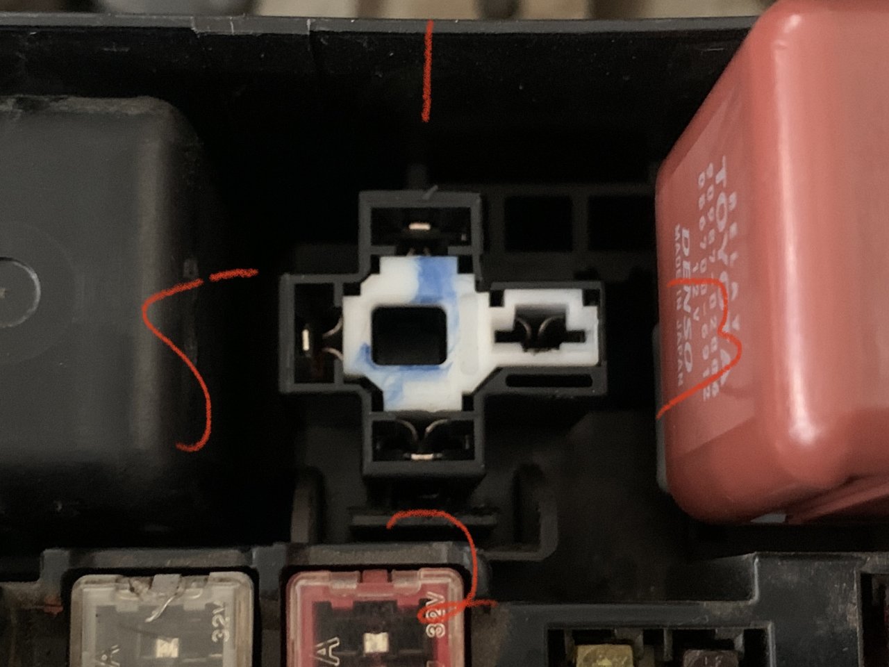

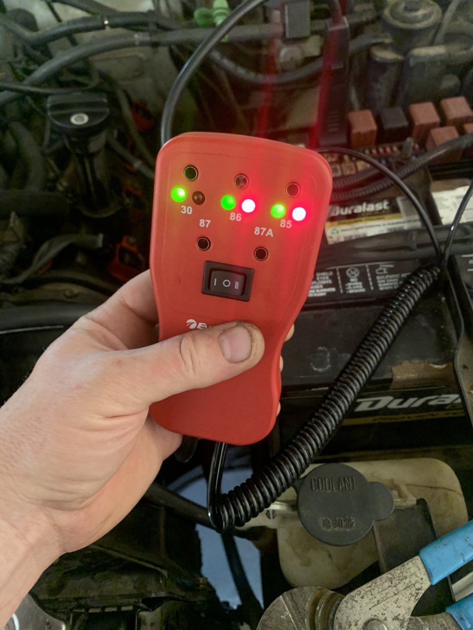

    B33740D6-C1FB-488D-95B8-278108E01AF2.jpg So I rented a relay and circuit tester and it appears that I have a circuit fault when testing the starter relay. I have no idea what that means. Apparently both lights should not be illuminated at the same time on a given circuit. Any ideas?

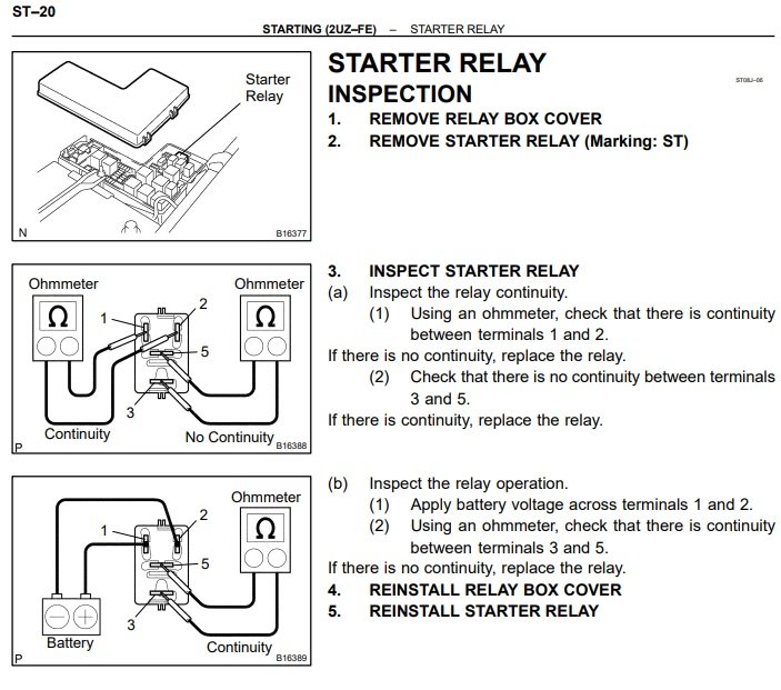

    Can't help you with that tester but if you still have that volt ohm meter that you used a number of pages back, perhaps test the relay with it !
    Terminals 1 and 2 are the relay coil which is nothing more than a long ass piece of wire and if if you have continuity, relay coil is good !

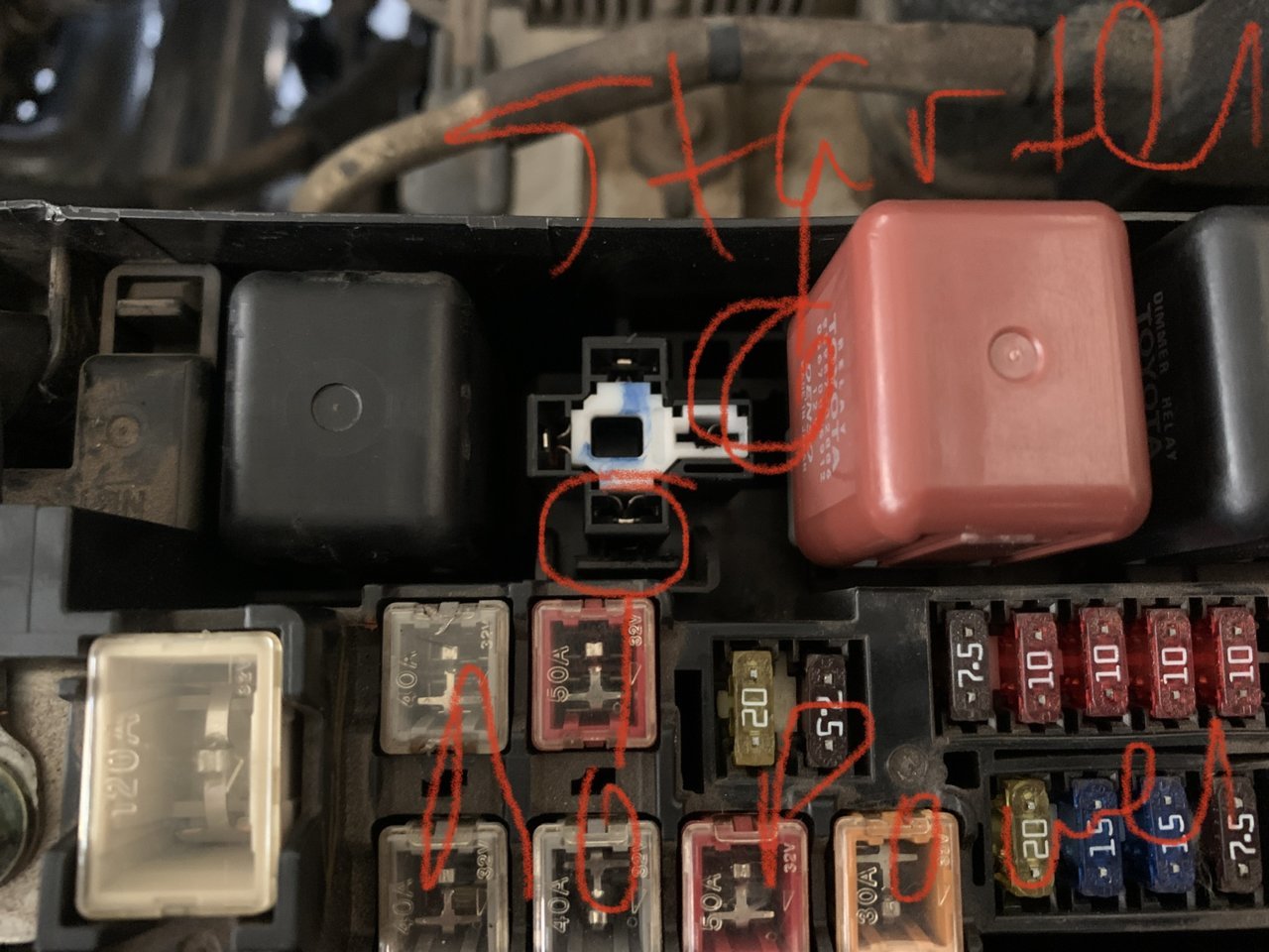

    So, it’s not the relay. The plug that goes into the relay that is supposed to go to the starter has no power when I try to start it. What feeds that one?69899744-1907-4D37-8BBA-CE3998AA95E8.jpg

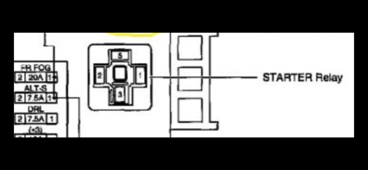

    What you are showing as pin 2 should pin 3 and the pin across from what you are showing as pin 1 is pin 2. Those 2 are the coil and should show continuity. Pin 3 and 5 ate the relay contacts.
    Is there not a drawing on top of that relay ?

    Is this correct?

    When I check pin 1 and 2 it shows 76 ohms. Is that correct?

    So when I try to start it, I have power at pin 5. The ST2 fuse also has power when I try to start it.

    Out shopping but 3 and 5 correct.
    1 and 2 may be right but you’ll know which one 2 is since it is gnd. Meaning if you check pin 2 to gnd with your meter for continuity, you’ll know. Pin 1 has voltage when starting if fuses are good along with your Park/Neutral safety switch

    So I just jumped across pin 5 & 3 with a short wire and it started. I just checked and pin 1 has voltage when trying to start it. Maybe pin 2 ground is not correct?

    Pin 2 does not have continuity to ground. I’m not sure where that is supposed to ground to.

    I grounded pin 2 to the chassis and it fired right up. Apparently I have a ground issue. I don’t know where to begin looking for that.
