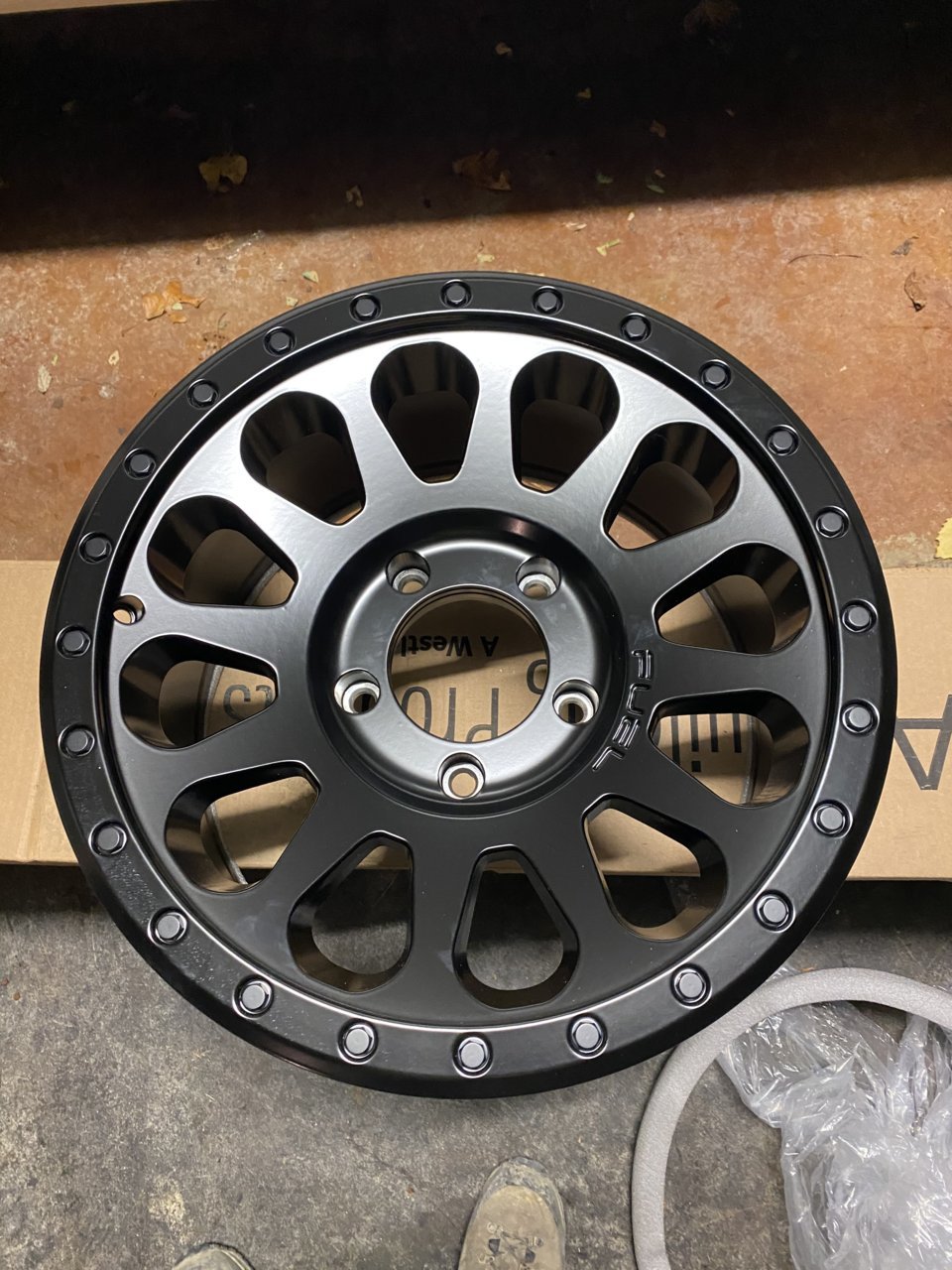

    just got these tonight so now I’m chomping at the bit !!!

    Not sure why the rims from my 14 got in there lol

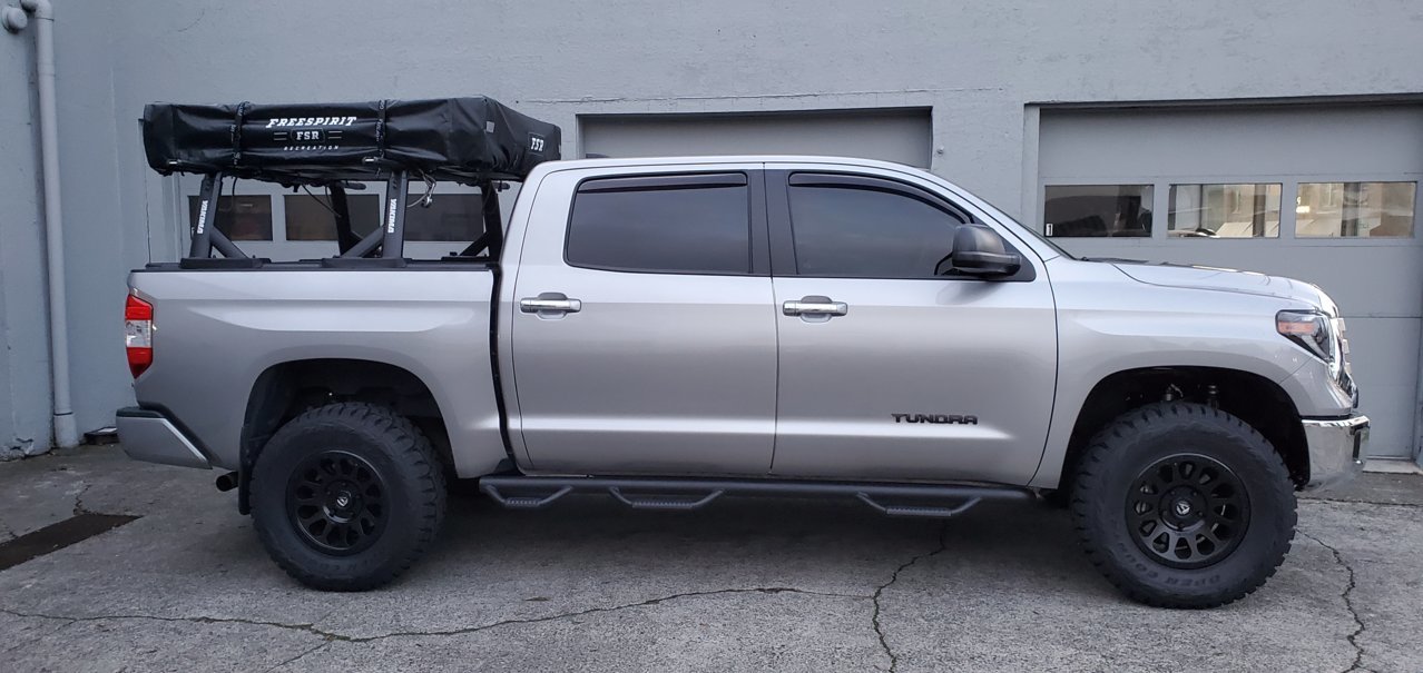

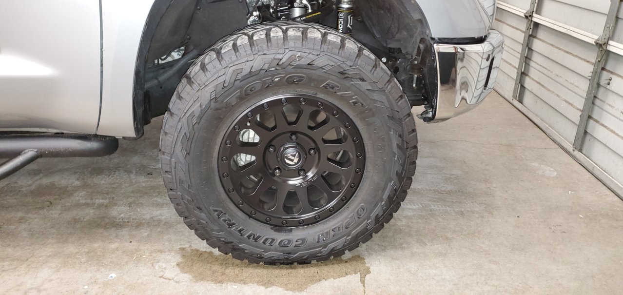

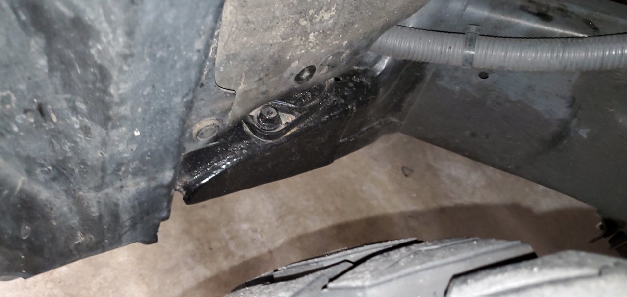

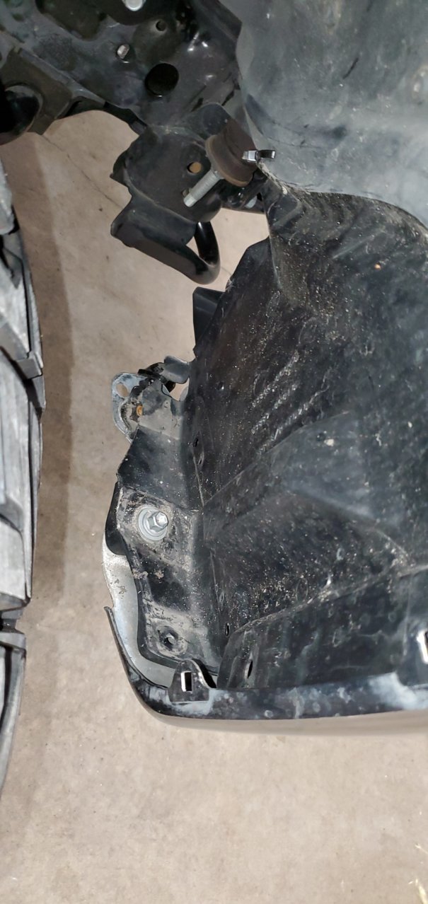

    I removed the front bumper liners, trimmed them down, swapped sides and reversed them to cover the fog light housing. No rubbing. Worked out pretty well, I think.20201011_222425.jpg

    Those are 35/12.5 ?
  15. Nov 9, 2020 at 6:33 PM
    #45
    GMonet
    GMonet New Member
    Mar 8, 2020
    #43701
    22
    G
    '20 Silver Sky
    Yessir

    When I did the test fit there was no rubbing on the Body Mount, but that was while it was stationary. I figured once I'm out wheelin, it would rub. I had it done and I'm glad to have the extra space.

    3-1. Leveled out pretty nicely.

    Thanks, Broham.
    I went with Icon 2.5 Fronts w/remote res, Tubular UCAs, Icon 2.5 rear piggy back with Dampening Adjusters, and Icon's Add-a-Leaf. I will be upgrading it to the Multi-Rate Expansion in the future for greater adjustability while hauling on the trails.
