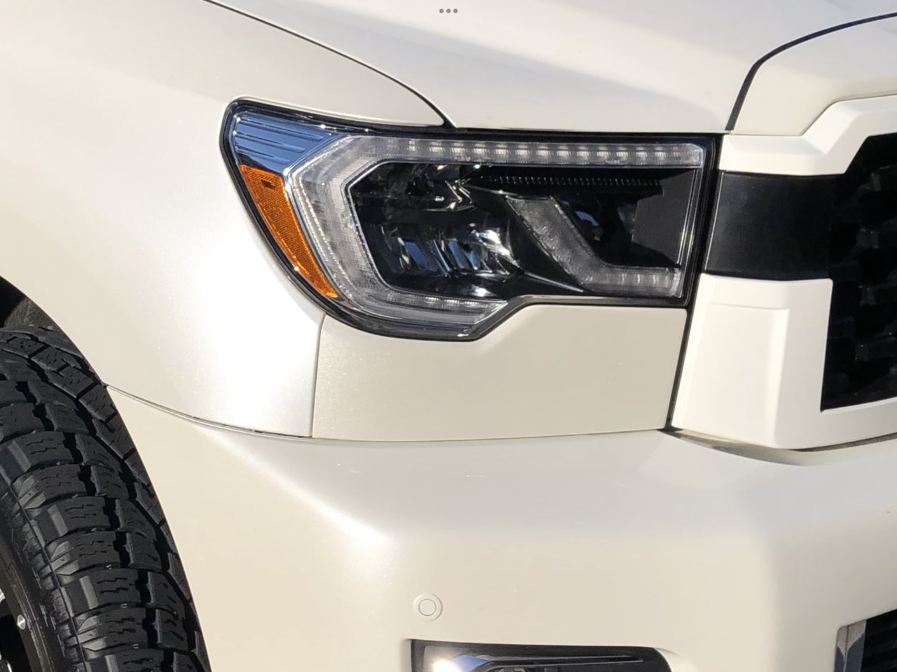

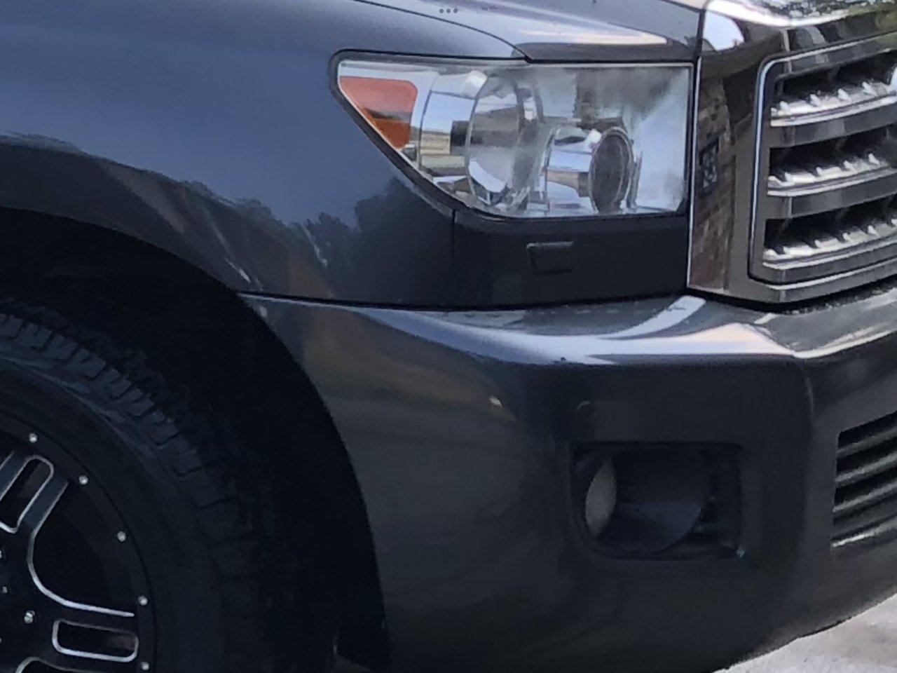

    I'm not sure if anyone has upgraded to the newer headlights, but you’d have to also swap out the garnish under the headlights. They are shaped differently.
    2012
    2019
    You’d also have that useless headlight sprayer / washer to contend with if yours has them.

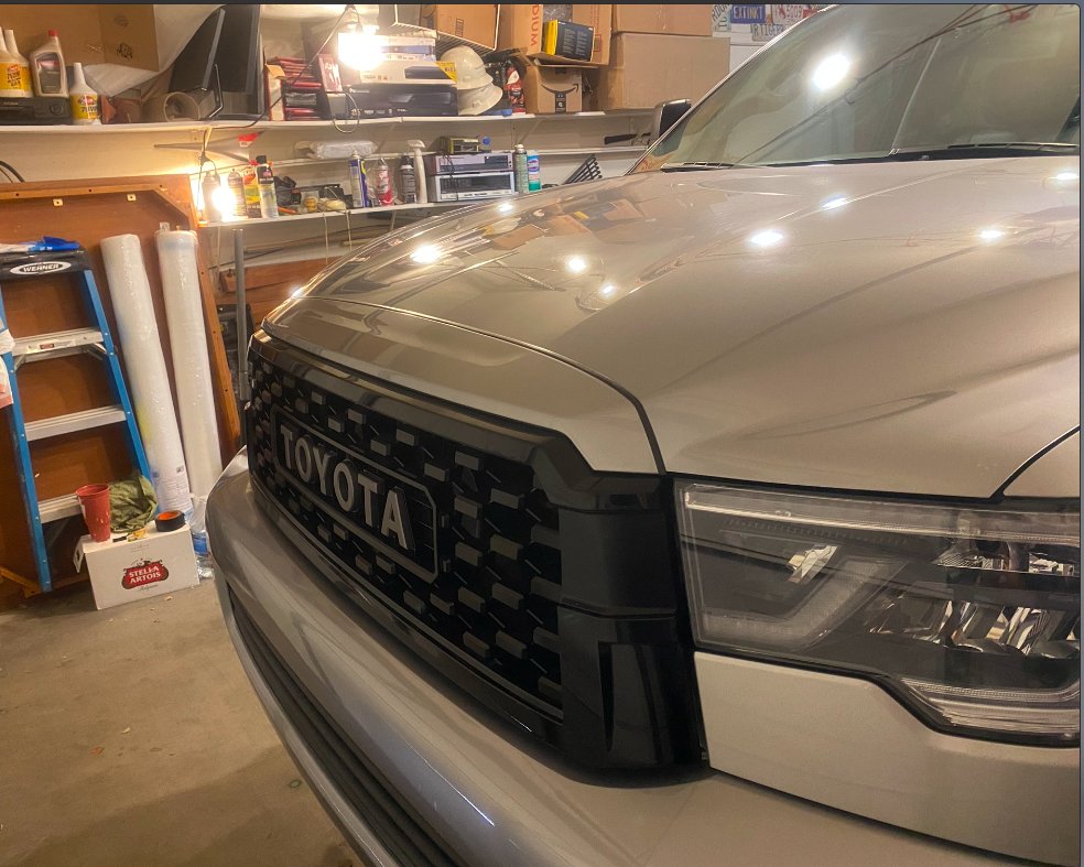

    I have the new headlights, (and black PRO grille & silver bulge) they are available with patience for about 350 each on eBay & the harness is 110 or so. I love them!

    looks great-
    -with the harness was it plug and play?
    -was it xrunnerdudes harness?
    -i noticed broken tabs on a lot of the used ebay ones, did yours have that, and if so did it effect the mounting at all?
    thanks

    Xrunner's harness is plug & play (you have to remove a fuse, plug in the harness there) replace the fuse to the connector provided. On my Tundra I had a broken tab that did not matter, on the Sequoia I was able to find a pair that were intact. Under Platinum trim, there is a black garnish, Platinum is silver. I did not know & had a mixed set on the Tundra, I ended up with a silver "extra" which was ok as it's in the Sequoia now and I just waited to find the second one.

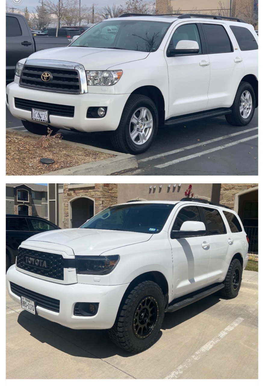

    Another option is the morimoto put them on the wife’s sequoia we’re happy with them

    trdwillie, truck looks sweet.i like the morimotos too, they are both nice..
    what rim width and offset on those wheels?
    what tire size?
    any lift?

    Hey truck is method 701 zero offset on Mickey Thompson’s baja boss on 37s
    wife’s is method 305 plus 25 offset 275s on 18s baja hybrid Cant recall the name.

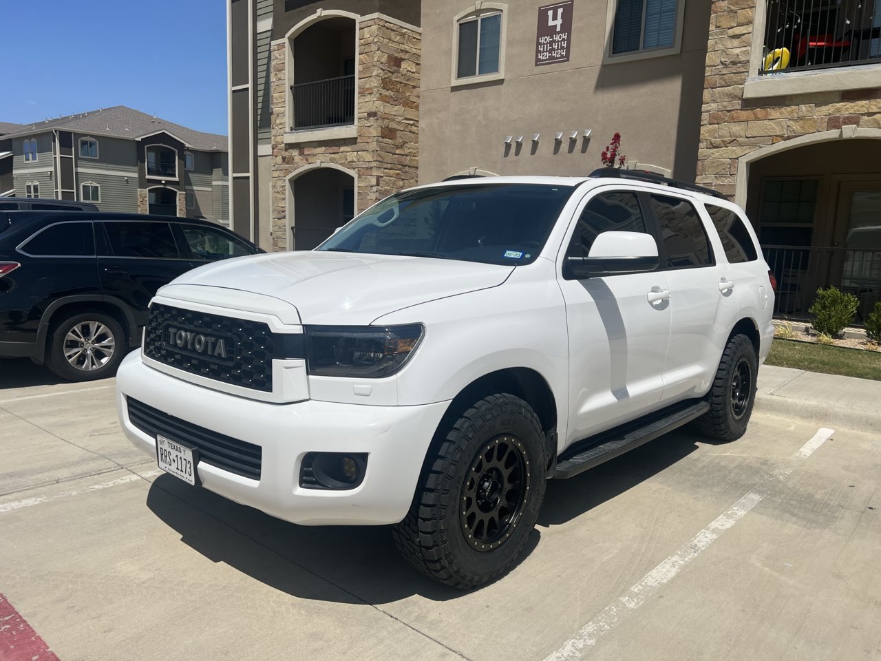

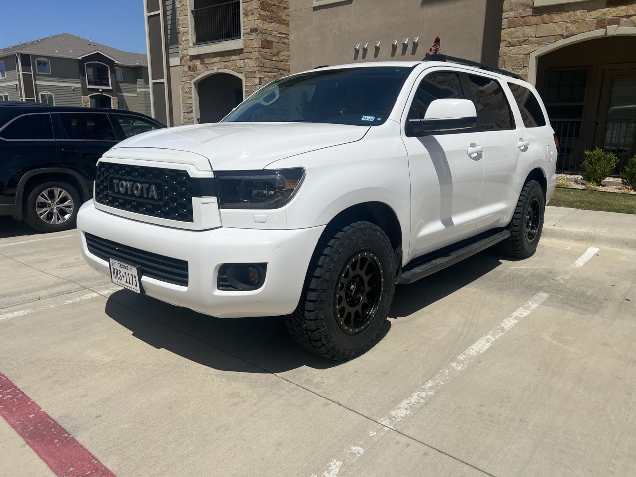

    looks great, on the sequoia did you convert the grill from the old 2008 style to the TRD pro?

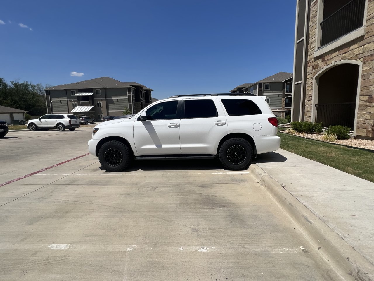

    Did the grill headlights fogs tint and gun safe
