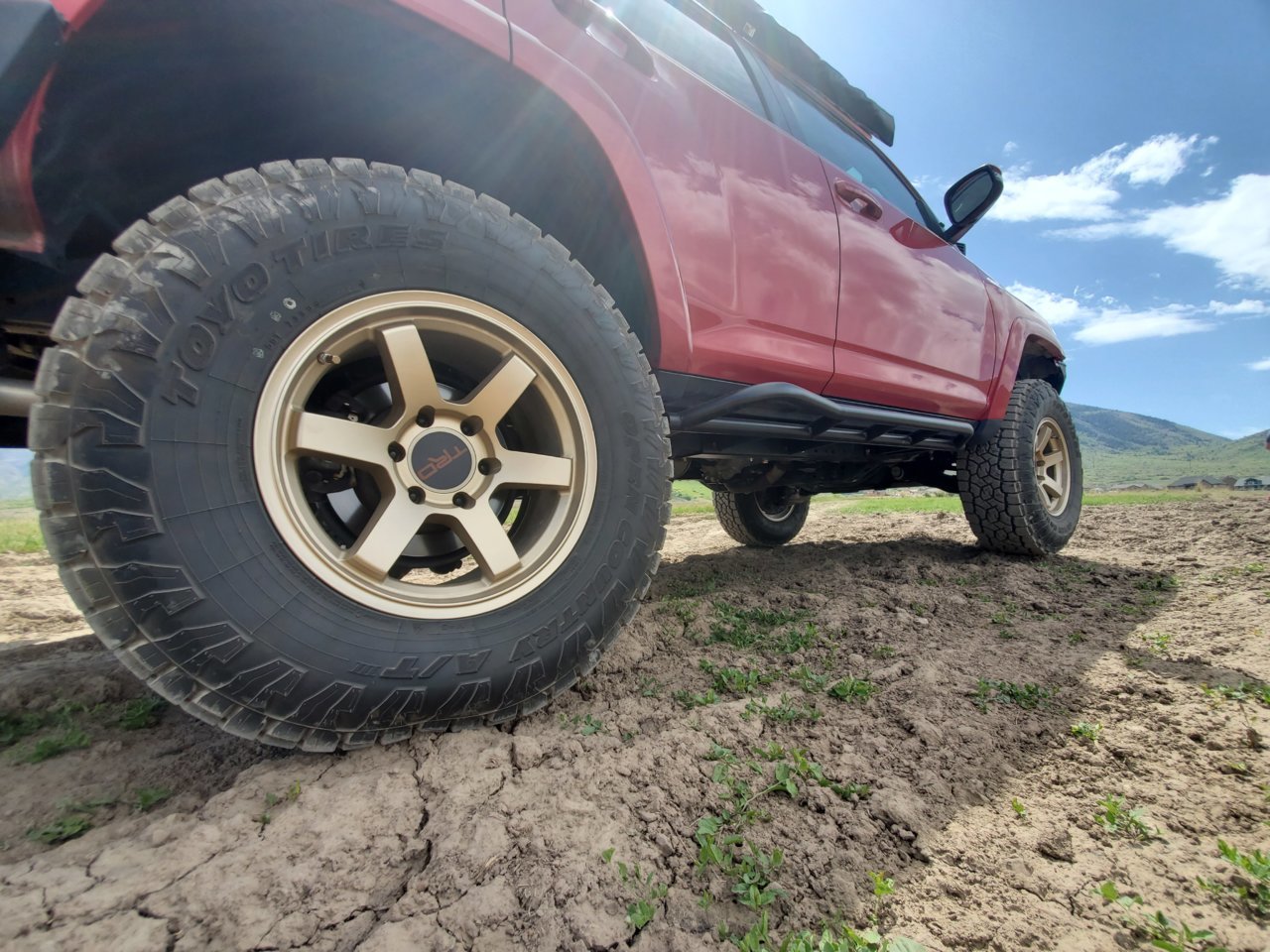

    Tooele, UT
    2022 GMC Sierra AT4 L5P - 2017 4runner SR5P - 2023 Tesla Model 3 LR
    Got these DOM sliders from Caliraised. Coated beautifully by Amped Coatings in Tooele Utah. Been installed for a few days but just had the chance to go for a drive to make sure the front bumper isn't rubbing when working the suspension.
    20210516_114546.jpg 20210516_114401.jpg 20210516_114624.jpg 20210516_114656.jpg
