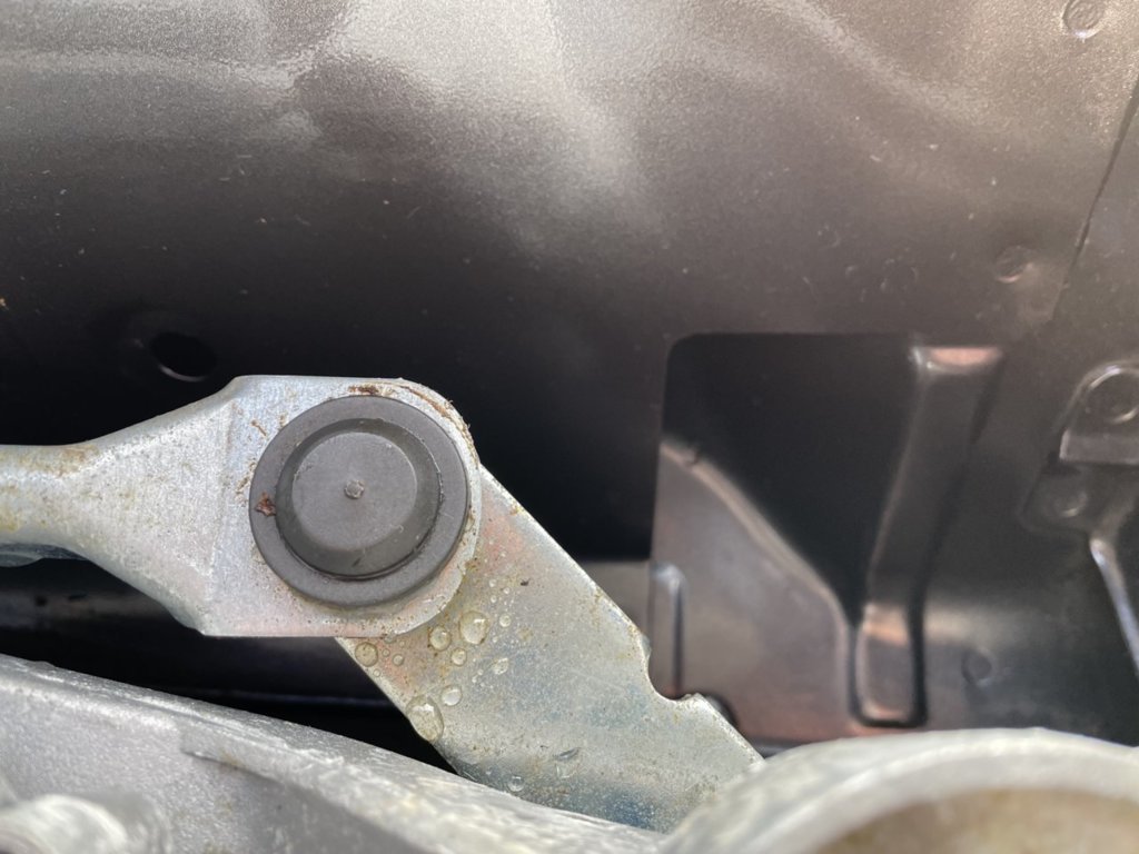

    Anyone still get mice after doing this job? Where else do they get in?

    Did you screen all the holes in the firewall? I missed the one behind the wiper motor the first time I did it.

    Yup. I got all 3. It may be possible I trapped one and now it’s dead somewhere. But I don’t have a smell

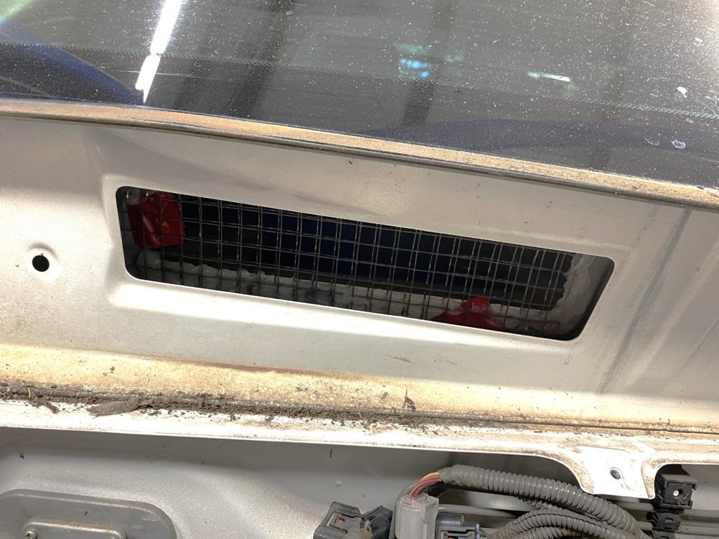

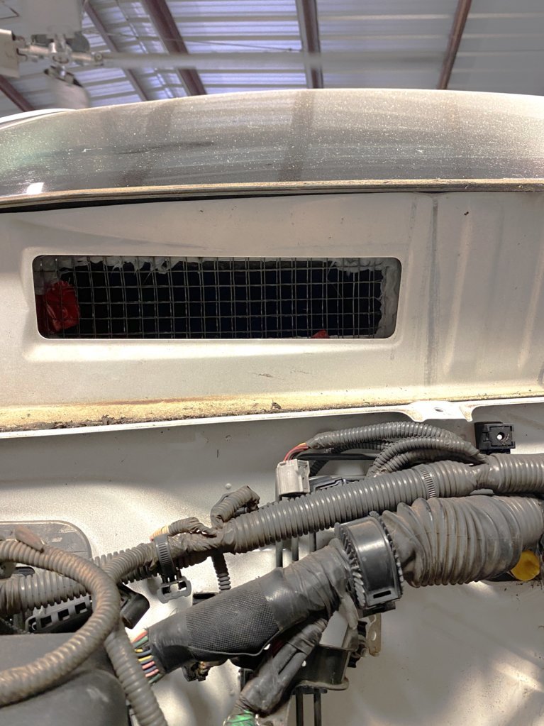

    I put hardware cloth over the HVAC openings under the cowling. Pulled a nest out and vacuumed the area. I installed a sonic deterrent in the engine compartment and the cabin. I hope this helps. I haven't noticed any wiring damage.

    There was evidence that rodents had made their way to my cabin filter while the truck sat idle waiting on a heart transplant, so I took advantage of the time the motor was out of the truck and sealed off the air intake hole on the interior side above the cabin filter. There are many points of entry in the bulkhead on the motor side and as far as I could tell, all of those other openings lead to this single air intake.
    I reached in and set a flat section of mesh screening in front of the opening and then place a larger piece that I had coiled up so it would fit through the opening over that letting it's spring tension hold both in place I used some red tape and silicone sealer to hold the 1st piece in place while I uncoiled the 2nd piece over it.
    My cabin filter has not been visited by rodents since I did this.

    Be aware! As a builder, mice can get through 1/4" screen mesh wire. Seems like gutter guard is smaller and will work better. I tried 1/8" screen mesh over the intake air filter cartridge inside the truck and they still get inside. I think pressure air vents, to relieve air pressure from air tight doors, somewhere, are the culprit. Anyone know where these air vents could be? Perhaps with a rubber flap over it as a kind of one way valve? Sorry, updating profile: 2019 Toyota Tundra SR5
