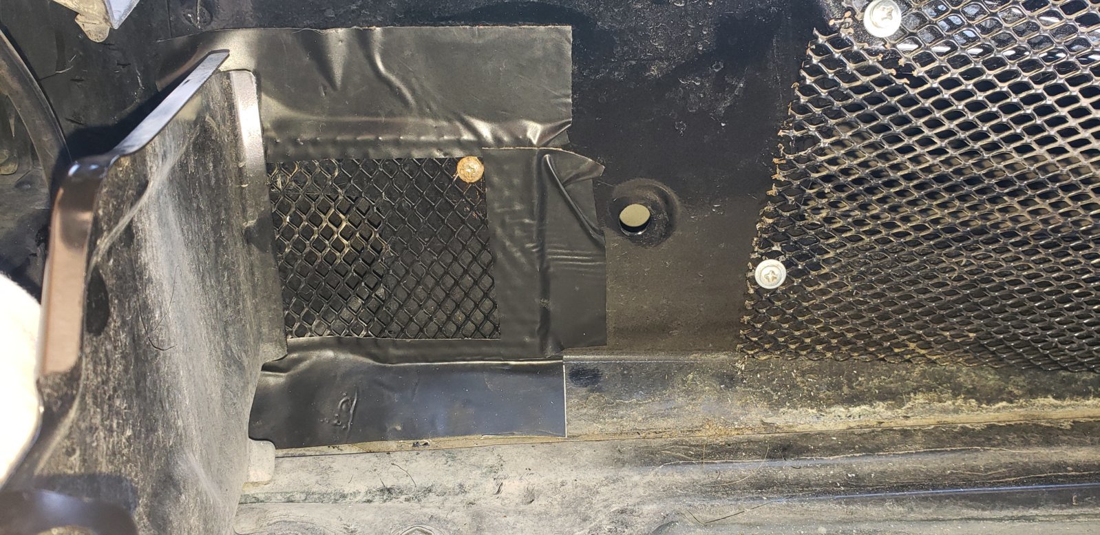

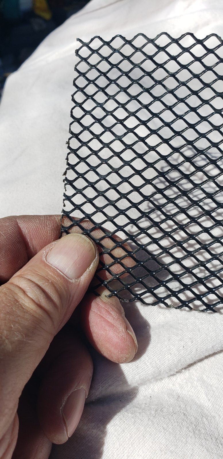

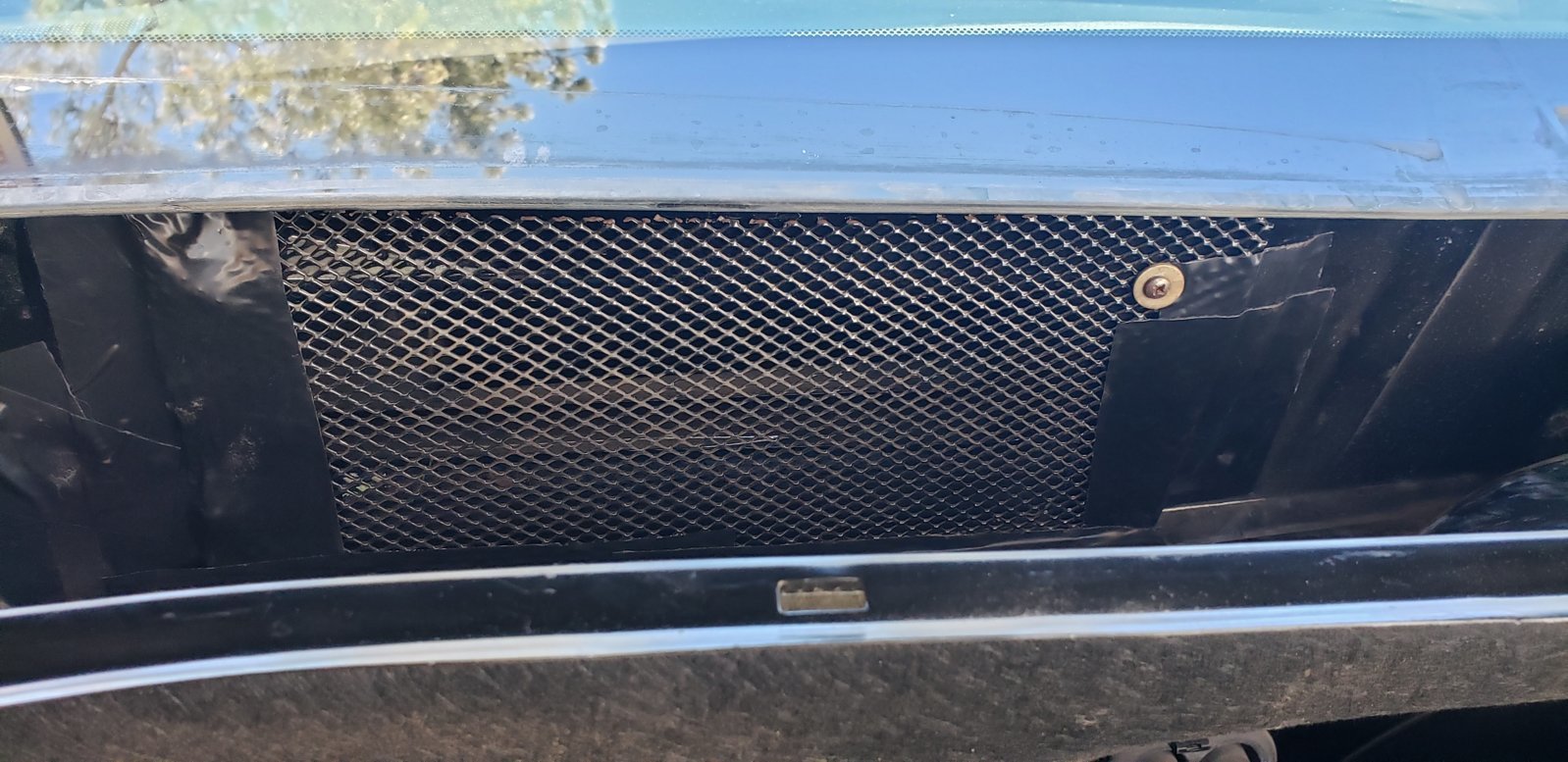

  12. Mar 20, 2024 at 5:49 PM
    #42
    metalsideup
    metalsideup New Member
    Jan 18, 2019
    #24711
    12
    Ironically, I screened my HVAC and 2 other holes under the cowl today. That nest material in the op's pic may have come from the under-hood mat, the one attached to the hood. The sophisticated mice I dealt with were scrounging the felt material between the mat skin and hood. You couldn't tell by looking.
    Anyways, I suggest everyone who lives in mouse country take the time to screen these openings. Mice have a direct path from the engine bay to the cab, and they are lured by the various aromas coming from the interior...air fresheners, dropped fries, crumbs, stashed energy bars, etc.. My education started when I noticed several kleenex sheets at the top of the box were shredded. My investigation led to the cab filter which had a large nest on one side, and most of the pleats of the other side were gone, being part of the nest.
    I found the cab filter air vent and screened it. There are 2 other holes, 1 next to each hood hinge. The screening I used is sold in 1x2' sheets @ HDepot.
