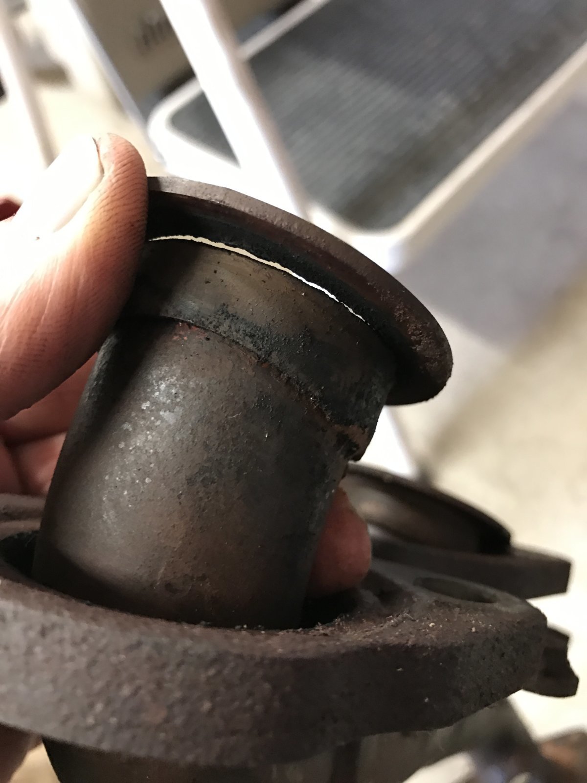

    Source of the infamous exhaust tick on these. Flange separation from the manifold tubes.
