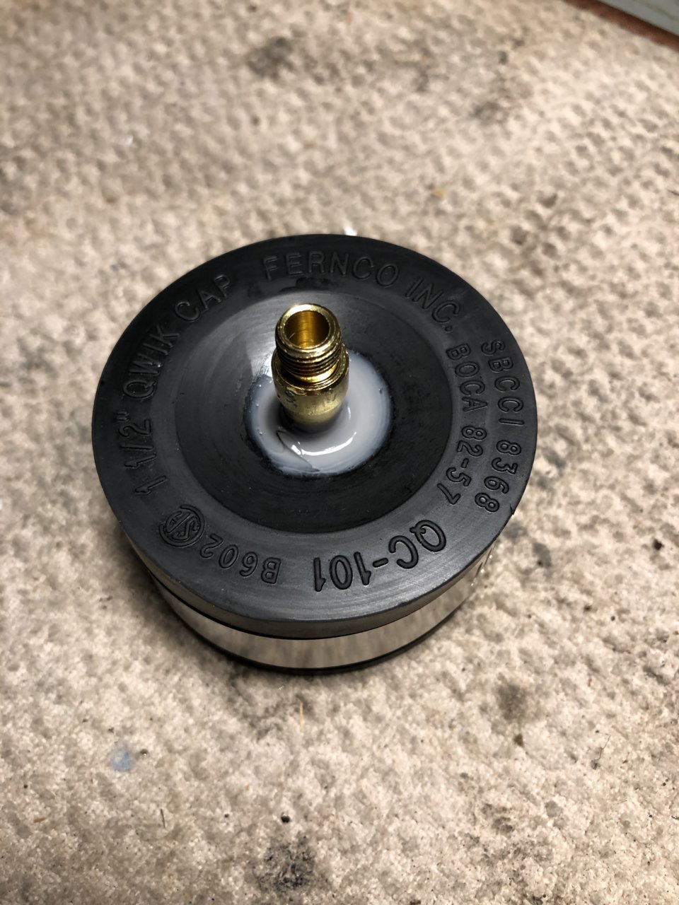

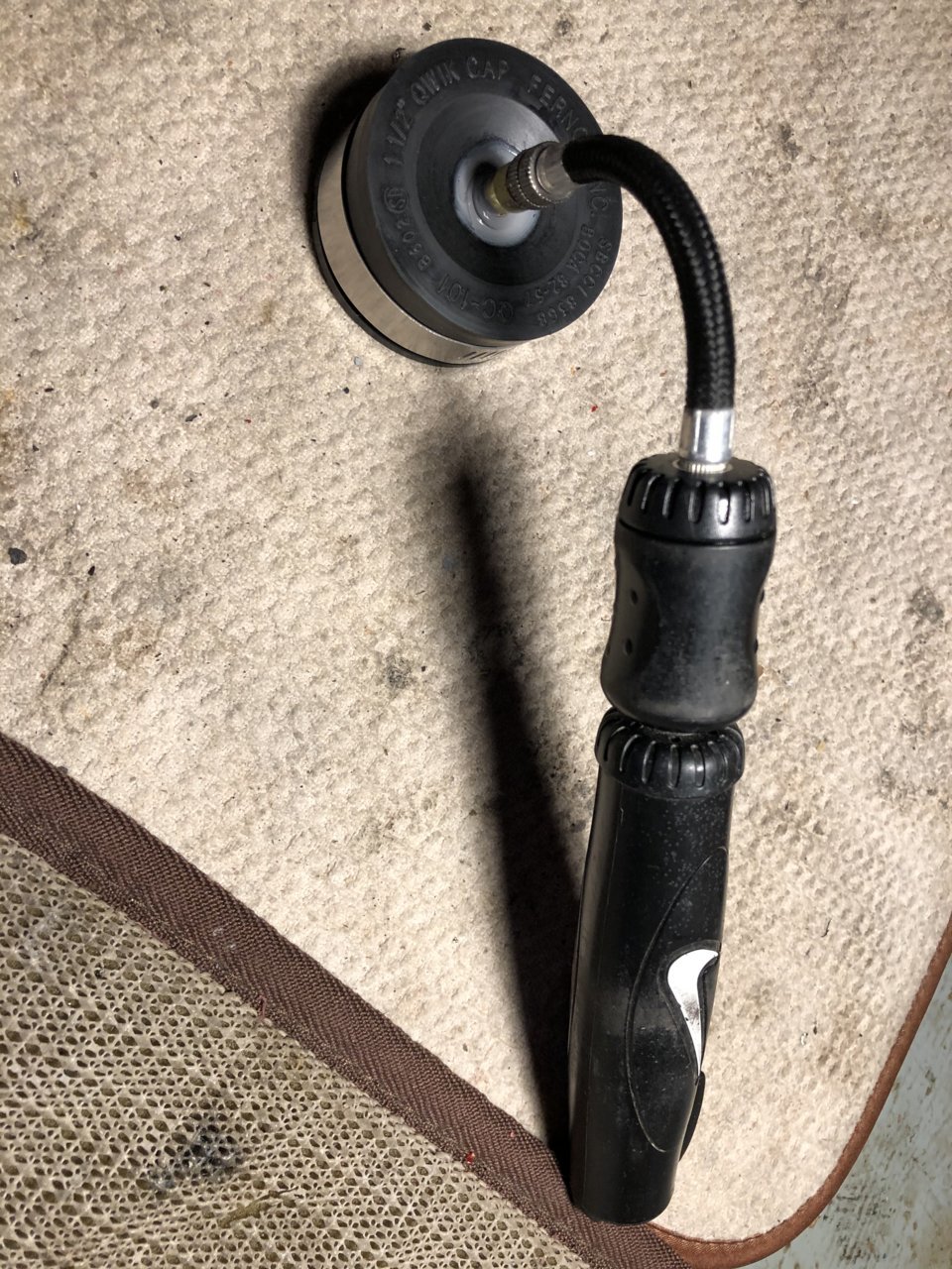

    Fabbed up a brake rez pressure cap out of a rubber plumbing cap I had laying around. Also had a v-ball/ b-ball little pump that accepts needles/various inserts. Tried a needle which works to pressurize by piercing through the top as my first proto-type. Switched over to what I think is going to be more substantial (see pictures). Total cost $4 for the needles/barbs and $2 for rubber cap.
    Tested the fit and it holds pressure with a few pumps on the brake rez, but didn’t over do it. Put some Fuze on it for extra measure after the pressure test. I like its modular size. Easy to work it.
    What is the next step to golden delicious clean DOT3 fluids running through my lines?
    Will this thing work? If it does I suppose a bicycle pump would work, as well.

    Cool. I like the bicycle pump idea. It isn't going to take a lot of pressure. Using an air hose to a compressor is begging for a clusterfdfk. Only thing missing is some kind of pressure gauge or indicator.
    Pump it up until you feel slight resistance then go open a bleeder (RR will work). Open the bleeder slow, with the wrench still in place until you see what to expect. Objective is to get a slow, controlled flow down a clear polyvinyl tube into your catch vessel.
    One disadvantage is only having the small MC reservoir as compression volume. Using the Motive bottle gives more compression volume (and a pressure gauge). Expect your pressure to go away quickly. Fluid forced out at the bleeder will be a fraction of the MC volume before it stops flowing. May take a few trips to the MC to get a wheel bled. Keep a sharp eye on the MC level.
