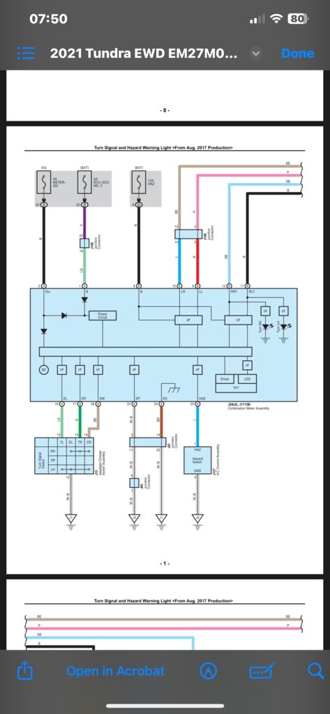

    Are there more than two fuse boxes in the 2017 tundras? I know the one in many engine and under the steering wheel, is there any other place there could be any others? I am looking for the fuses for the individual left in right blinkers.

    Only 2 fuse panels.
    1. engine bay
    2. Driver kick panel under dash
    what’s wrong with your blinkers?

    Nothing's wrong with them, I'm just looking for the individual fuses for the right and left blinkers. On all the diagrams that I can find it only shows one fuse. It's for an accessory.

    This could help.
