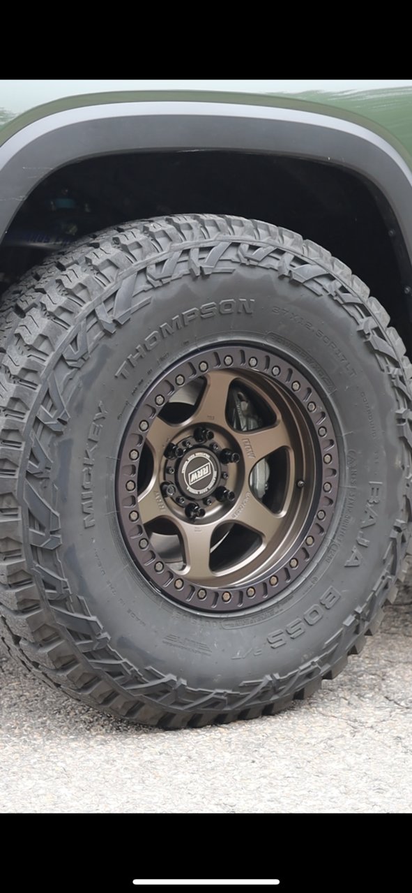

    Hi @montera.built, when you first jumped to 37s, any rub or interference? Looks like mostly stock truck at that point…

    Yep I needed to do a decent amount of fender liner trimming, some slight trimming on the actual insides of the fender and you'll need a body mount chop. Outside looking in, doesn't look like you need to do a lot but once you get in there and start cutting it's a good amount lol.
