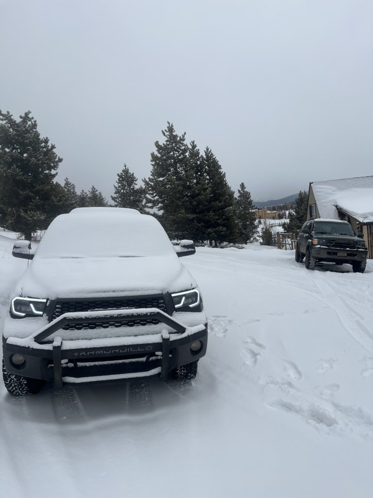

    Get a quality LED and you'll be happy. If you don't go oem these are the 2 brands I would be looking at.
    Morimoto is expensive but considered top notch. https://www.morimotohid.com/morimot...67Bu65XmLYataxjXkECTjwFtHwPvqugRoCdmQQAvD_BwE
    VLAND is a cheaper option, but only has a one year warranty. I bought Vlands for my 2012 on eBay and have had zero issues for over 2 years now. Light output is far superior to stock. https://www.vlandus.com/products/vl...pKTwi756sPQ9g86q8hC9i552tfM4OZ0BoCpU8QAvD_BwE

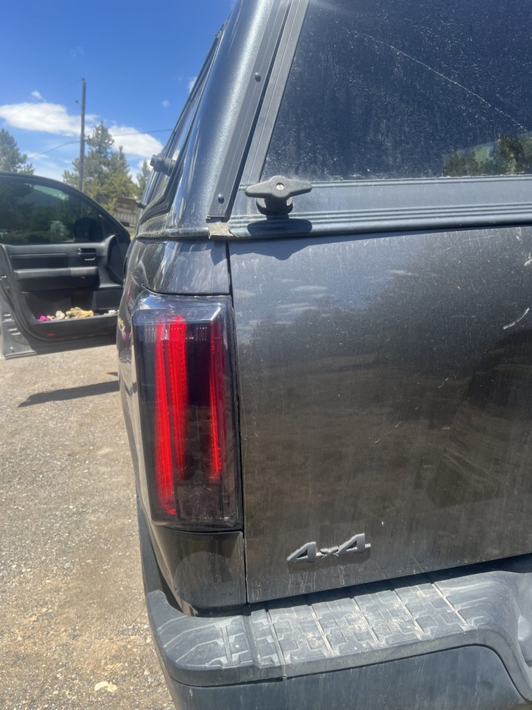

    DRL's are bright. I really like mine.
    edit: smoked tail in full daylight.IMG_0142.jpg

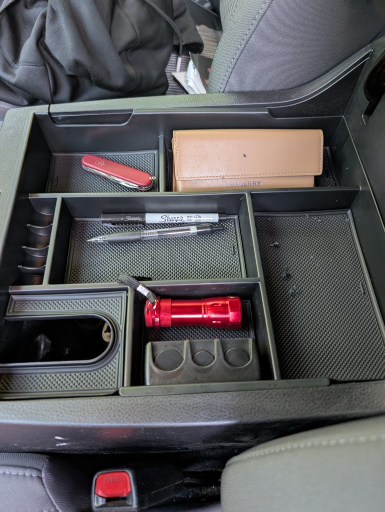

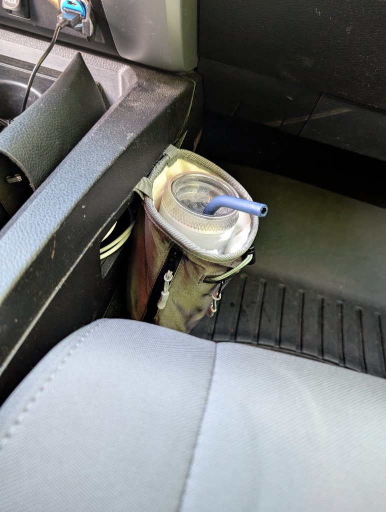

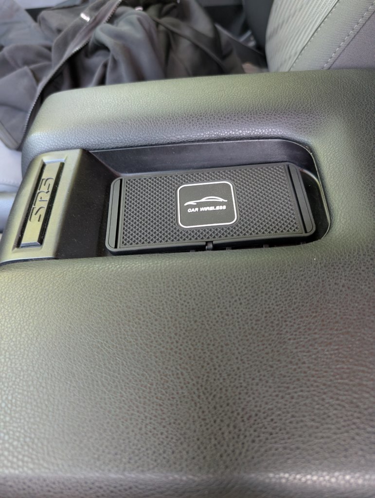

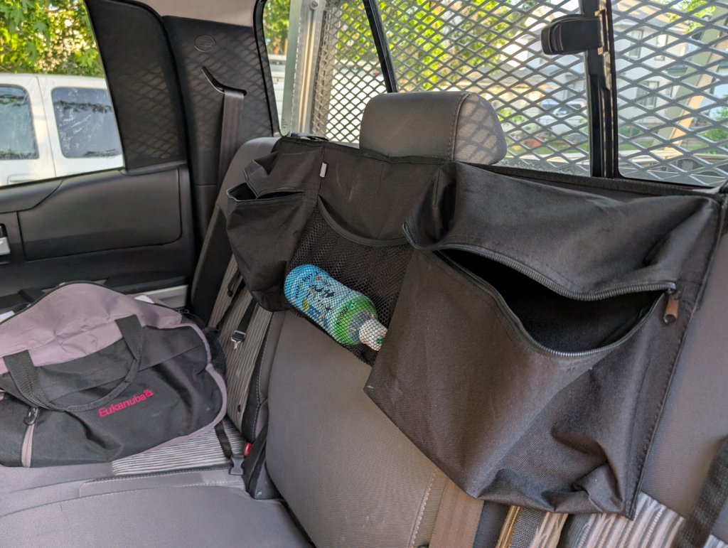

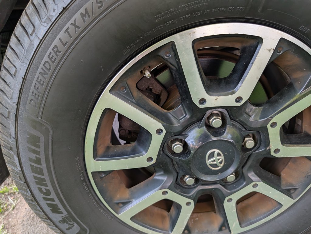

    So I've done some minor mods and bought a few items for my new to me '16 SR5 Off-Road.
    Phoenix 13” Android 13 Vertical Screen Nav Radio Sc7870.
    https://phoenixautomotiveinc.com/pr...oyota-tundra-2014-2021?variant=44260926849210
    Michelin LTX M/S2 P275/65R18 (4) plus spare
    Auto Window Switch
    https://www.amazon.com/dp/B0DT458615
    Wireless Phone Charger for Armrest
    https://www.amazon.com/dp/B0BTCW46GN

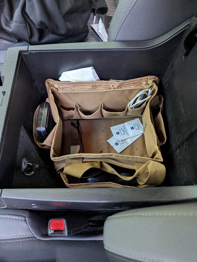

    Armrest Organizer
    https://www.amazon.com/dp/B09K3RJ66J
    Ditty Bag Console Cave Organizer
    https://www.amazon.com/dp/B0D66LMF6G
    Chalk Bag Mug Holder
    https://www.amazon.com/dp/B087NWZDNT

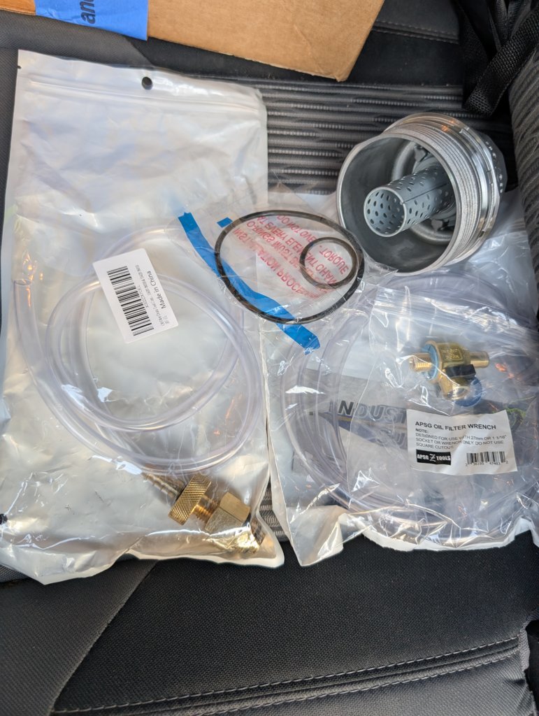

    Oil Change Quick Change Stuff
    Rear Seatback Storage Bag Thingy
    Running Boards ordered
    Removed steps from post #5 and gave 'em to techs installing new tires
    https://www.amazon.com/dp/B096FN41BK
    Washed and cleaned engine compartment Changed Air Filter and Cabin Air Filter
    Still thinking head and taillights
    Will do a paint correct, polish and wax soon.
    Coolant and transmission drain and fill soon.

    1st oil change today.
    Installed oil pan valve.
    Couldn't get the plastic oil filter housing off with reasonable force using breaker bar. Didn't want to break it so aluminum housing and filter will have to wait until next oil change when I'll get help.
    Oil change parts I bought included a filter wrench that is too short to engage the two "wing" so maybe I got shortchanged on that and will look for better one.
    The skid pan is a big pia if you ask me.
    I need measurements to cut out pan and add filter access door. ?

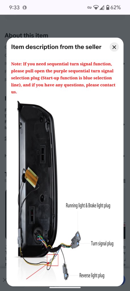

    Hello,
    I just installed the VLAND LED headlight & tail lights with sequential turn signals. Headlights work fine but sequential signal not working on tails, all the lights blink at same time.
    What did you do to get sequentials working?
    Thanks much
    After searching web forever I found an _ebay vendor who included a note regarding wiring change that I will try tomorrow.

    There are two small connectors as shown in the picture. If you disconnect the connector that has black to purple wires the signals will sequentially flash. If you disconnect the connector with the black and blue wire you can disable the start up animation.
