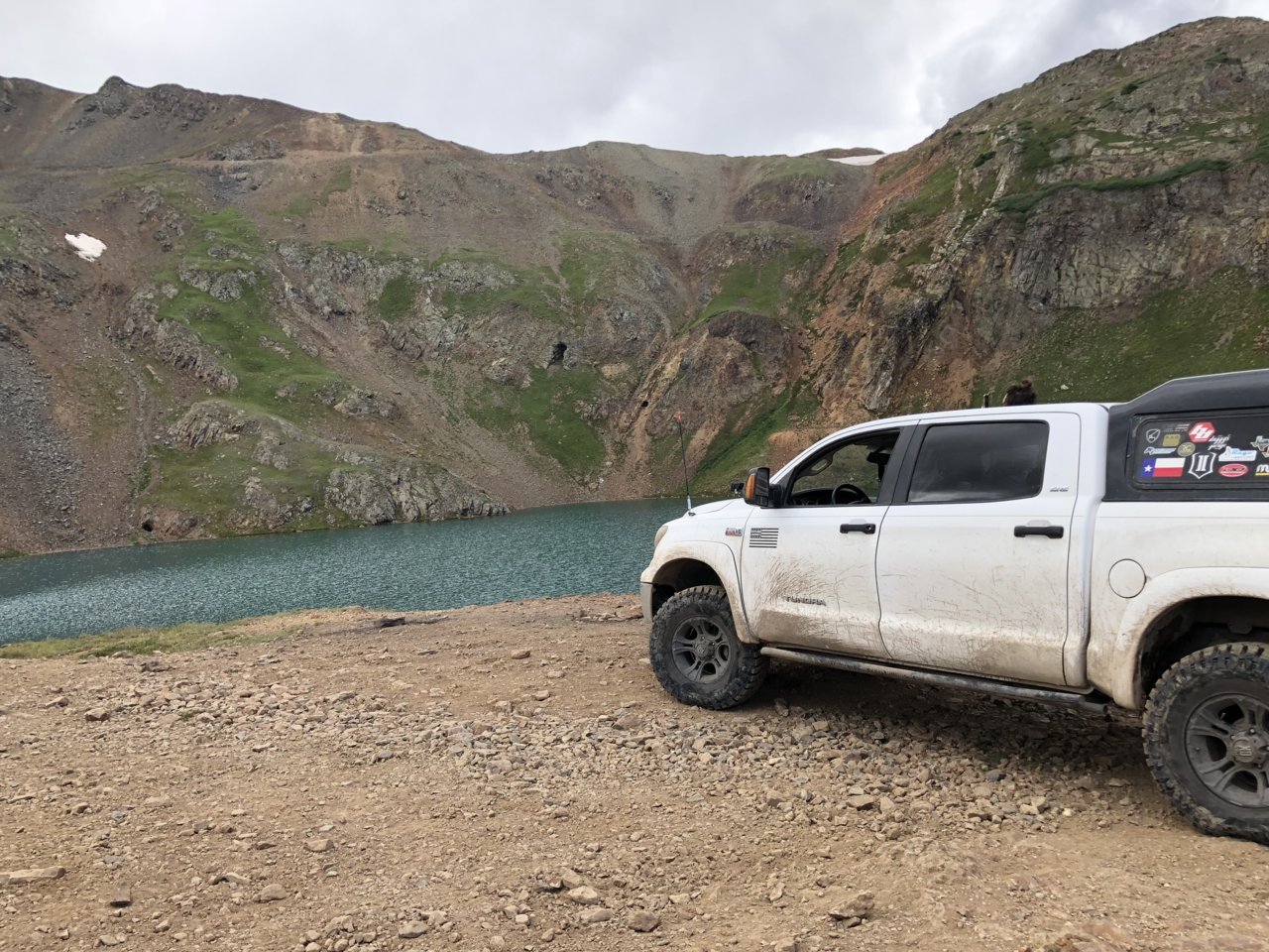

    4C8C5D39-6782-4634-89A5-E19197509D67.jpg 1EB0362B-2585-4AD9-BFB9-3E43BFB37710.jpg D9A7B1F2-DA53-4415-8A2D-4FDEF17EEAAC.jpg 77D9CC35-7579-4EF8-BD8E-A2814BA63F0B.jpg 93F95B9A-F334-4081-B831-86562F4A3490.jpg
    Moab and Colorado were awesome! Tackled Hell’s Revenge and Hell’s Gate which was a blast, Arches and Canyonlands National Parks were simply amazing and beautiful! I will be back one day soon! In Colorado we attended FJ Summit and were able to hit Imogene, Black Bear and Poughkeepsie Gulch including scaling the famous “wall”! Colorado was beautiful but PG was the only “challenging” trail, it was a blast. More pics and video on my Ig, r00ster_27
