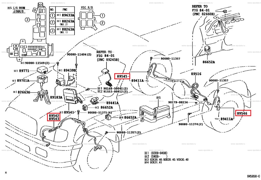

    My second question is are O-rings present on both the front and rear sensors? EPC only shows 0-rings for the rear sensors and a total of 2 per vehicle. Sometimes, small parts are missing on the parts diagrams for my 04 and wanted to make sure that is not the case here.

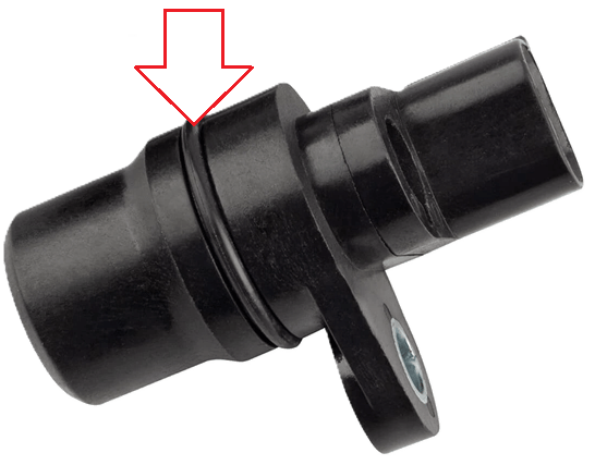

    The sensors come straight up and out. Sometimes it takes a little shimmy back and forth while lifting to get them out. That o-ring holds them in tight, pretty sure it's only one, pic below, you don't want it to look like the thread I'll link here.
    That said, it should just lift out. And a couple of things are important. One, that the sensor gets reinstalled squarely in the hole. Two, that the o-ring(s) are intact and in good shape. Three, that when you look down in the hole, the tone ring teeth are covering at least 50-60% of the view hole, so the tip of the sensor can "read" them (sometimes bearing replacements lead to the tone ring being over/under-pressed). Lastly, there's no garbage buildup on the magnetic tip of the sensor or the tone ring. One should ideally check these things any time the sensors are out, and note not to put the tip of the sensor into sand or dirt, where it can pick up tiny metal particles.
    This thread talks about the o-ring experiences @Hi06silver dealt with, with ABS pulsing on/off due to poorly centered installation, caused by an exhausted o-ring, he pictures in the 1st reply: https://www.tundras.com/threads/slow-speed-abs-activation-fixed.131442/
    While potentially not applicable to your 2004, in the '05+ trucks, the speedo gets its rotational information from the ABS sensors, I believe from the rear sensor(s), not sure if a specific one or both - I think @des2mtn knows that one, EPC shows both rears as 'speed sensor' so possibly both. Here's where the o-ring is located on the rears, since I'm not seeing that in hi06's thread. I assume the fronts have similar, but their wiring is much longer and integrated to the sensor, All four sensors use different part numbers for my '06.

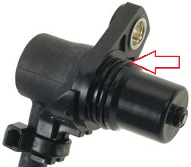

    Not sure if it helps, but here's the diagram for my '06 AC. I'm boxing the part index number (which is also the first 5 digits of the part number). Clearly you can see they offer an o-ring for the rears, but not the fronts. The front sensor *DOES* have an o-ring though, as shown below. Also worth noting, the front sensors have a pointed tip, the rears have two bars in the shape of an equals == sign on a snub tip.
