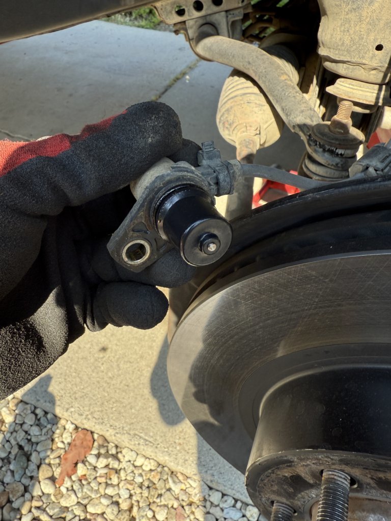

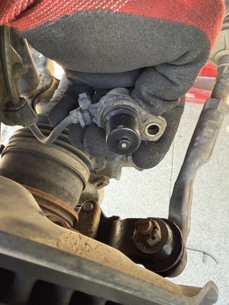

    Ok I finally got around to checking the ABS sensor on both front sides. Looked clean to me but I wiped them off anyway. I attached photos just in case anyone wanted to see.
    I did notice that when I rotated the rotor on the drivers side by the lug bolts, it would get noticeably more difficult on one part vs. another. So I’m hoping this is the problem and I will be able to exchange my DuraCrap rotors this weekend for new ones that hopefully aren’t problematic. Will keep the thread updated.

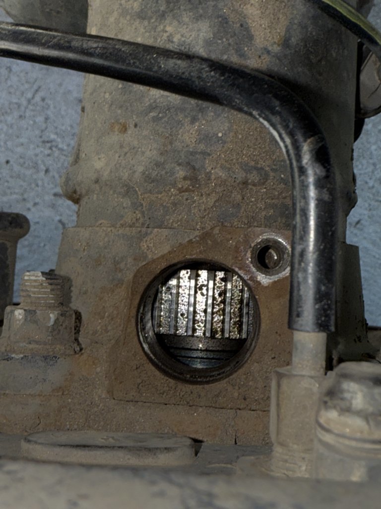

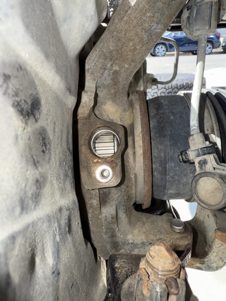

    OK I’ve checked out the ABS tone ring and based on the threads I’ve looked at they look ok. But someone can correct me if I’m wrong.

    Looks great

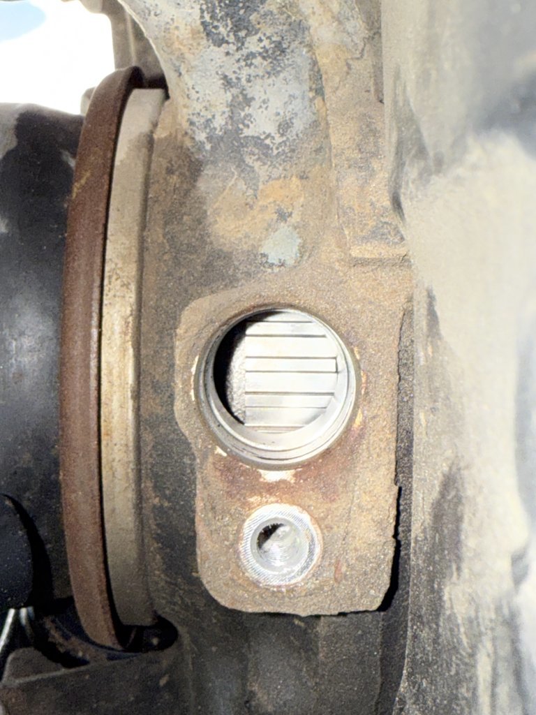

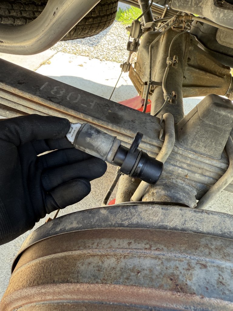

    I just inspected the rear sensors, and the looked clean but when I looked at the tone ring on passenger rear I found this.
    Very dirty, plus the sensor looks replaced. Maybe it’s a cheap knockoff and it’s gone bad. I’m going to replace the rotors under warranty and see if that’s what the issue is after all. Then I will potentially resort to replacing this sensor and/or cleaning the rear tone ring

    Both alignments look great. Agree, there is a lot of shit in that rear one.

    Looks like that rear is wet - perhaps has a leaking seal.

    BTW I looked at the rear tone ring window again on a larger screen and that’s not dirt or debris, it’s apparently just some tarnish on the tops of the fins.
    And yeah. We always warn folks about aftermarket drums and rotors. This happens absurdly often. Hence the first words I wrote in this post: “Whatever you do, don't buy aftermarket rotors. Trust on this. Never buy aftermarket drums or rotors on these trucks. "We've seen some shit..."”

    I was able to wipe that stuff off with a Q tip so I don’t think it’s tarnishing… but it doesn’t seem to be causing the issue so I’m not gonna worry about it
