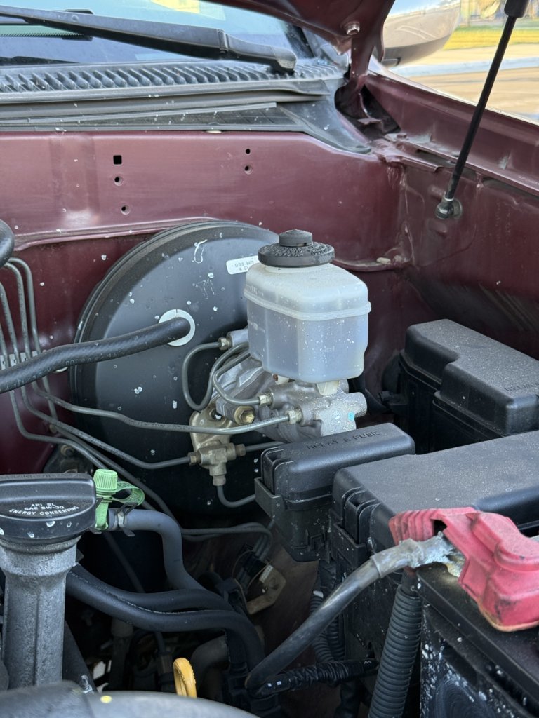

    Never bled the brakes. I will attach a photo of my master cylinder. No lights when it happening, but I do have a TPSM light (assuming unrelated but thought id mention anyway). No weird wear on the rotors so far but they’re brand new. The previous rotors were warped and the pads were unevenly worn (one pad was more worn than the other). I will check caliper bolts, but I’m assuming they’re tight because I just did the breaks. Never took out the ABS sensors and I’m not sure how to do that or how to clean them. I will try pulling my ABS relays but I think I have to take the relay box out and remove screws before I can remove them. It’s only one relay correct? In the engine bay?

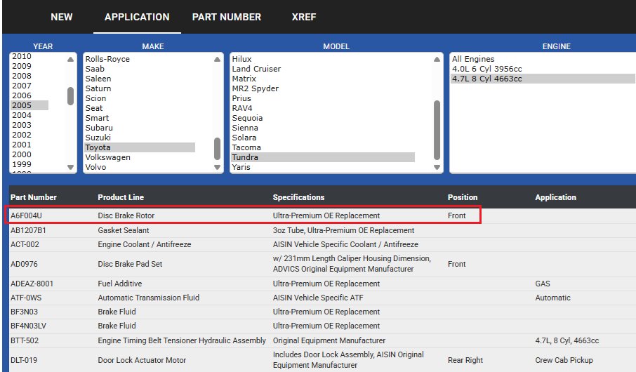

    Actually, if you pull the existing ones, carry them into the store, and tell them they're warped and vibrating like hell straight outta the box, you may be able to get them to replace. You may get lucky with the 2nd pair.
    If not, and they'll let you purchase another brand, you can see if they have Advics brand rotors. Advics is the OE for Toyota. Here's your part number:
    Note that some chain stores are equipped with the tools to measure drums and rotors to ensure they're in-spec. Hell, back in the day, auto parts stores would actually turn the damn things for you.

    here’s a photo of my master cylinder. Not sure what exactly I’m looking for. I have an LSD oil only sucker on my diff, but on Toyotas website my truck isn’t listed as having an LSD

    Man, knowing how many issues these trucks have with corrosion getting inside the battery cables, weaking all kinds of electrical havoc, melting wires, popping fuses, I'm really disappointed at the amount of corrosion I'm seeing all over your positive terminal, and the lack of washer and dielectric grease on the terminal post...
    Do better, brother! https://www.tundras.com/threads/1st-gen-psa-clean-your-battery-terminals-you-lazy-sods.131635/
    PS - if you have VSC, there will be an "AUTO LSD" button in the dash to the left of the 4HI/4LO buttons. But looking at your booster/MC combo, it would appear to me you don't have it.

    Good. Now we know it's not one of the freaks. I'm with shifty on this now. Check for warped rotors.
