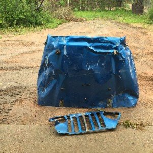

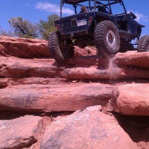

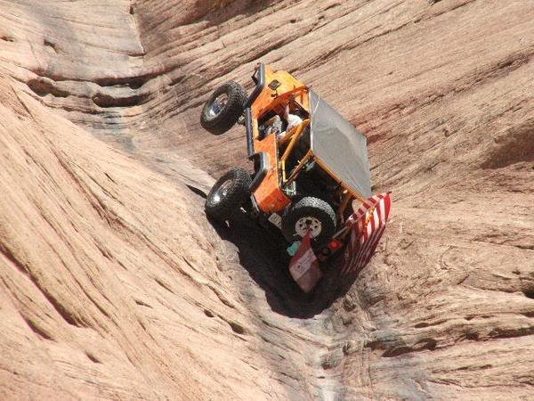

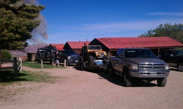

    So I don't want to totally bash Moab. I used to go 5-8 times per year for at least 7 years in a row. We had a lot of great times...
    748BA968-9F10-4046-954B-9EDF846451BB_zpswgonqi5c.jpg 5AB8B993-7D25-4F5E-A39F-737E7D24C404.jpg
    40775-d215a612def5ad959233d905cfc05953.jpg 40776-0f493eb40b81f58a7c623a98d2e321c8.jpg
