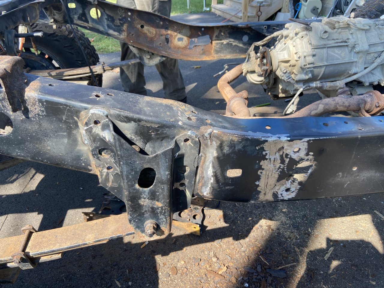

    Figured we’d swap the motor mounts to the inside of the frame and now we have to fix the frame I thought was much better than it was. Here’s to two hours of grinding rivets!

    So I got a little more done today and am happy with my weekends progress. Please don’t critique my welds too bad since it’s the first time I’ve used a welder since I was in college 10 years ago :oops::oops::oops:
    frame is patched and reinforced with 3/8 plate top and bottom since I removed the rotten inner structure. I figured if it worked for GM it SHOULD work for me. I plan to add some sort of something inside the frame again.
    Of course I plan to go back and actually finish welds and make them look pretty but I didn’t want everything to rust overnight since I live in new York, blue rattle can works for now.
    The rear “cab mounts” were 3” outside the rockers (yeah I actually measured three times) so next weekend I’ll move the fronts to the inside of the frame to match the rear. This makes it easier to make a floor pan down the road.
    keep in mind I have 0 math ability and usually measure once cut twice throw it away and try again :cool:
