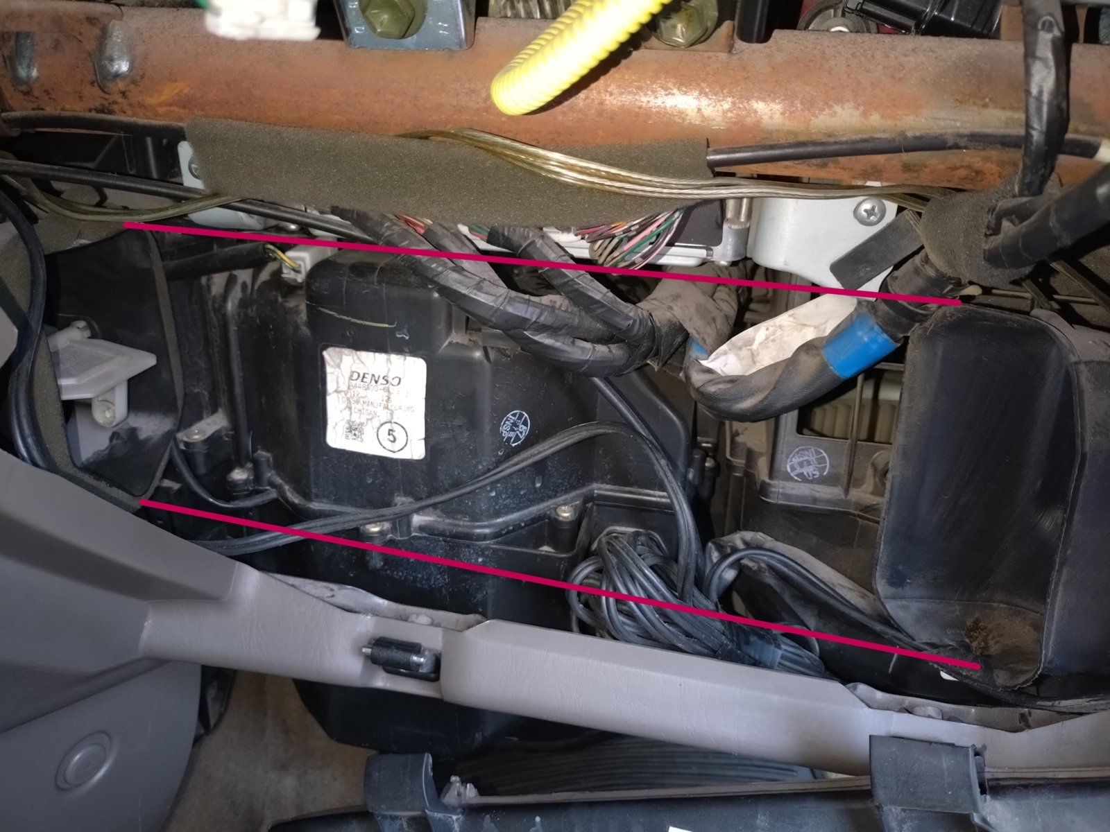

    Good evening, first time poster here. I recently purchased a 2006 crew cab and was riding in the passenger seat for the first time and noticed that there was no air coming out of the passenger side vent (furthest right vent). I pulled the glove box down and it looks like the crossover duct that delivers air from the console to the side vent is missing (see pink line in picture for reference).
    Generally, I am pretty good with finding part numbers, but I am having the hardest time making sense of Toyota's part diagrams (or lack thereof) for the duct system.
    Does any know the part number for this missing duct? Or could I ask a kind soul to check for the part number off of their duct. A million thanks in advance.

    Is that the upper and lower evaporator case? I was looking through the HVAC diagrams too....I feel your pain in this one.....

    easy find at the junk yard. Should be about $10 part.

    The issue is that I live in Costa Rica. There aren't many of these trucks down here; especially not in junk yards. I am hoping to find the part number so I can order one up.

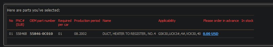

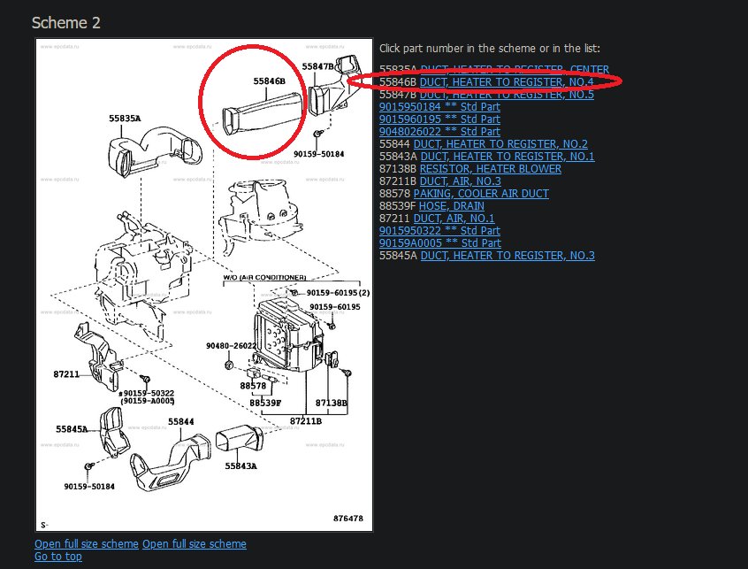

    Tonto cover
    seraphfire[OP] and Mater like this.

    Amazing, thanks very much. I have used the epic data site for a Mitsubishi Pajero I had and it was very helpful. Didn't even think to look for Toyota. Great idea.
    Thanks again for the help.
