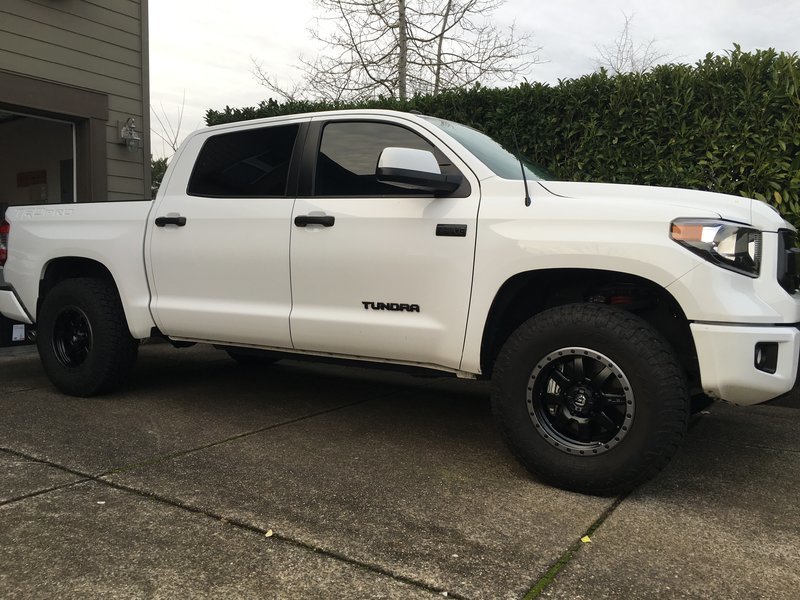

    I have Toyo A/T II's 285/75's on my 15 Pro, and they have no issues at all . Some light trimming of the front plastic and removal of the front mud flaps, and they ride and look legit!
    Right now I'm replacing the TRD black wheels that came on the pro, for some Fuel Trophy's at 18x9.5 and the offset is going to look great. That said, even more trimming of the plastic is going to be necessary!
    I'll post a couple pics as soon as it's done..

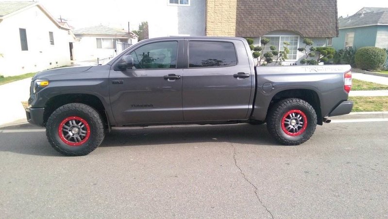

    TRD Rock Warrior 17" Wheels, BFG Tires 315/70/17 KO2's, 1.25" front spacers, TRD Intake, N-Fab BAJA Pro Bumper, Hella Lights, LED fog bulbs
    2016 TRD Pro, 315/70R17's on TRD Rock Warriors, 1.25" spacers in the front, front bumper plastics removal, light front bumper trimming (didn't have to but did), mud flap removal, no cab mount modification. These are the same dia. as the 295/70R18's a lot of Pro owners are running, but about an inch wider.

    Looks real good. Not to thread jack, but what mud flaps are you running? They don't look stock.

    A company called Rally Armour. They are Rally Car type, so I bought the generics and modified them to fit

    Here is mine completed yesterday. This is stock suspension... CB shims to be added soon I hope! 285/75R/18 Toyo AT II's
