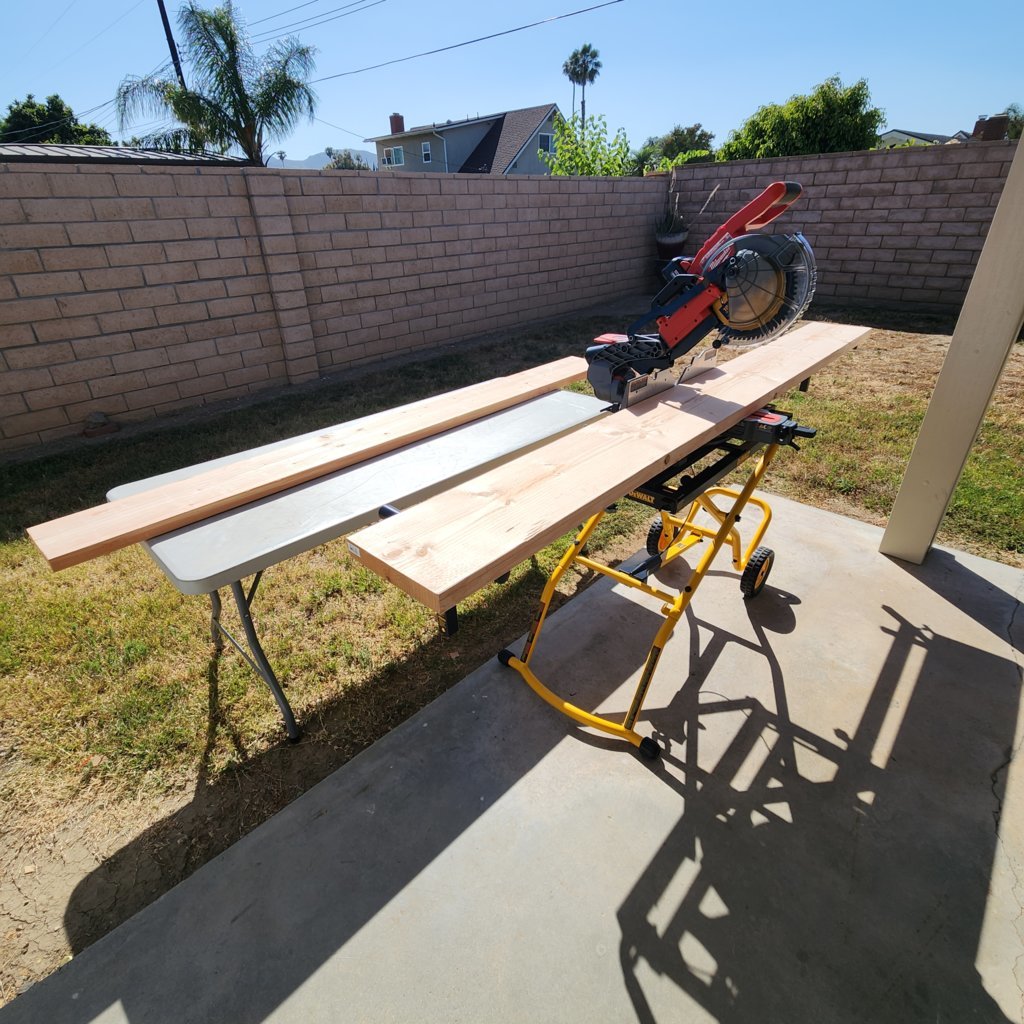

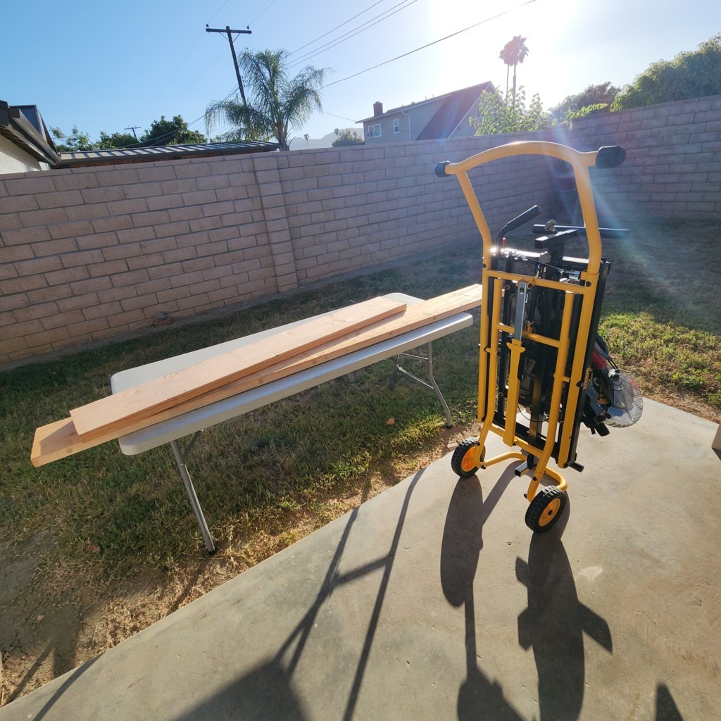

    Yeah, definitely not for the paneling but it's a great tool to have.
    What do you mean? When I bought the saw I was comparing several other stands and settled on the DeWalt for its portability and ease of setting up. I'm able to easily load/unload from my truck.i believe Bosch has a similar one that someone on here recommended. That was a close 2nd.

    I’ve watched a lot of reviews on mitre saw stands recently (in the market for one myself) and YouTube university tends to agree with you on that one being top dog

    That stand is hard to beat for folding/traveling stands
