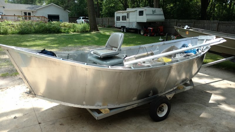

    This one?[​IMG]
    Albertaundra[QUOTED] likes this.

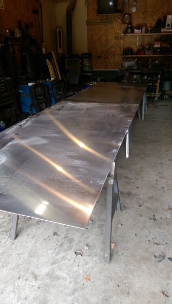

    Which looks like this now...mostly.[​IMG]
    JMB and Albertaundra like this.
