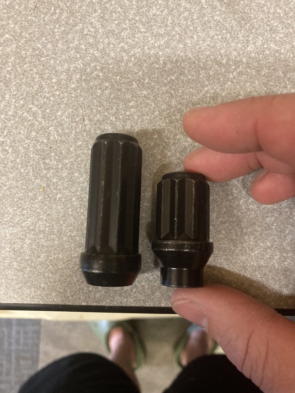

    The guy at Discount this morning told me the store that installed the KO2's (another discount tire) put on the wrong lug nuts for those Methods, and that could be it. So who the hell knows. They're putting on the "correct" lugs and swapping the KO2's for Nitto Terra Grappler. :notsure:

    Thought that might be it. The guys at Sam’s club did anyway. I ordered ex lugs from method the same time as the rims. Method had me text them a pic of the lugs and said I did indeed get the right ones.
    The guys at Sam’s club said they thought the extended lug wall was thin for a lug nut.

    Yeah they said the new lugs have a longer shank that helps the wheel center on the studs. Here's the new ones on the right.
