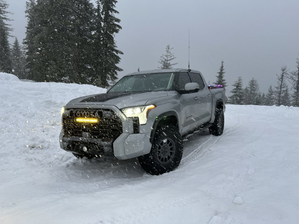

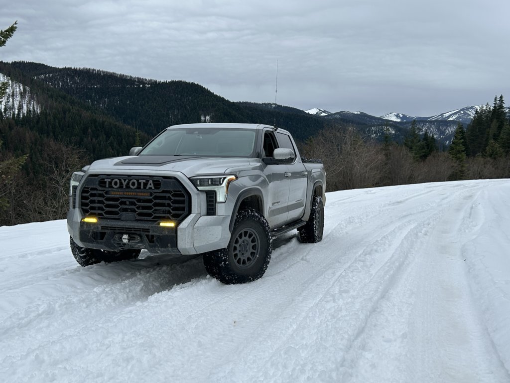

    Mine are titanium 703 17x8.5 +35 wrapped in 37” Toyo R/T Trails
    The bead grip tech is awesome, just ran a snow run at 8psi and they were great

    Any issues with rubbing and/or BMC chop required with the 25 or 35 offset 17” wheels and 35” tires?

    With 35s not for me. When I went to 37’s I trimmed back the tire diversion nub thing, I took off half of them. I didn’t need a BMC chop.

    Good question, I think the less positive off set would help more. +25 has more poke than +35.
    I don’t know what the tire diversion block thing is called, rather I’m just describing what it does.
    It’s pictured in this post and you can see I painted it black to keep rust out

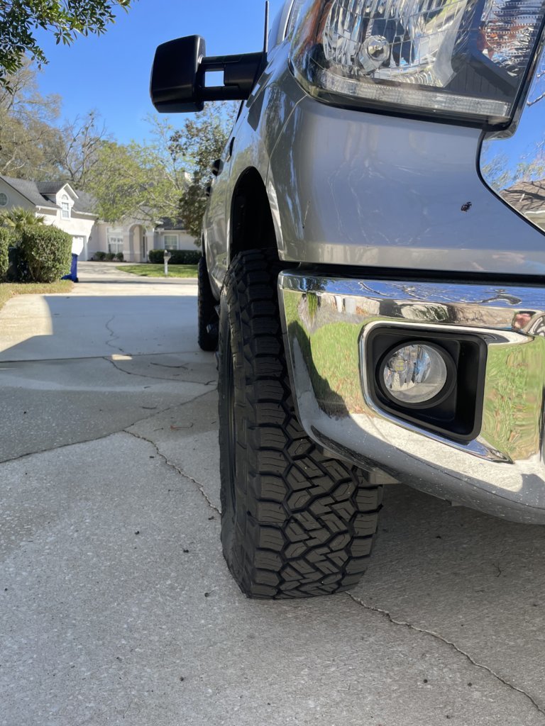

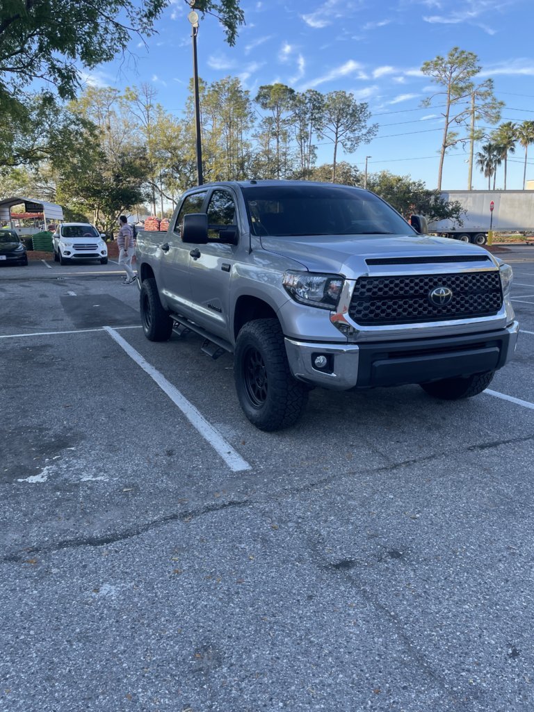

    Here are the 703 in 17” with a 0 offset. Needed a BCM and bumper shims. I have it lifted as little as possible to clear from any rubbing.

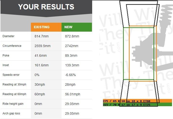

    Good looking trucks. I am looking at the 316's in Ti for my 2020 platinum. I am going with the 6112/5160 and planning to use JBA UCA's.
    If I get the 316's in 18X9 +18 offset can I expect any issues with the UCA's???
    Anyone have this set up?

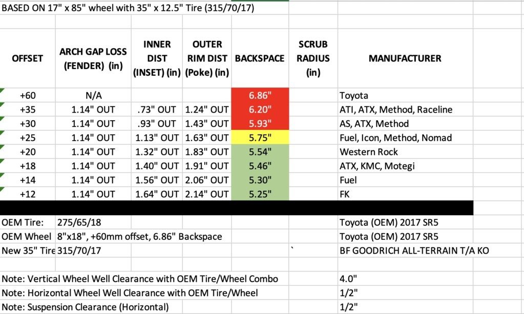

    Not the exact setup, but this information may be helpful as the backspace requirements are agnostic.
    I've been working toward something similar, so this may help. +25mm offset seems to be the ideal for our truck (from what I've read and spoken to folks about) - no direct experience - not a mechanic.
    +18 will help with space for the suspension (reservoir) components, if you have one/them, but you may migrate into other issues.
    It sounds like all trucks are different, but the +18 recommendation from Fox/King was paired with a BMC or relocation requirement up front (or at least awareness it may need to be done).
    Total Chaos, MCM, Camburg, JBA arms help restore/keep the correct geometry with big tires. https://www.tundras.com/threads/gen...stener-first-time-caller.152823/#post-3808845
    • Offset
      • 2017 SR5 Alloy Wheel OEM: +60mm
      • Manufacturer Recommendations (8.5x17 wheel with 315/70/17 tire)
        • Camburg:
          • +25mm to +30mm
          • +25mm
        • Dirty Deeds:
          • +25mm
        • Fox:
          • +12mm to +18mm
          • +18mm ideal
        • Icon:
          • +25mm
        • JBA
          • +25mm to +30mm
        • King:
          • +12mm to +18mm
          • +18mm ideal
        • Method:
          • +25mm
        • Total Chaos:
          • +20mm to +35mm
          • +35mm ideal

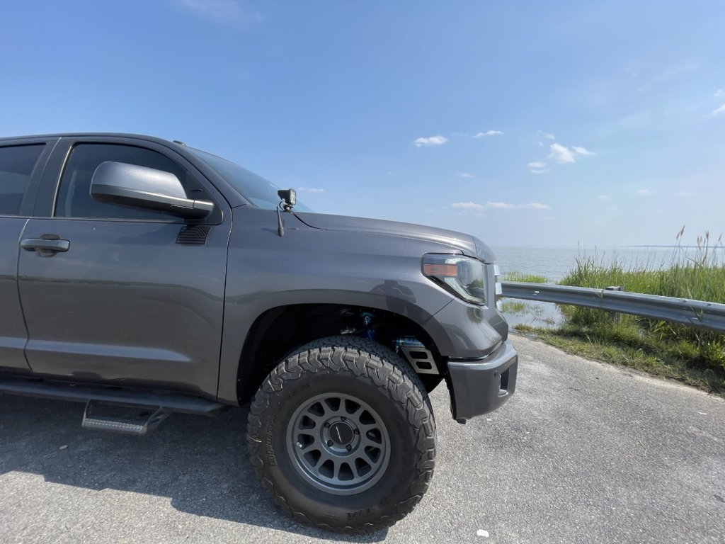

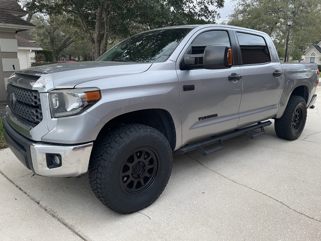

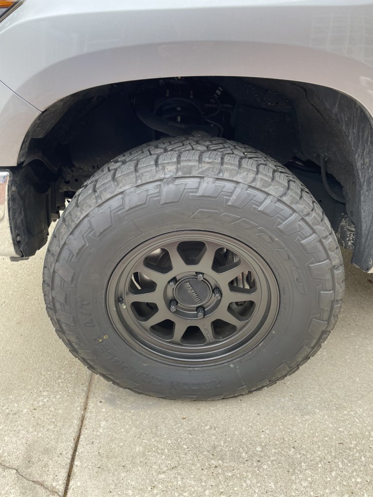

    Just had my 316 mounted and love them/ the new look.
    below is my setup:
    ◦ Bilstein 6112/5160
    Coach builder +2 -1.25” shackle
    ◦ 295/70/18 nitto recon
    ◦ Method 316 18+ offset
    the tires rub just barely when going in reverse on the front bumper liner. This is after installing Bumper shims to shim the bumper out .5”. I plan to just use a heat gun on the liner.
    ShinyConcretE and SAGE63 like this.

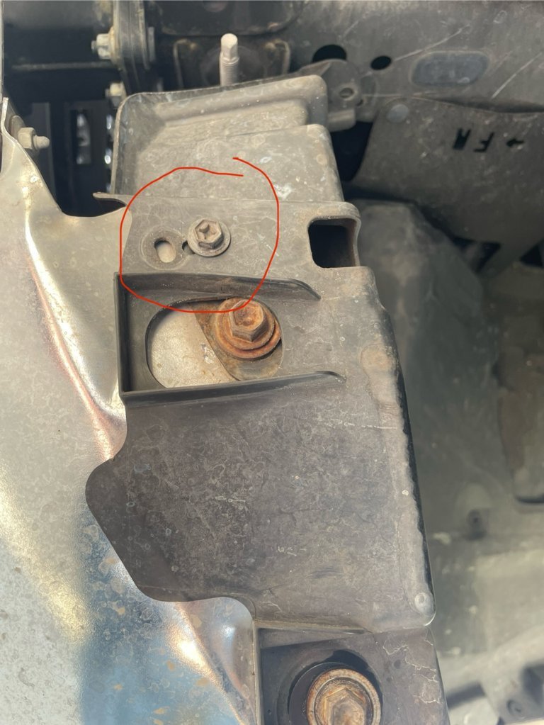

  18. Mar 20, 2025 at 12:35 PM
    #108
    toyota tom
    toyota tom New Member
    Oct 20, 2019
    #37583
    50
    Jacksonville, FL
    2019 SR5 4x4 CM
    ESP underseat storage Shorter 6” antenna Bilstein 6112 @ 2.5, 6150, +2 CB shackle 275/60/20 ridge grapplers
    Alright no rub anymore. Vs using a heat gun I just unscrewed the wheel well, pushed in the liner and then drilled new holes. Gained another 1”+.
    all good now!

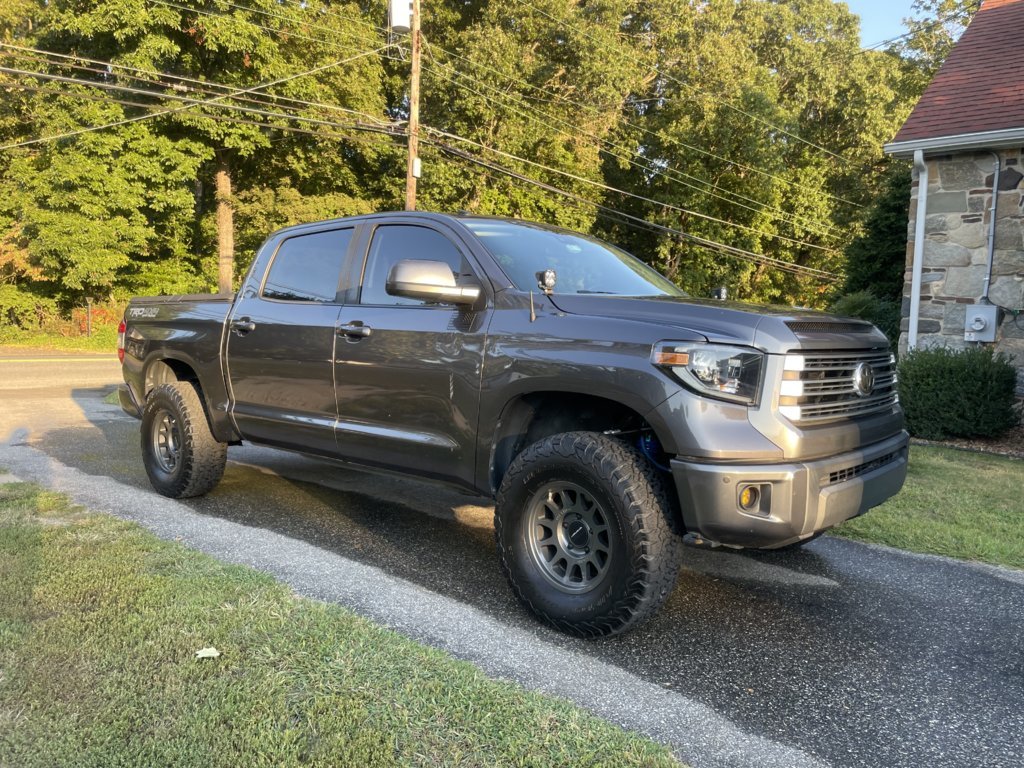

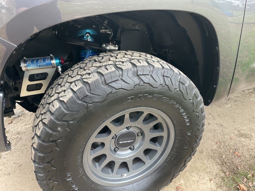

    Yeah, you'll be fine. I posted a photo earlier in this thread to show that there's plenty of clearance for a 12.5 tire. You could also reference the guys using Rock Warrior Wheels (+50 offset) with a 12.5 tire without UCA interference.
