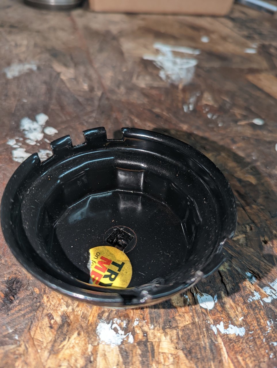

    Here is my tool, it has the loose hex pattern as well as notches for the raised fins on the housing. It's not as nice as some of those aluminum ones, but it shouldnt have problem with 20ft lbs.
    Peek a boo
