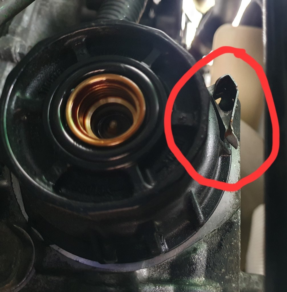

    I changed my oil the other day so I thought I'd take a photo of the metal tab that I was referring to, you turn the filter until the plastic tab on the housing is past metal tab and you know it's on.

    Enjoy your plastic. There have only been a few dozen on here documented broken.

    User error. In my career with Toyota and doing thousand of oil changes I’ve only seen a couple fail because the previous a$$ hat over tightened it. On the real tight ones I would use my impact on them to remove and they would still be OK. Snug it down with a 3/8 ratchet and you will never have a problem but some decide tighter is better.

    Welcome to the new world. Plastics have come a long way. Follow the correct service procedure and you will never have an issue.

    LOL Where can you find the correct service procedure? In some random posts by some random people on a random web forum?
    Oh I know. In the service manual. The correct service procedure, as developed by Toyota, gives specific torque values for the drain plug and filter canister.

    The dealer sure as hell doesn't use a torque wrench. Did my own oil change this weekend and that sucker was far beyond Toyota specs. Nice and slow with breaker bar since ratchet wasn't cutting it.

    How about use some common sense and don’t over tighten it. Yes there is a spec in the service manual and seasoned techs don’t use a torque wrench when tightening because after you have done a thousand of them you know exactly how tight it needs to be. The problem arises because a shade tree tech or a dumb ass lube rack guy figures tight as fuk should work.

    If u tighten the plastic housing to spec u wouldnt have an issue

    LOL Many people don't agree. I do i did 30 oil changes on a prius with plastic housing 0 issues, and now 20 on plastic tundra housing 0 issues. But some guys just think metal tough. Maybe i should make metal valve cover gaskets, and metal headlights, and metal seats. I could make a killing. Metal steering wheels, this list could go on and on. Chains for seat belts...
