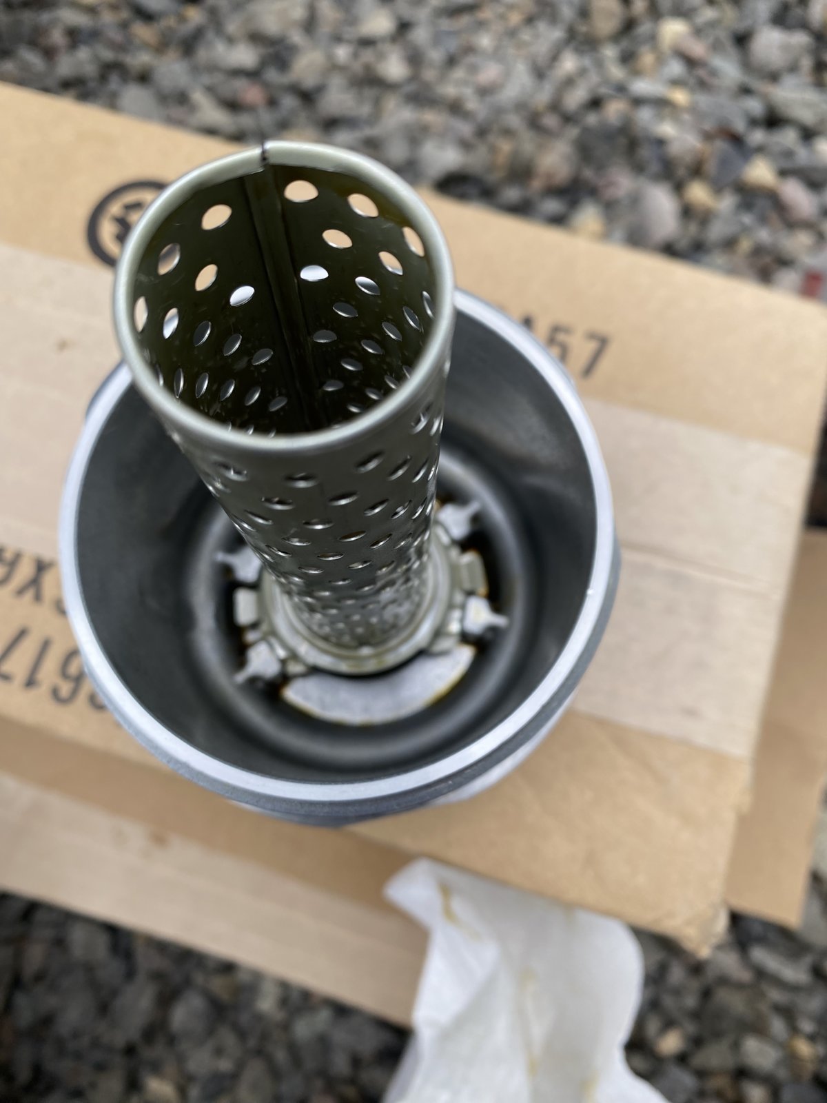

    Tube freshly removed and wiped clean:
    After close inspection, my tabs may be slightly bent, but it wasn’t intentional. And if they are, it ain’t much!
    Tube reassembled with aluminum canister:
    Let’s see if a video works, I did this one-handed while holding my phone:
    Nope. No video. Can’t load.
    Feel free to Pm me your digits and I’ll text it to you.

    No need to bend tabs. Use a trim tool to gently apply pressure to the tube without permanently deforming it and it pops right out.

    What are you manipulating with the trim tool? For comparison, I was able to remove and replace my tube in an 8 second video.
    With one hand.

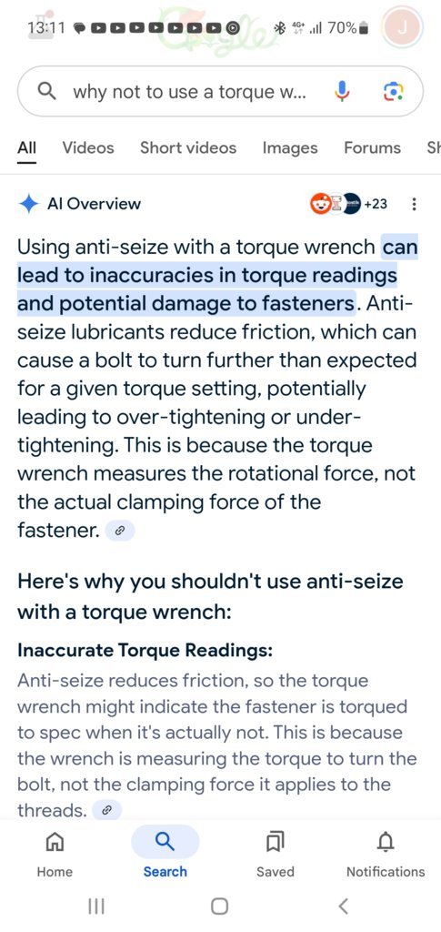

  27. May 11, 2025 at 10:12 AM
    #87
    Joe333x
    Joe333x Member
    Apr 4, 2019
    #28632
    1,924
    Boston
    2019 Tundra CrewMax Platinum

    "...potentially leading to over-tightening or under-tightening." LOL AI
    Please post something from a manufacturer, that explains why you should never use a torque wrench to tighten the canister, drain bolt etc...
    Or explain why every manufacturer lists a torque value for these.
    Or quantify what the torque difference is between a lubed bolt and one that is not.
