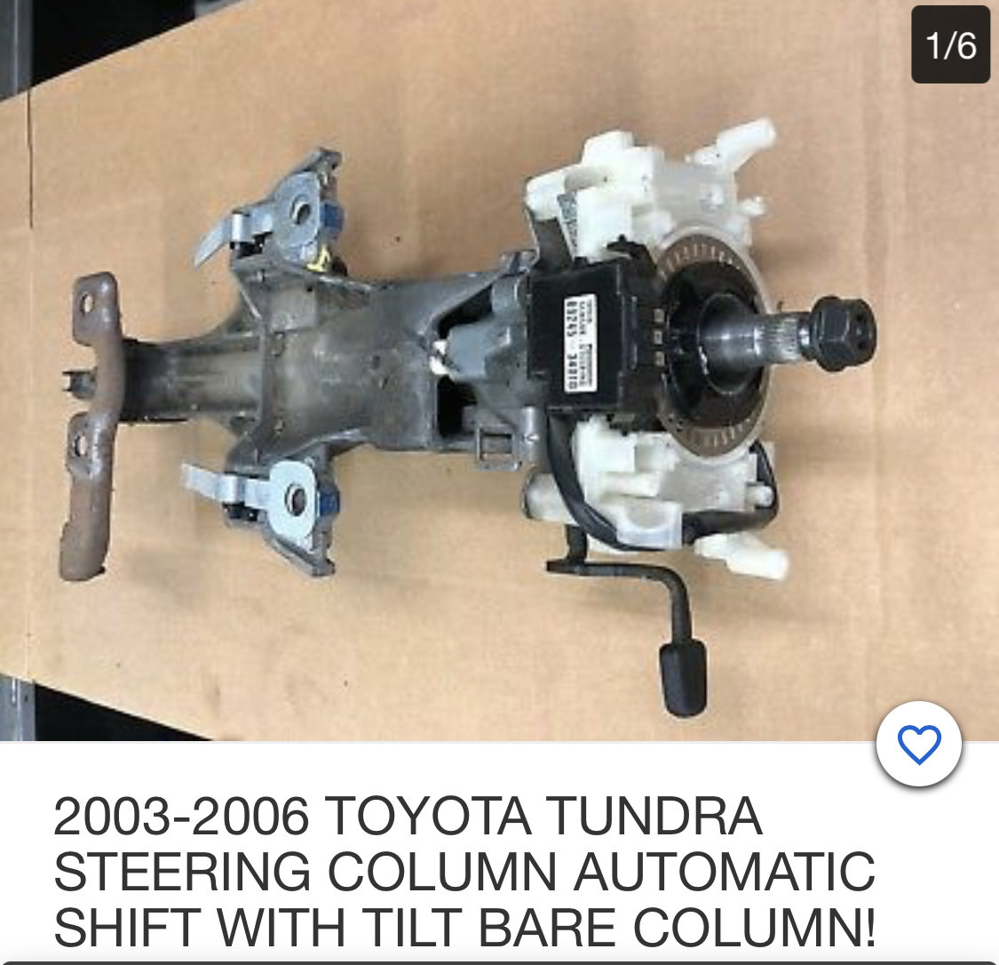

    Thanks. Think I’m going take my time and not rush this. I’m not really sure what the entire column looks like to go pick one up from a junkyard around here. Found this on EBay, is this what I need?...
    https://www.ebay.com/itm/153334462361

    Question, if I find the whole column that has its key, why would I need to swap out the key cylinder?
    I have next to no knowledge about this kinda stuff.
    Thanks

    Maybe so you maintain the original key (one key only) for doors/gas etc.
    You’ll have two keys if you keep the cylinder on the new. Just a guess.

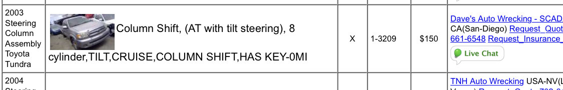

    That site is awesome! Think I found the right part with the key for $150.
    https://www.car-part.com/cgi-bin/search.cgi
    It’s about 2 hrs away. Not too bad

    Called the junkyard and they said the unit they have doesn’t have tilt. If me has the tilt, would I be able to transfer it onto the “new” one? Or best to get it all in 1 assembly?
    thanks
